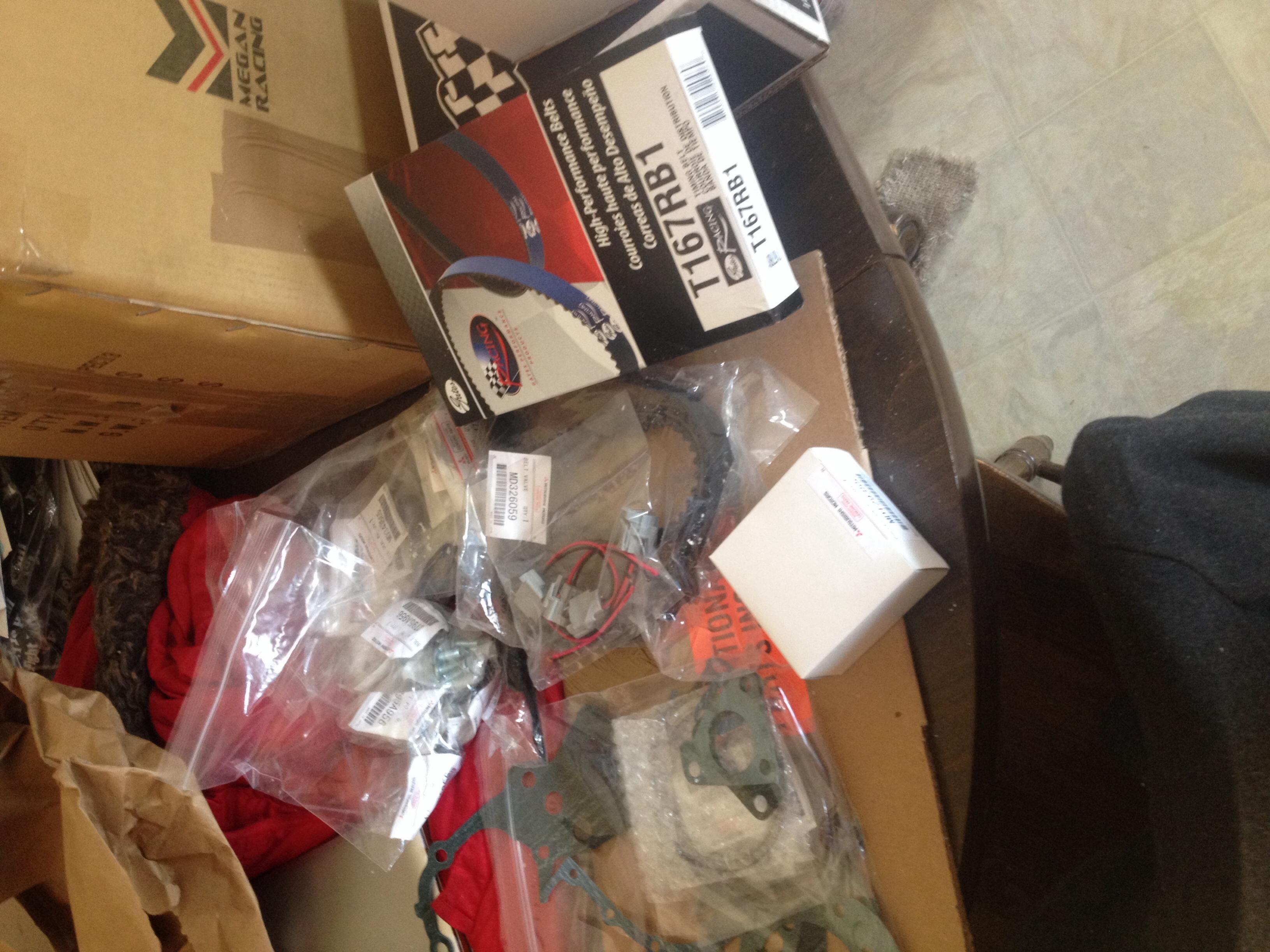

Mucho parts delivery for my red rocket. Kiggly crank trigger, fluidampr harmonic poop slinger, gates rubber band, competition twin disk, and a bunch of bolts and gaskets u could forget about until you pay for them. So far I'm ready to prime the oil pump and then time the motor, than maybe fab up a timing cover and make sure I have a starter plate that will work. Who knows maybe the weather will cooperate and I'll get to drive it this year. Still undecided on what to do about the turbo. Keep the 3582 the way it is this year or upgrade to a 3586. Hmmmmmm does size matter this year???

Old 04-04-2014   #105
Re: team ab drag race and street builds
Nice!
Keep the turbo, just be a waste of time and/or money at this point.
You might run the 3582 and want to go straight to a 3794 or something, size might matter if you feel insecure? lol

dsmdolney thanks for the info, andre actually sent out his manifold back to force to have john try and fix it, so if the extra room is needed maybe that style hood is the answer.

Haha yes people forget about the expense of gaskets, dowel pins, and bolts, it's the worst too because they add up fast and they are all boring parts to look at
