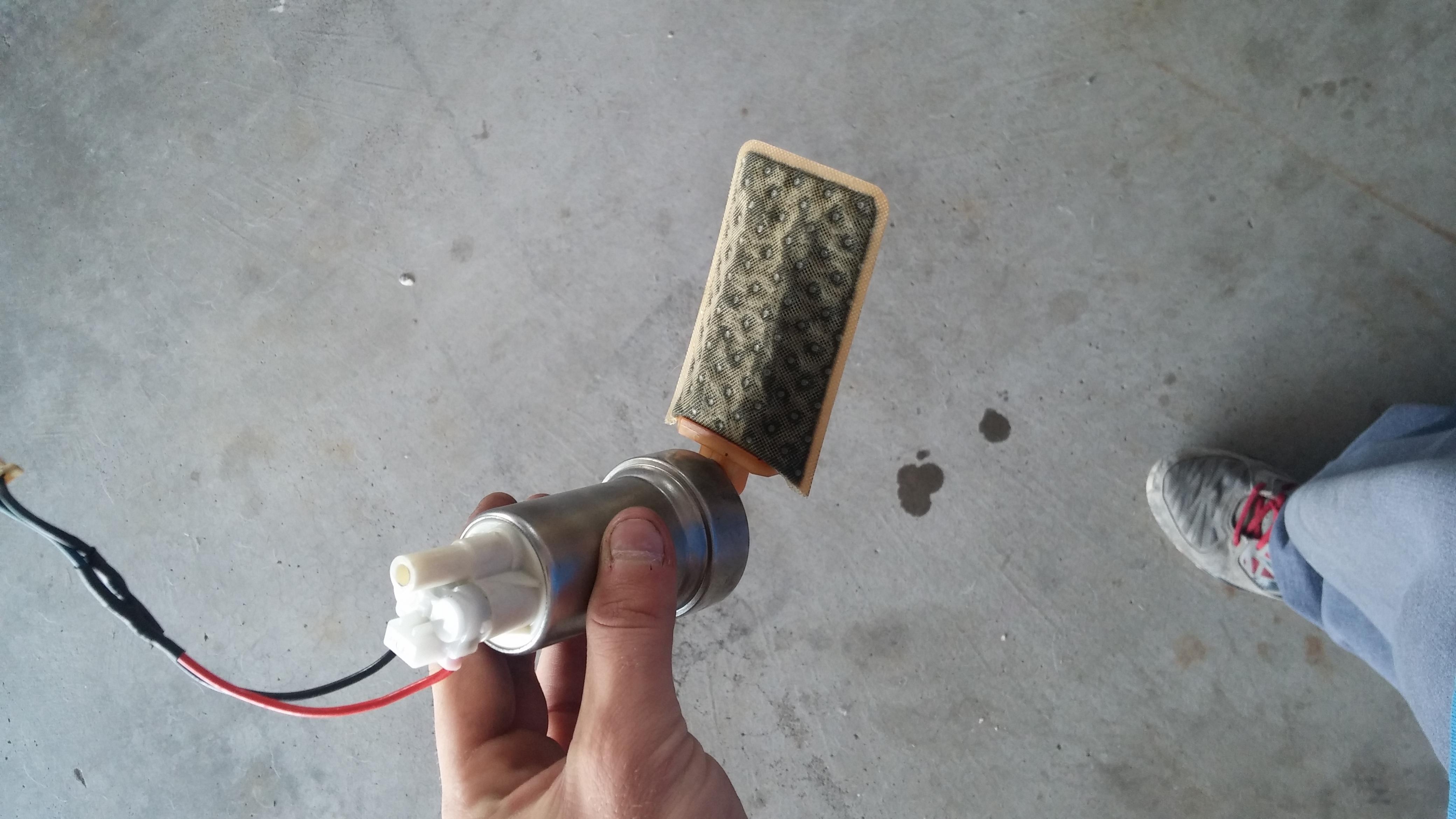

Heres the pump i pulled out

Looks like a Wally 450.

Thanks man i think its time to just get a dual pump hanger ha ha.

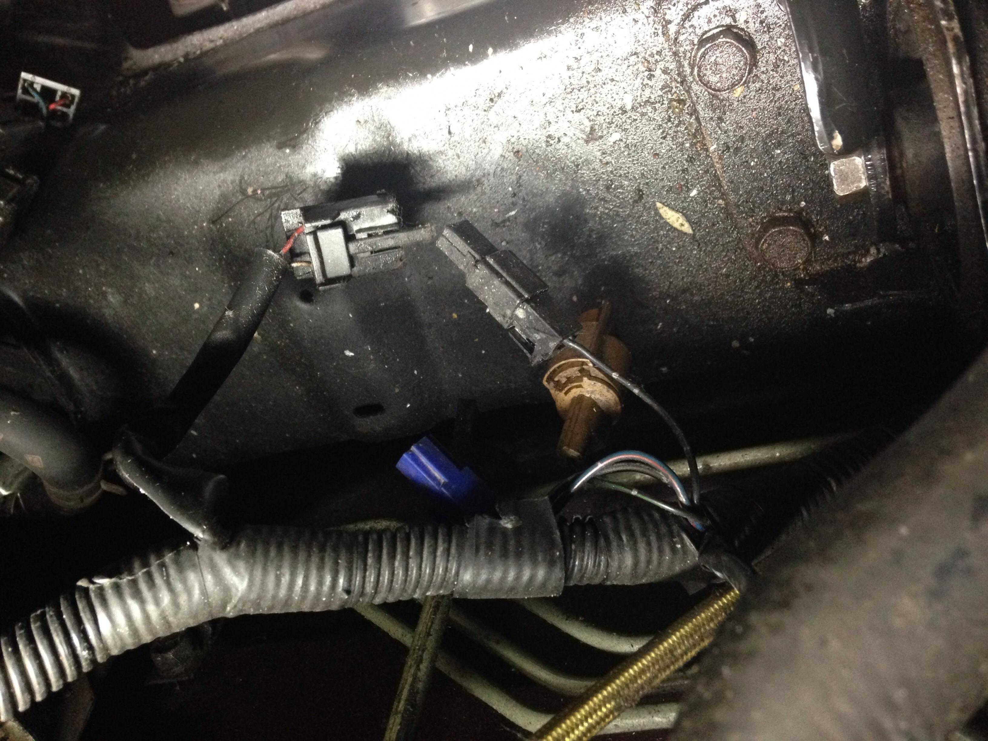

You should see the blue connector and black. I have a brown one as well for grounding timing (2ga's only)
Black is for fuel pump

If i find that conector what do i do with it or what will it do hooked up also sorry kinda stupid question

Jump 12v to that connector and it should turn on the pump.
