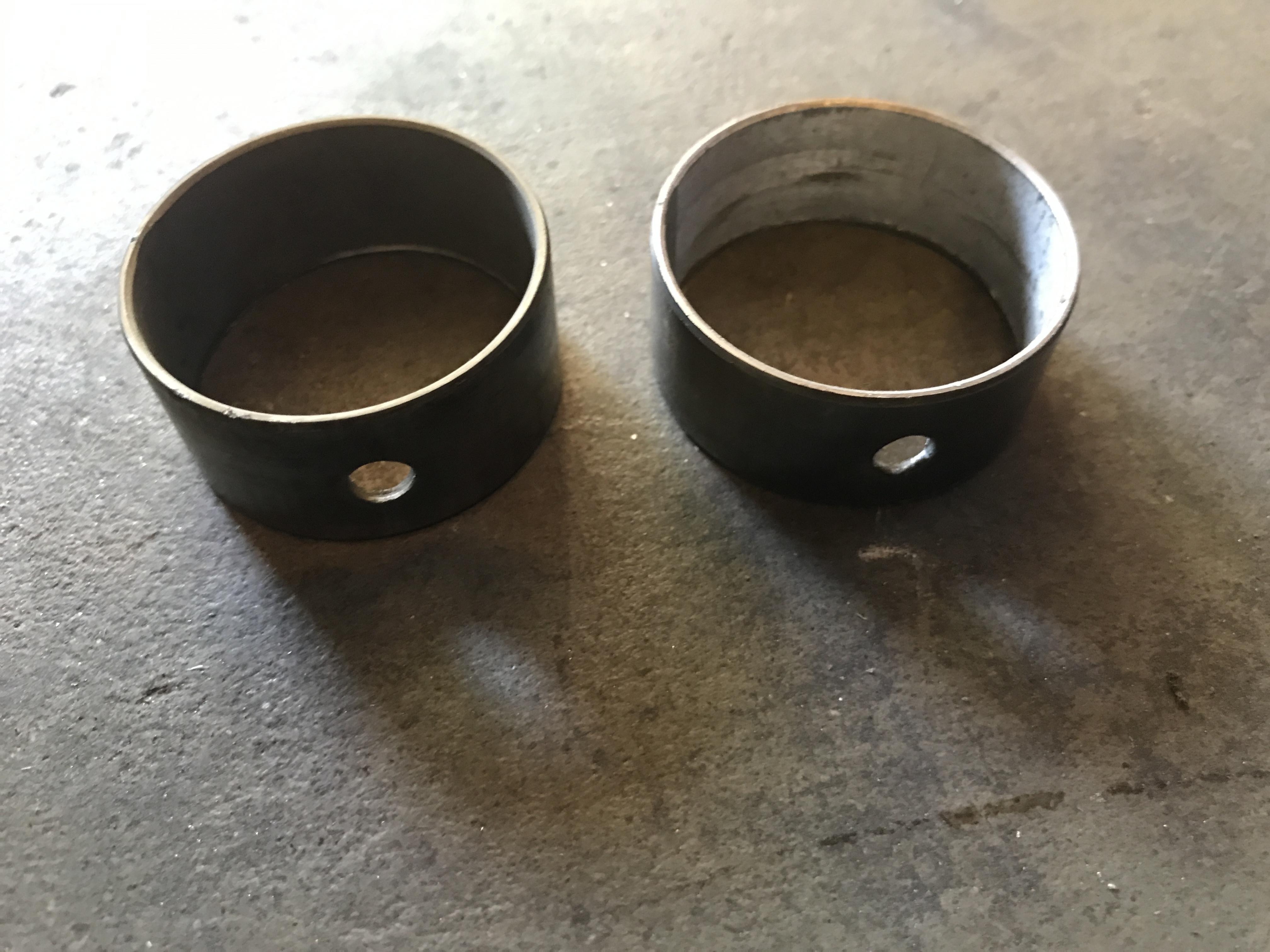

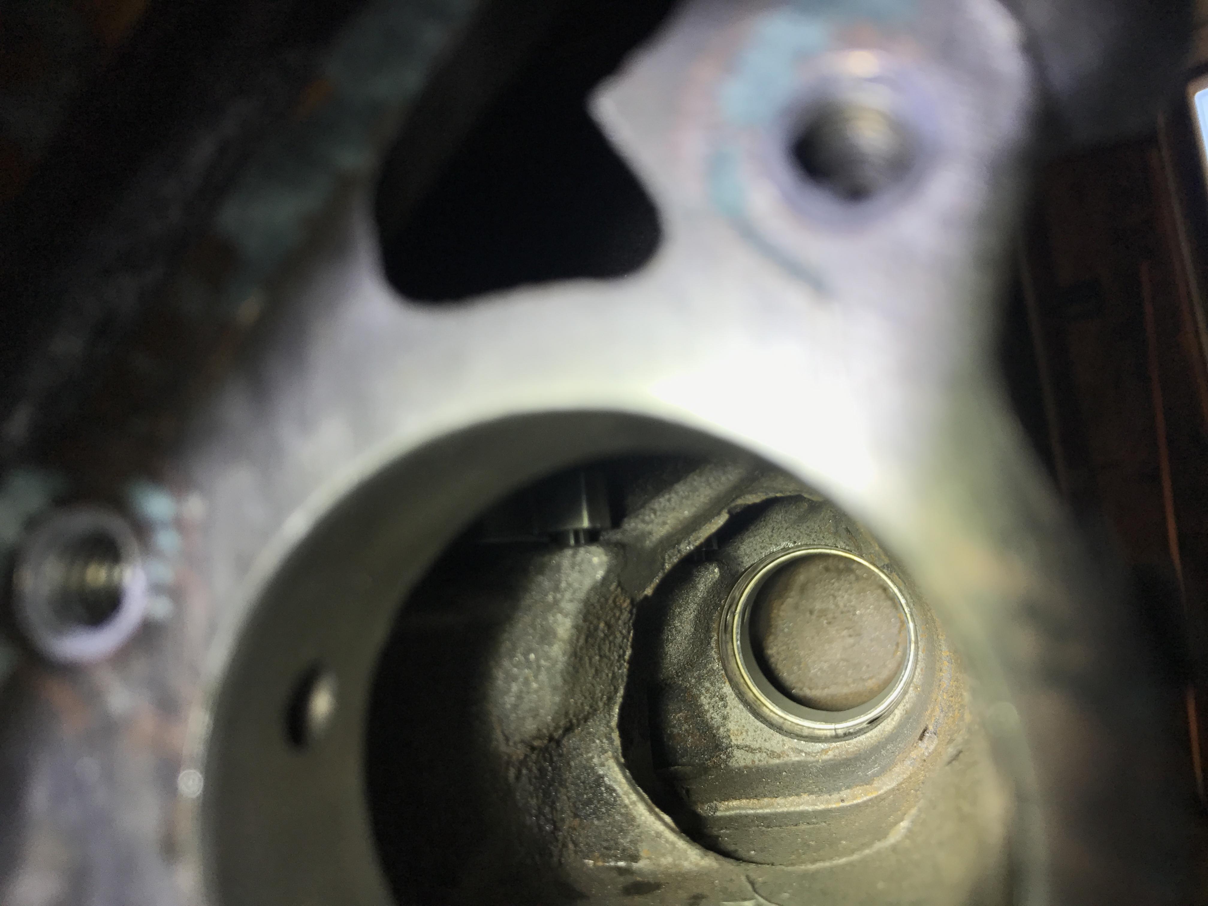

Finally got my block back! Started to assemble it and was about to time it tonight when the machine shop called and said he couldn't remember if he spun the balance shaft bearings or not to block the oil passage, since mine are deleted.. well I went and checked and they sure enough were not spun..got it back apart and knocked the bearings out and spun them. Waiting on a new front case gasket now before I can go further.

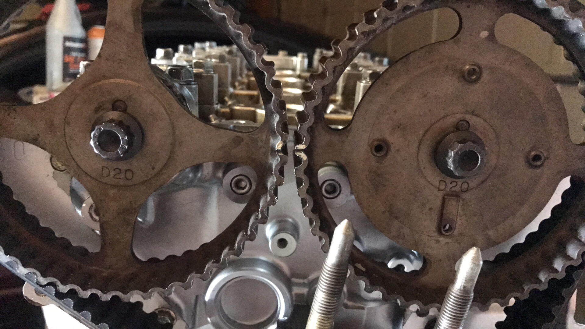

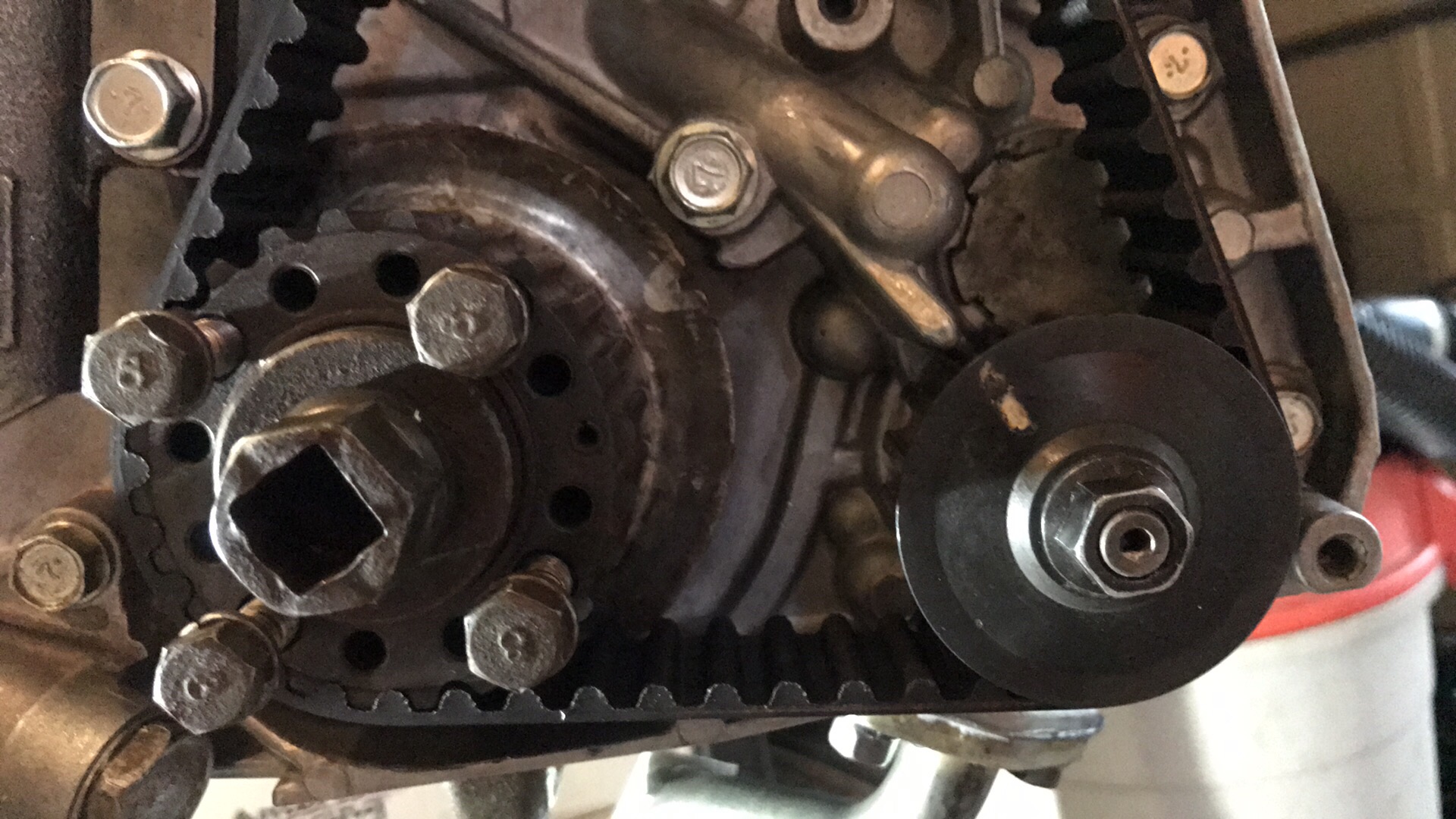

How's this look for timing?

Old 08-27-2017   #104
Re: Mark's Talon
Looks ok from the pic, but it's difficult to tell from pics. Only good way is to take a straight edge from center of cam gear bolts and verify the marks line up on both gears.

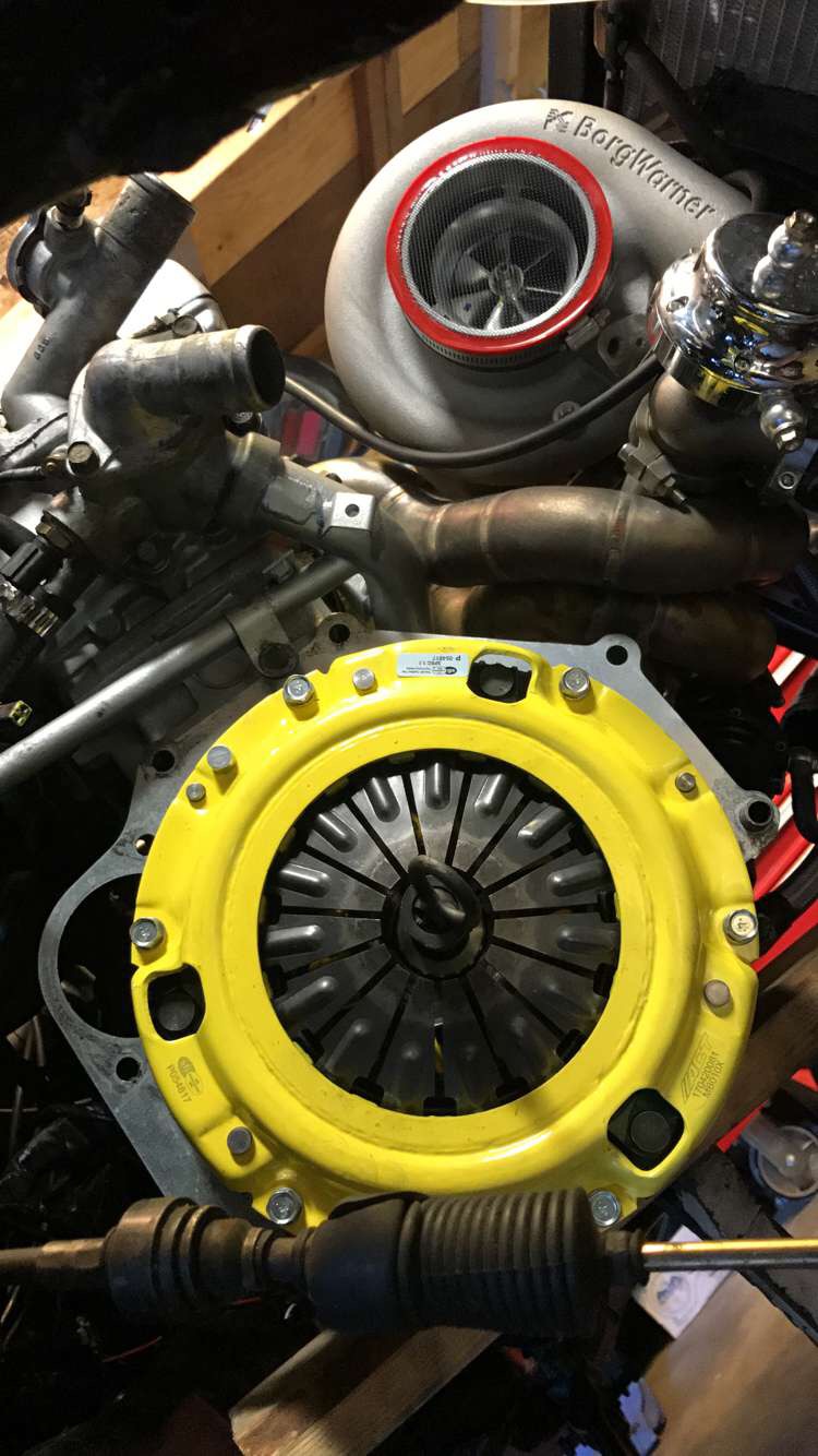

After it would idle I noticed that the clutch felt like garbage. Threw a new streetlite and 2600 in for now along with the sprung 6 puck disc.

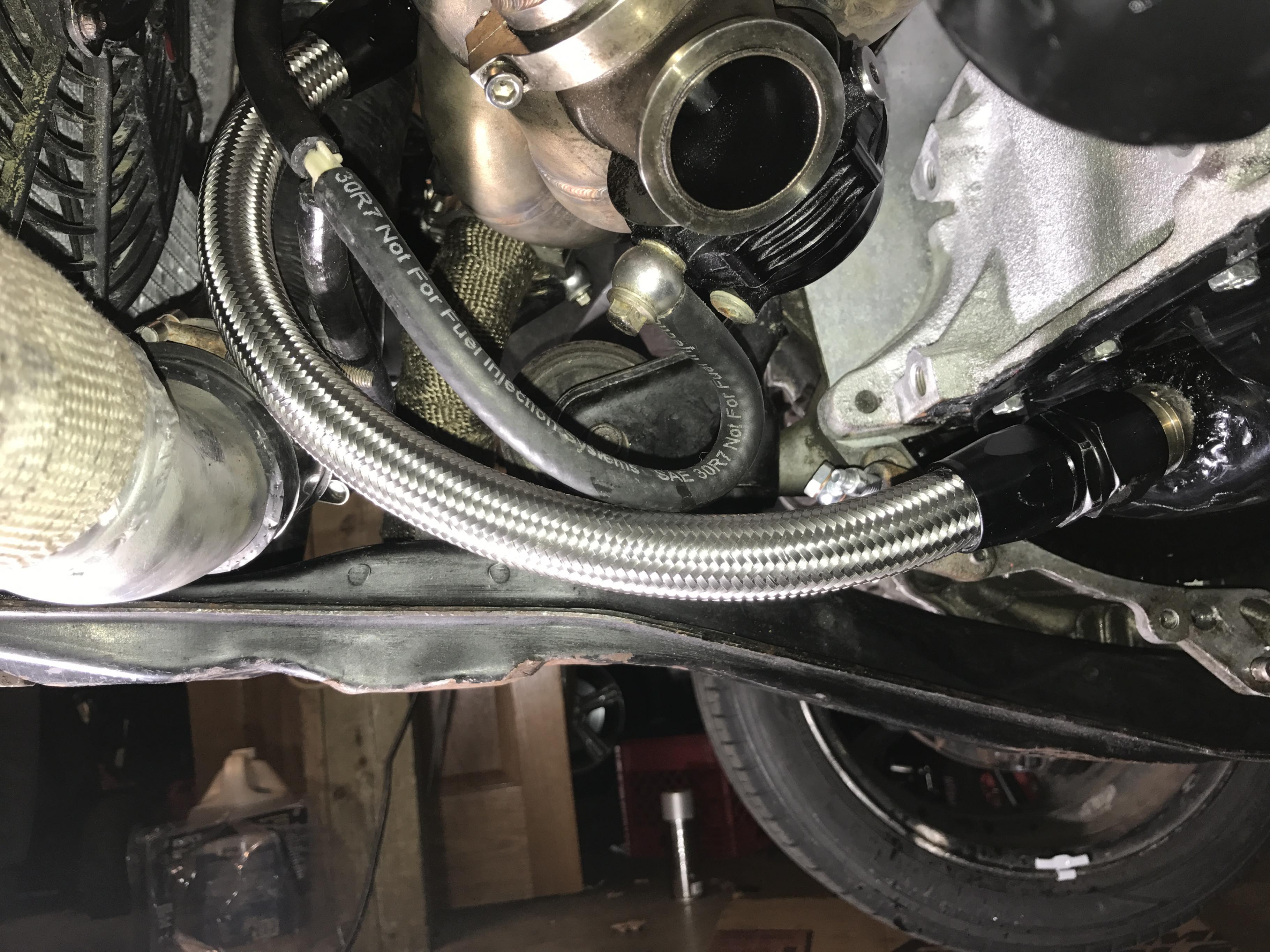

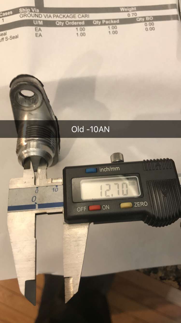

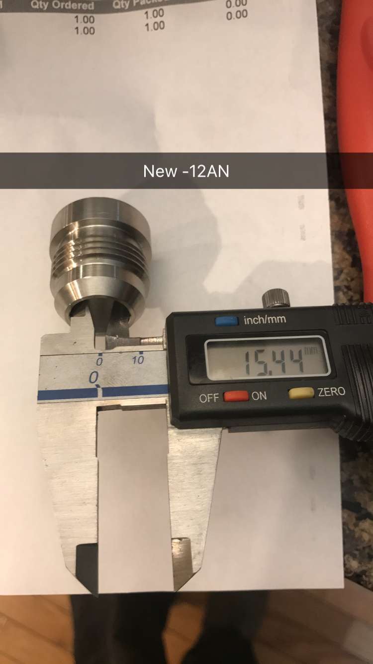

Drove the car around and turbo started to leak oil from the chra to hotside.
Got some -12 fittings and a new oil pan. Going to upgrade the return from the -10 to -12.
BW8776, e-85
Old 10-12-2017   #110
mark4g63t
mark4g63t's Avatar
Join Date: Jun 2012
Location: Twin Cities
Drives: 95 Talon TSI
Posts: 941
Re: Mark's Talon

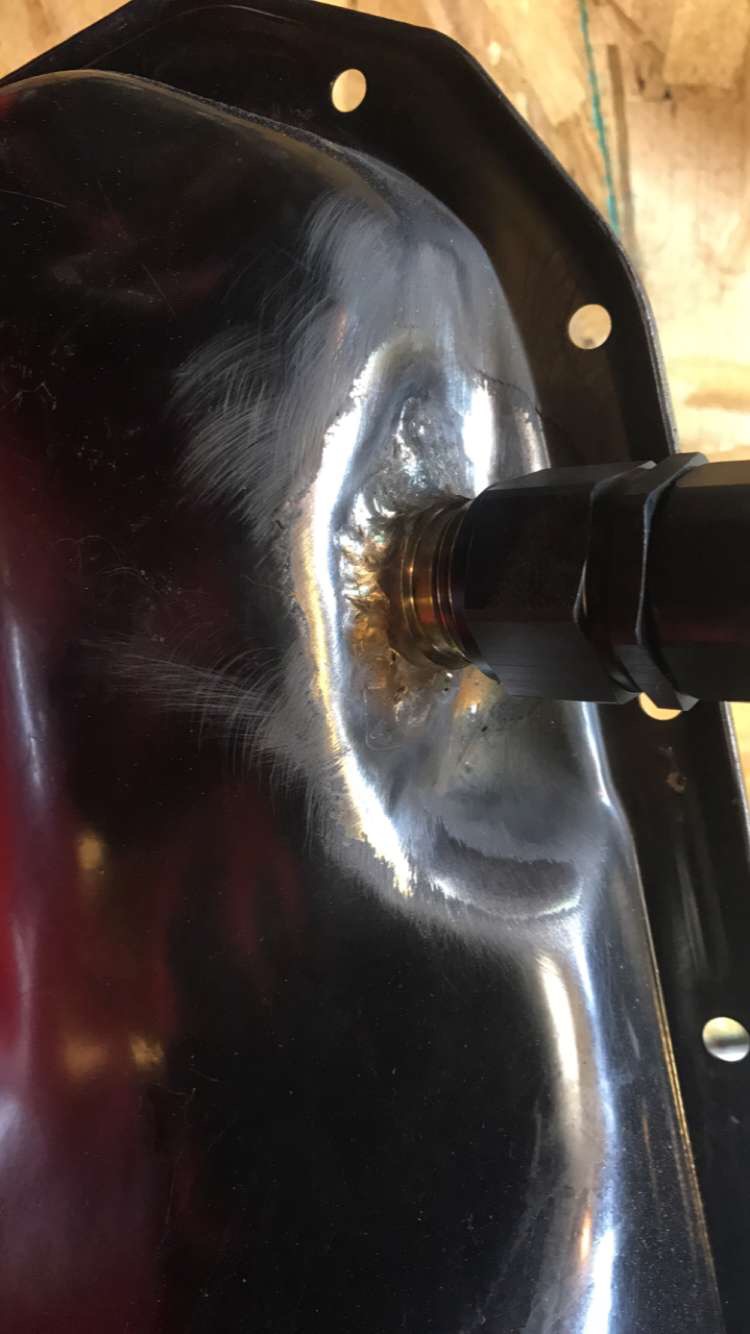

About to weld the oil pan bung on and make the hose. Hoping this helps.
The -10 to -12 is a big difference.

I would think -10 should be enough, the diameter of the oil exit on the turbo is quite a bit smaller than your -12 line. It's difficult to tell what horizontal/level is in that third pic, hopefully the drain line isn't going uphill at any point. Good luck with the tune!

Re: Mark's Talon
It's a slight "uphill" at the fitting of the oil pan but not bad at all. So far so good no leaks. The -10 is smaller than the stock return so a -12 was definitely needed. Excited to see how the tune goes.

Re: Mark's Talon
Yeah, I was wondering about how the return line dips below the entrance to the pan, but it seems gradual enough that the weight of the oil will still push it through. Looks good!

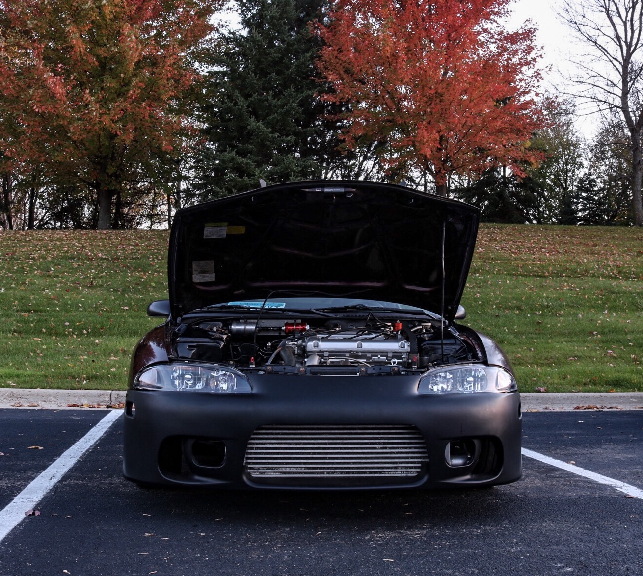

Tune is almost complete. Keeping it at wastegate pressure for now which is 15psi. Will be turning it up in the spring.
Here are some more pics from the other day when my buddy Nate and I went out.
I also ended up picking up a set of 17x9 wheels that I'll be throwing some Federal 595rsr tires on in the spring in either a 235 or 245.
