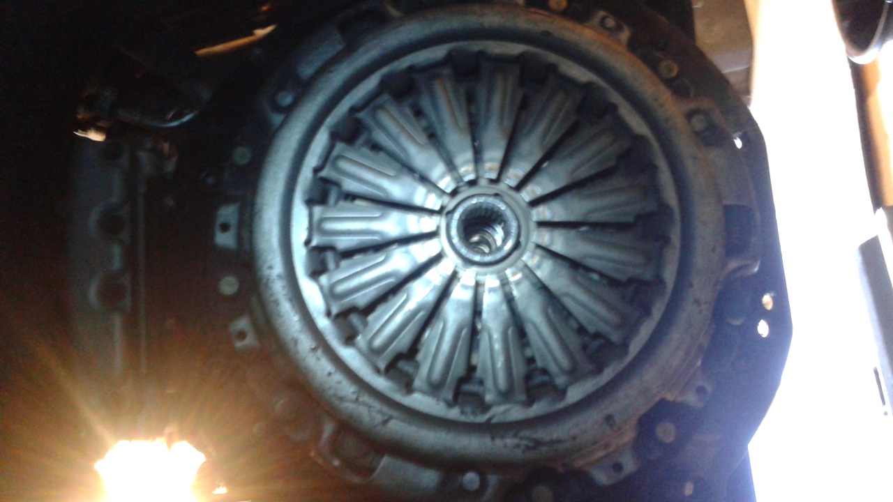

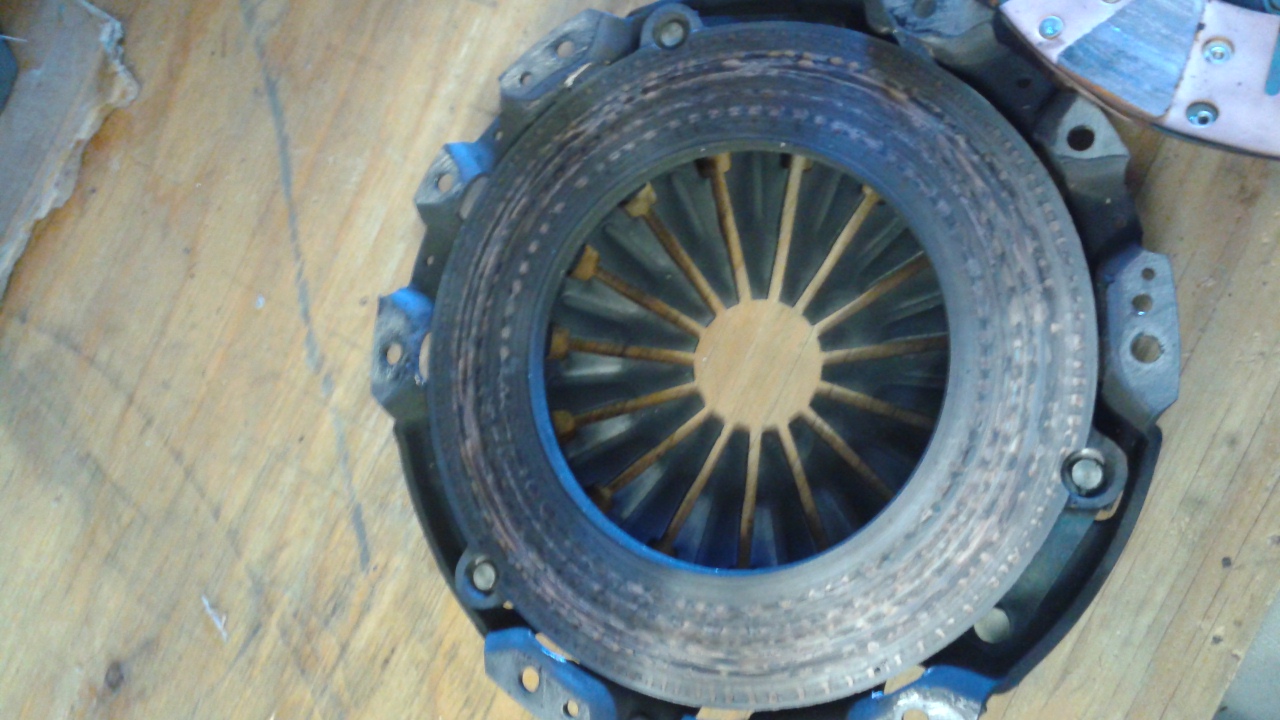

Got the trans out. Took a total of probably 5hrs over the course of 3 days. The FFIM that I had put on made it a bitch because it hit the brake boost when I was trying to tilt the engine back to get at the last too bolts. So that delayed me a bit. That manifold is too f-ing big. I am going to look for something else, I really hate it and I don't want to put it back on. But none the less it's out.

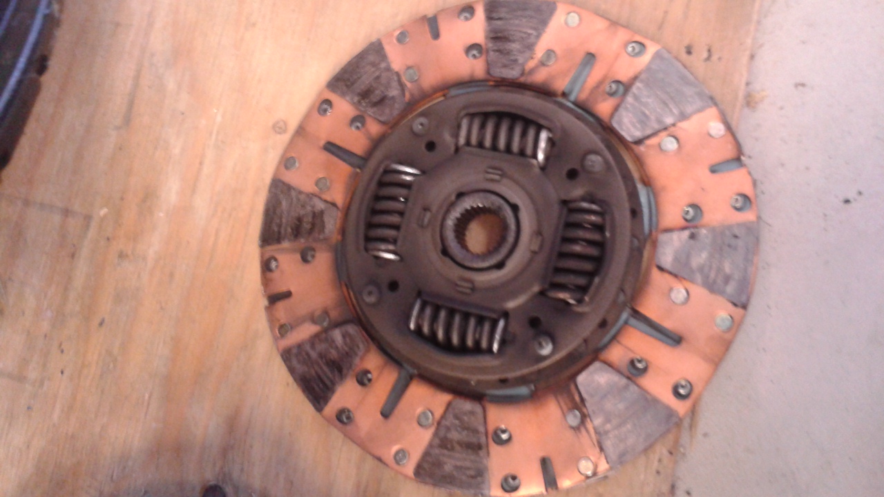

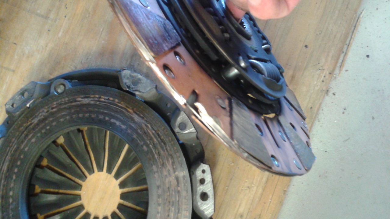

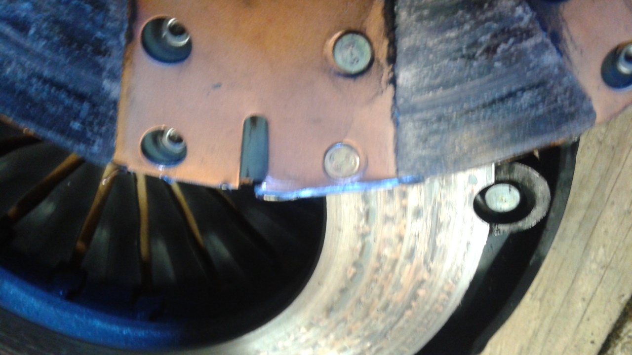

The clutch disc looks like shit. Nothing was welded together, but it was stuck to the pressure plate where the center piece was falling apart and wrapping around the pressure plate clamping surface. Maybe that's what was causing the issue? But truthfully not the smoking gun I thought I was going to find.

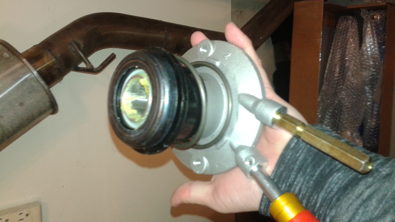

Anyway, gotta wait for the Collins kit to arrive. In the mean time I'm sourcing a new clutch setup and also a new intake manifold setup. I did get the new slave in for the new adapter, holy fook it's beefy!

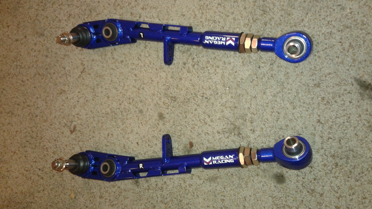

Also got my Megan rear lower control arms in. That should help me deal with camber and hopefully get a better footprint to help with traction.
That's all for now, here's some pics!

I don't remember what exactly your clutch problems were, but that disc is fubar'd. And like the issue. Cant tell from the pics, is it warped at all?

Momin, the problem is basically the clutch wouldn't disengage anymore. You pressed the clutch pedal, it felt normal, but it just didn't actually disengage. So like if you had the car off, put it in 1st gear, pressed the clutch and started the car, it would lurch forward as you're cranking it because it's not disengaged. Maybe you're right though, it does seem a bit warped so maybe that was wedging it in there just enough that it wouldn't disengage.

It's hard to tell from pics, but is the disc edge totally fubar'd? If so, that's fubar.
Seems like you have the situation under control though with a new clutch and trans adapter or bellhousing on the way, good luck this year!
Old 03-29-2016   #1291
Re: Project Lex
It's a JWT clutch for a 350z.
Yeah the edges are nasty, what even would cause something like that?

Was the inspection plate on? Maybe something fell in there?. Some rivets pop off?

Yes it was, and also it's not really useful anymore because of the whole adaption, things aren't as they were intended. There really is no way to use the inspection cover anymore with the swap.

That disc is just falling apart, weird. Well hopefully a new clutch solves all the issues!

Is the pilot bearing still okay? Maybe something got jarred to cause the outer ring of the disc to catch something. Probably excessive heat or something and warped the whole thing.

Yeah I'm not really sure. You can see what I can see, I don't really know anything more than that. I think excessive heat is a likely contributor, especially considering it finally let go at the track after launching which involved a little bit of slipping / dumping the clutch.

I can stop by as well. Can help with the hood, and would like to see the disc and pressure plate. I'm guessing the distortion of the disc (and friction discs on the disc) is likely the issue. It doesn't take much variance in thickness(including overall "thickness" caused by warping..) of the disc or cut of a flywheel for a setup to hangup or not fully disengage.
The heat spots on the pressure plate indicates this thing isn't disengaging, combined with your last day at the track..

Put the clutch disk on the pressure plate. It should lay nice and flat when your press one side to the other side. How is the input shaft on the transmission? Can you see what else rubbed on the clutch disk?
