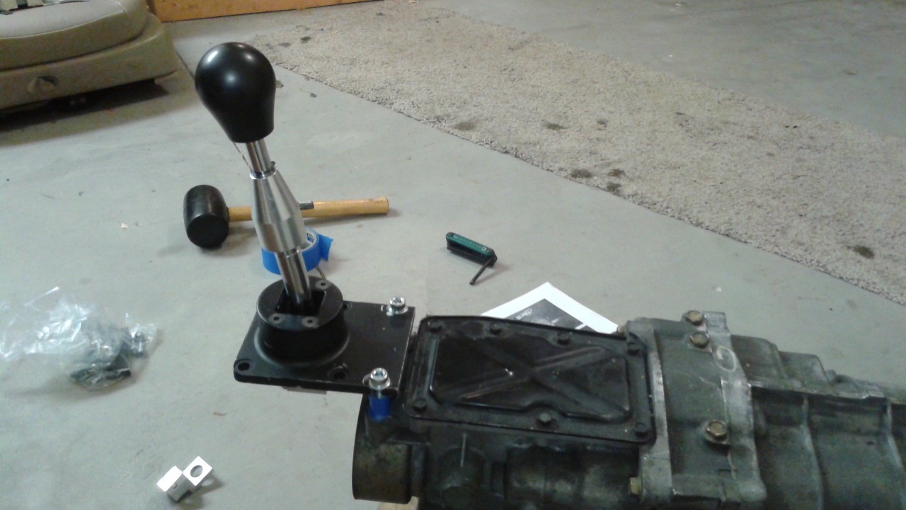

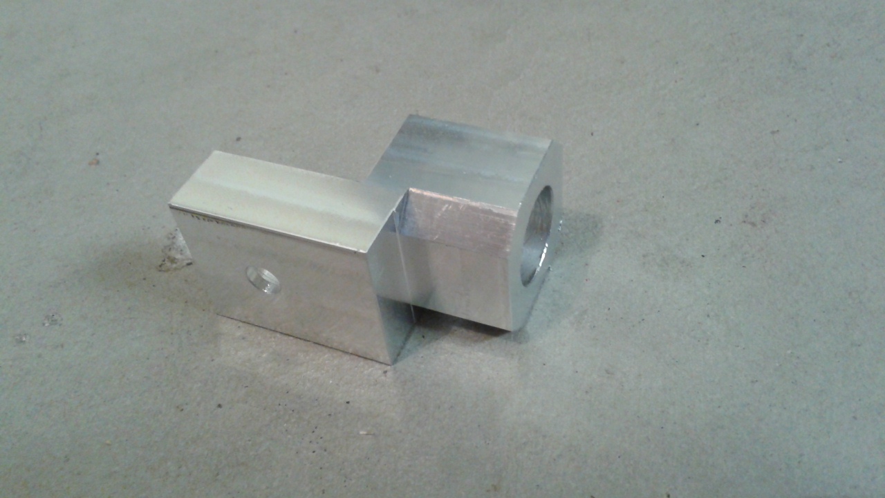

Shifter linkage prototype 3D printed. 99% there. Couple tweaks mm here mm there, and I think it'll be perfect!

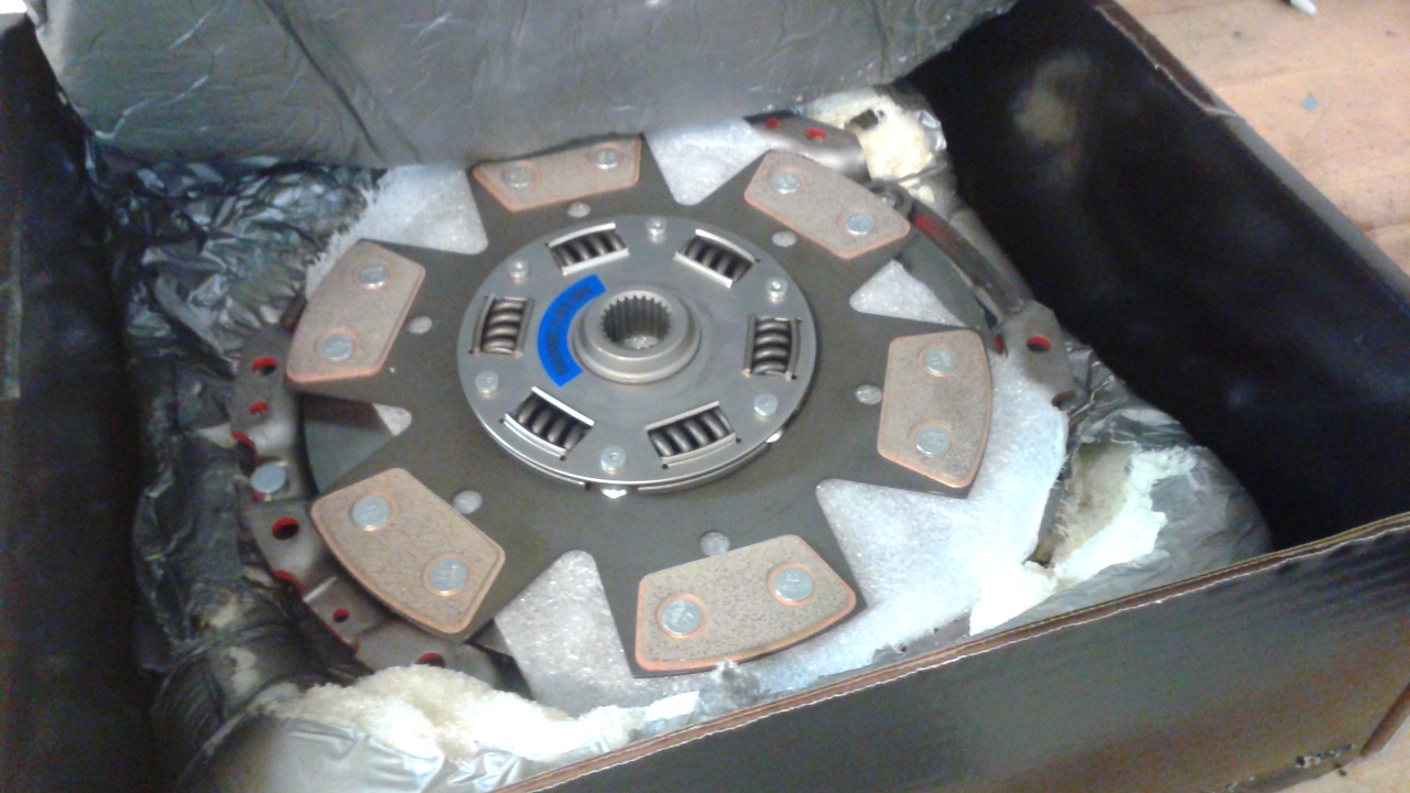

- Got my new clutch. It's a South Bend Stage 3, 2700lb pressure plate, sprung 6-puck disc. Rated at 715tq. SHould do nicely. If I run into issues, with it not holding, I can upgrade to their Extreme pressure plate in the future (3000-3200lb).

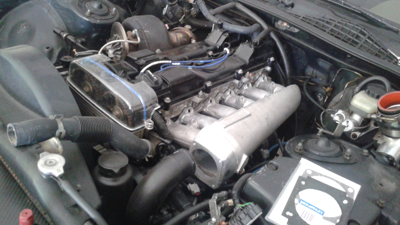

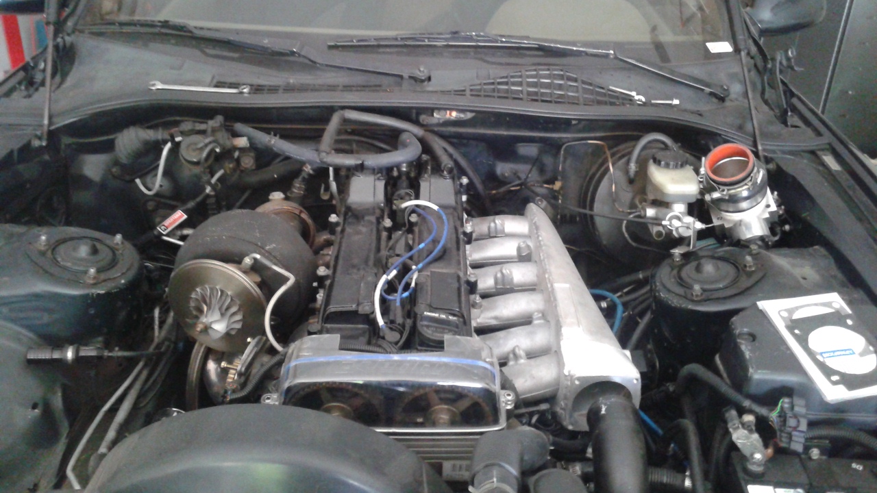

- Got my new intake manifold. The build quality is OK. But what I love about it is the plenum size is much more street oriented, and the plenum size being smaller you can easily see how much easier it fits than the old massive one. I only held it up to test fit, but he told me I should actually be able to go back to my stock power steering reservoir, which would be really nice!

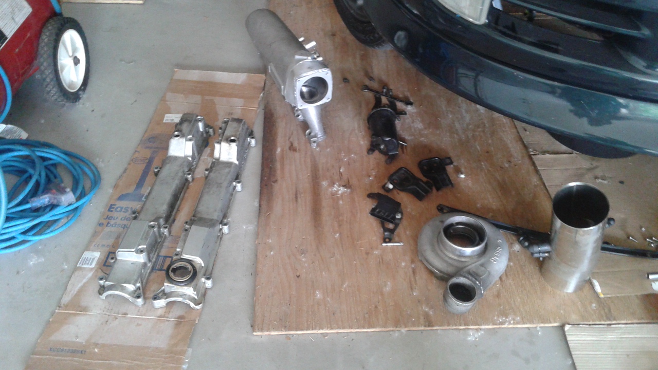

- Got some more stuff rounded up into my powder coating stash. Hopefully get it to a coating place next week!

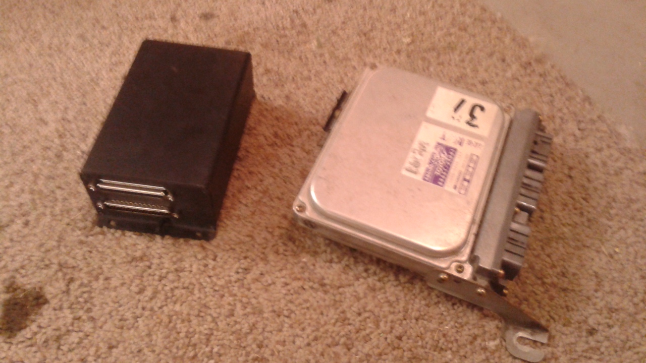

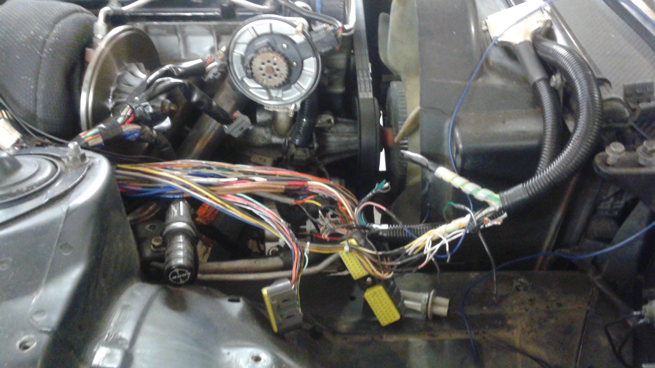

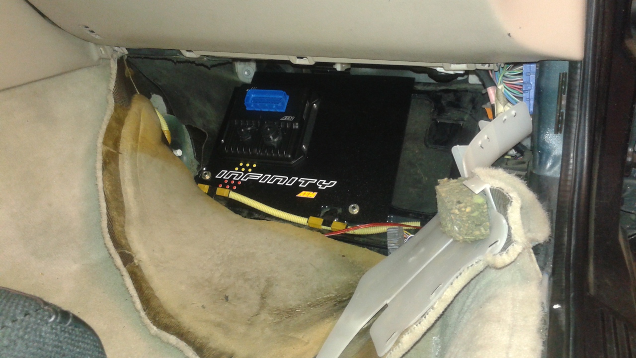

Well shit is moving super slow with the kids taking up just about all of my time. So I just decided to slowly start doing what I can here and there with the idea that this year is pretty much a bust, so might as well start tackling all the little things so it's hopefully as ready as can be for next year.
So with that being said... Out with the old. Still have a bit of unsoldering / resoldering to get the harness back to stock. Then going to slowly start working on installing the new PnP Infinity.

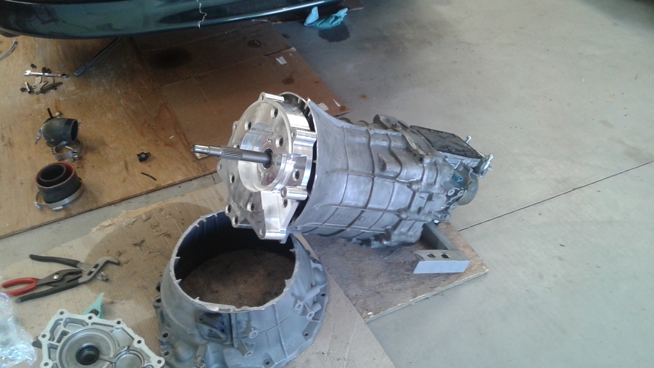

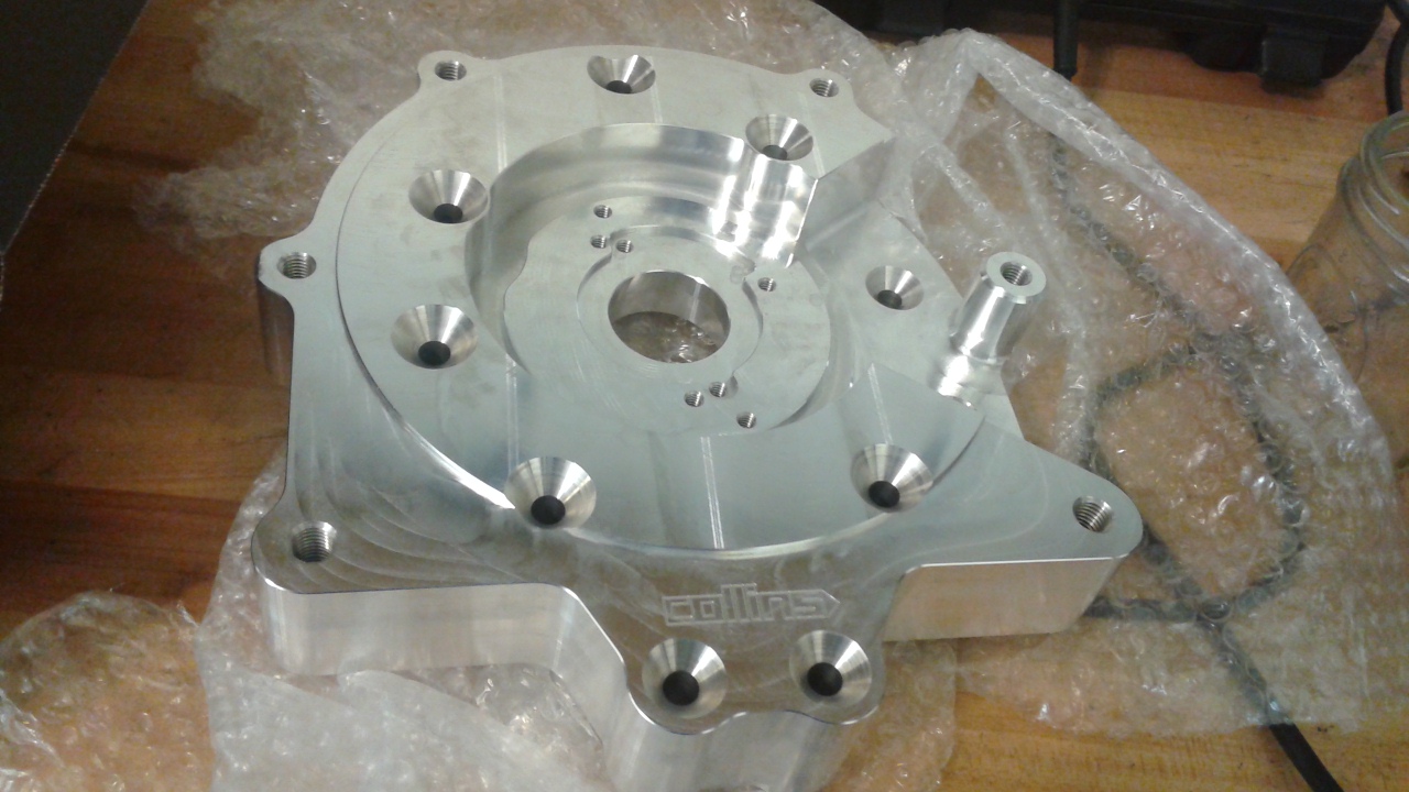

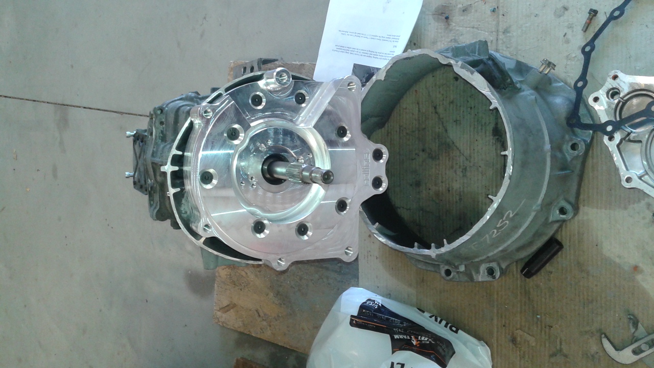

New adapter came in. Looks really nice. Time to get out the grinder and start chopping off the bell housing!

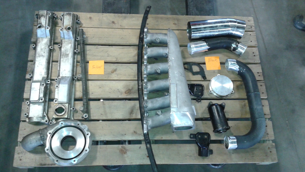

- Got a bunch of stuff dropped off at Twin City Powder Coating in Lino. After a little boondoggle figuring out colors, I think I'm good to go now. Most of the stuff is getting fine texture black to just keep it looking clean/simple/semi-OEM. Couple things are getting a different color for a slight contrast. Again trying to keep it clean/simple/not flashy, I went with a silver color. Depending on the lighting, the silver does have a very slight light brown/bronze hue to it. Stuff on left will be silver, stuff on right will be black.
- Got the bellhousing cut off the trans. Got the input shaft cover off and the stud shaved down. Waiting on a seal, should be here in a couple days, and then I should be able to mount the adapter to the trans. Also still waiting on Flywheel...

The 350z trans doesn't have a removable bell housing. So u chop it off. But then that exposes the input shaft cover which is held in place by 11 bolts. So th let adapter bolts to that.
If you go on Collins website, he has a vid of how to do it. His vid is a T56 adapter I think, but same concept.

Got the adapter plate mounted to the trans today.

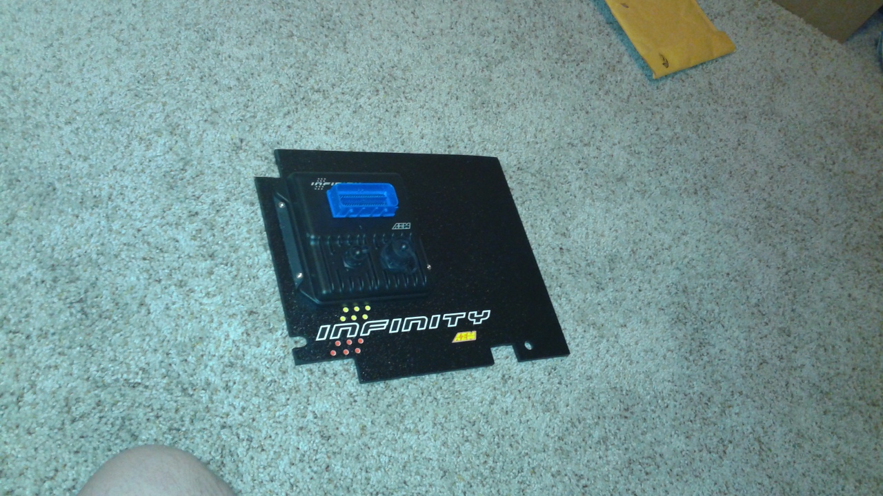

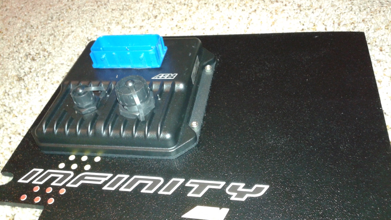

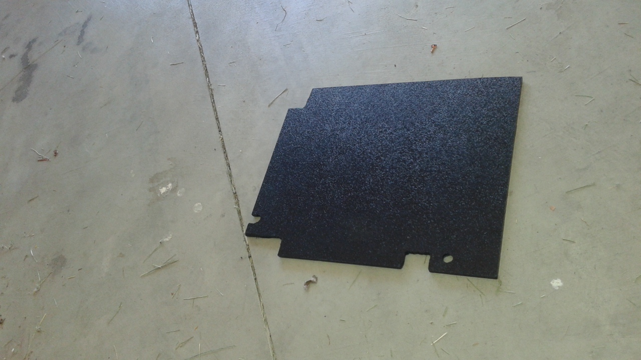

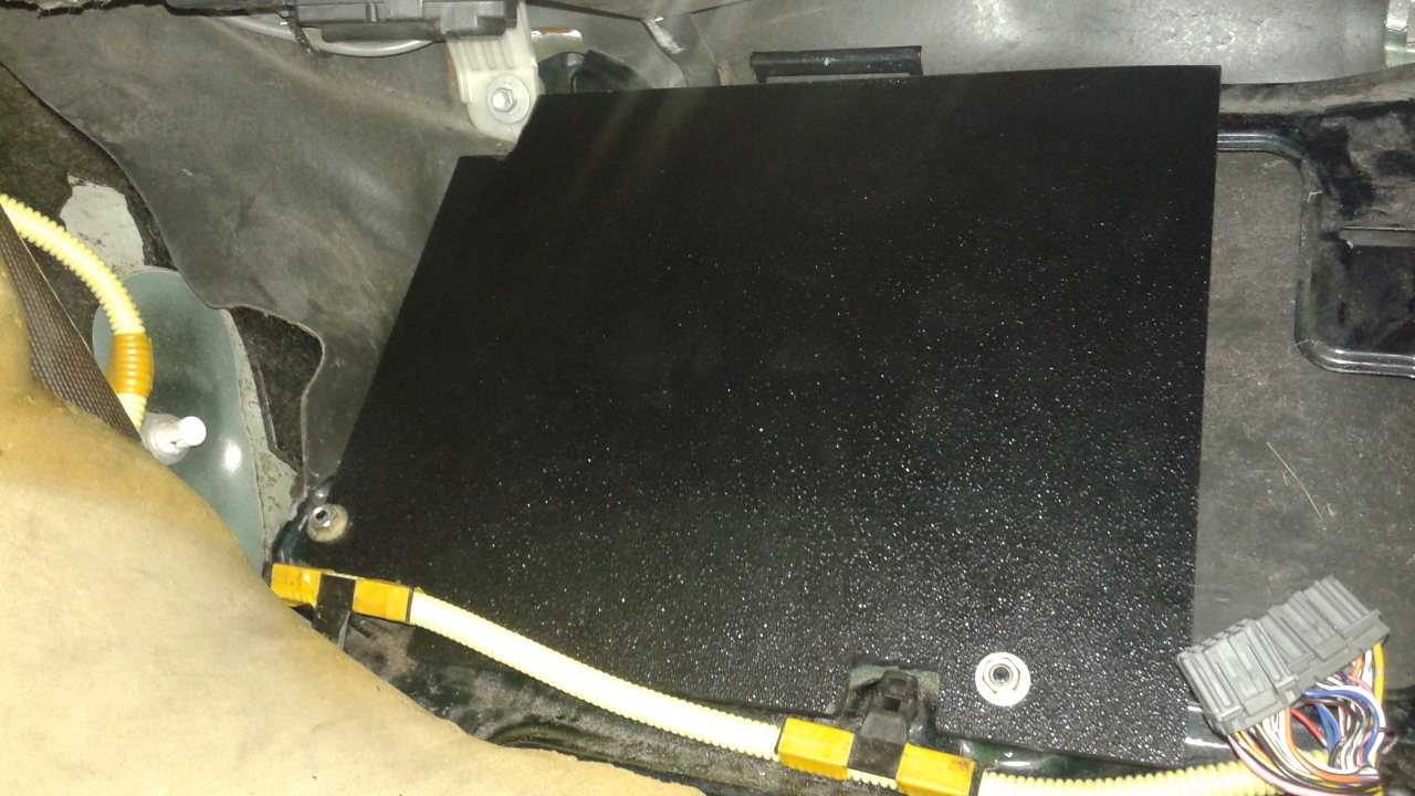

Also made up a little mounting plate rough cut for the AEM ECU. Picked up some 1/4" thick ABS Plastic. Will clean it up a little and start mounting things to it.

Yeah that's the idea, and the whole reason I'm doing it. The OEM 350z bellhousing is massive. This will use a SC300 / NA Supra auto bellhousing. A bellhousing designed to fit this car. So 'hopefully' it will make install / removal way easier. I guess I'll find out...

Some small updates here. I got the AEM mounting plate cleaned up at work a bit. As good as I care to get it. Pretty happy with how it turned out, considering it was just like a $8 chunk of plastic

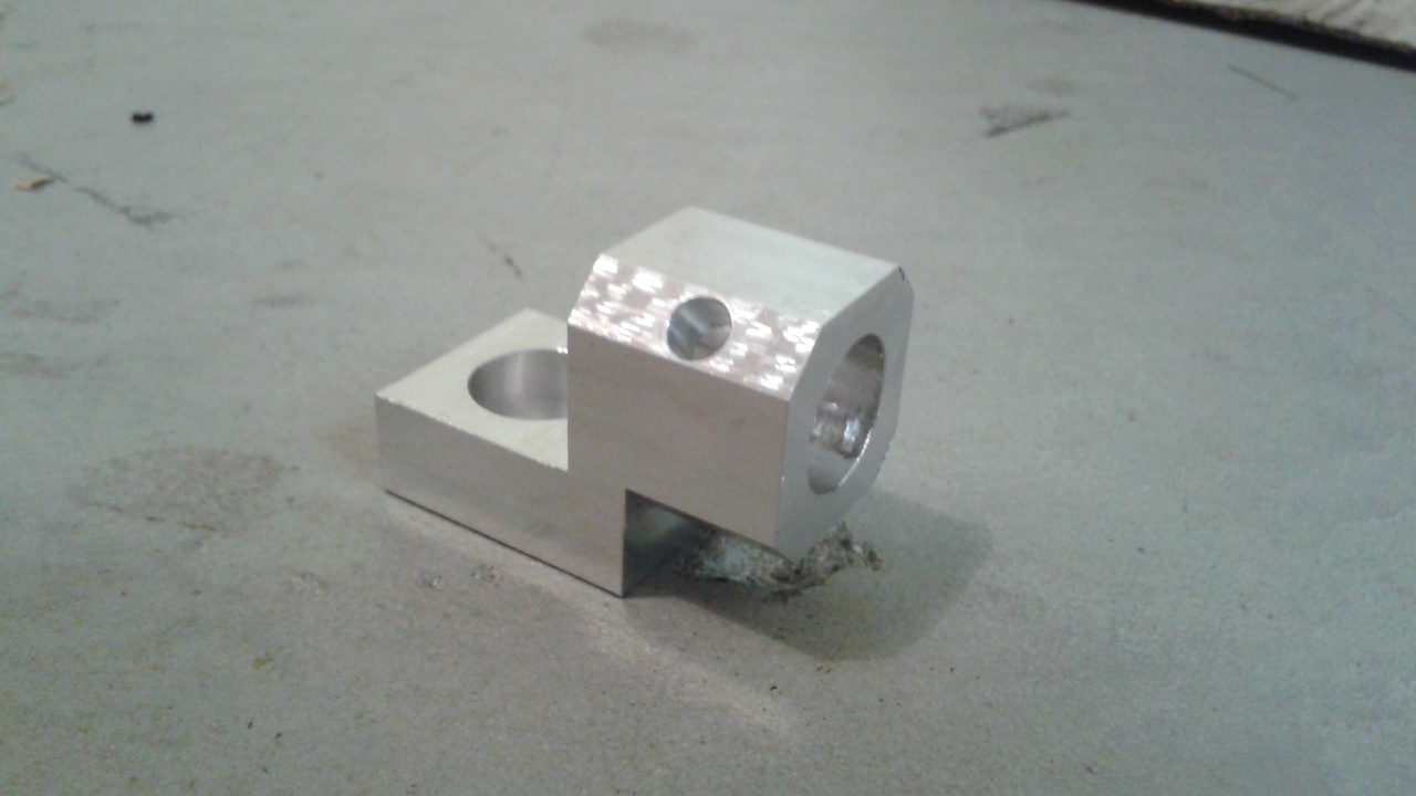

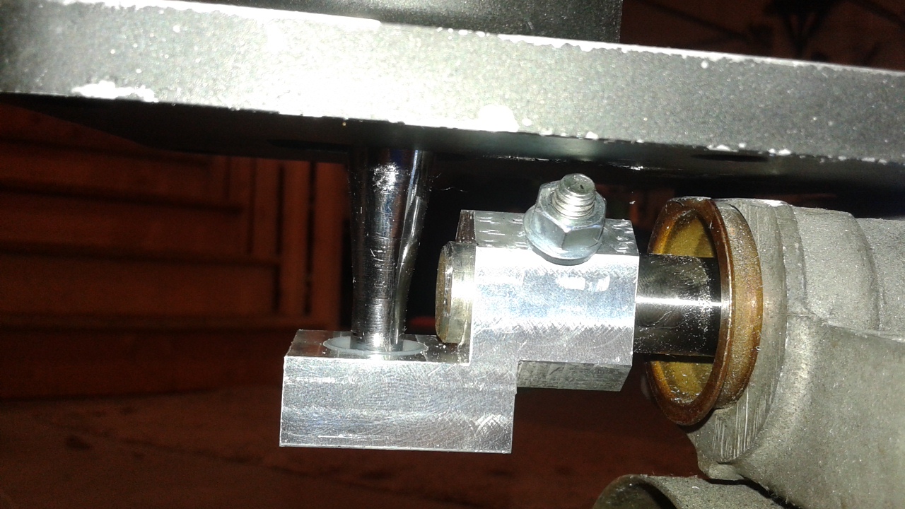

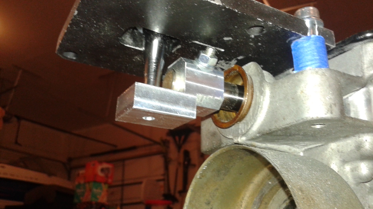

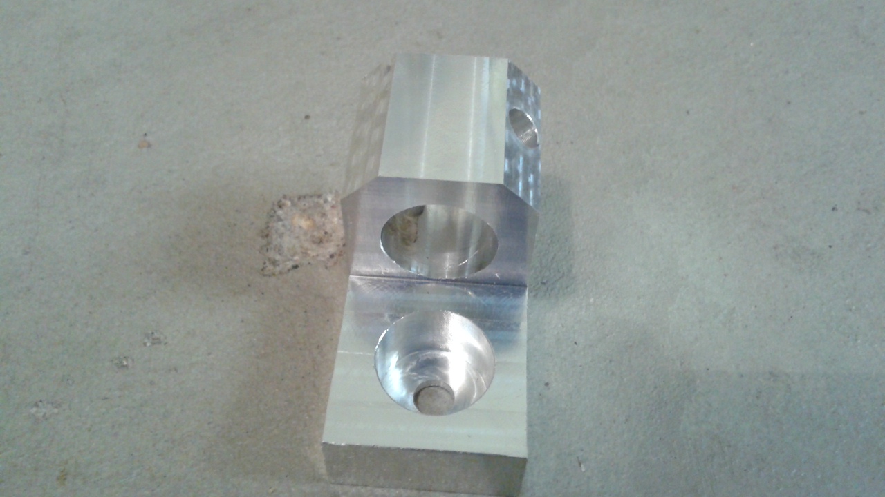

Got the 3rd design of the shifter fitting back from getting machined today (Thanks Rosey!). I think this is pretty much done. The shifting left to right is so close, I feel like I'm going to be experiencing a lot of miss-shifts. But everyone keeps telling me you get used to it. So we will see.
Got the trans pretty much buttoned up then. Got the slave installed. Flywheel should be here tomorrow. Powdercoat is 'supposed' to be done tomorrow. So time to just hunker down and start getting stuff installed.

Glad it fits! I like the updated rev with the thicker bottom and counter bored hole.
Old 07-01-2016   #1339
Re: Project Lex
nice work!
Old 07-01-2016   #1340
Re: Project Lex
Me too. I hope it didn't create that much more machining work for you. Hopefully next week I'll feel comfortable enough to say it's good to go and see if you can make a couple more to finish off that chunk of aluminum. Thanks again dude!
