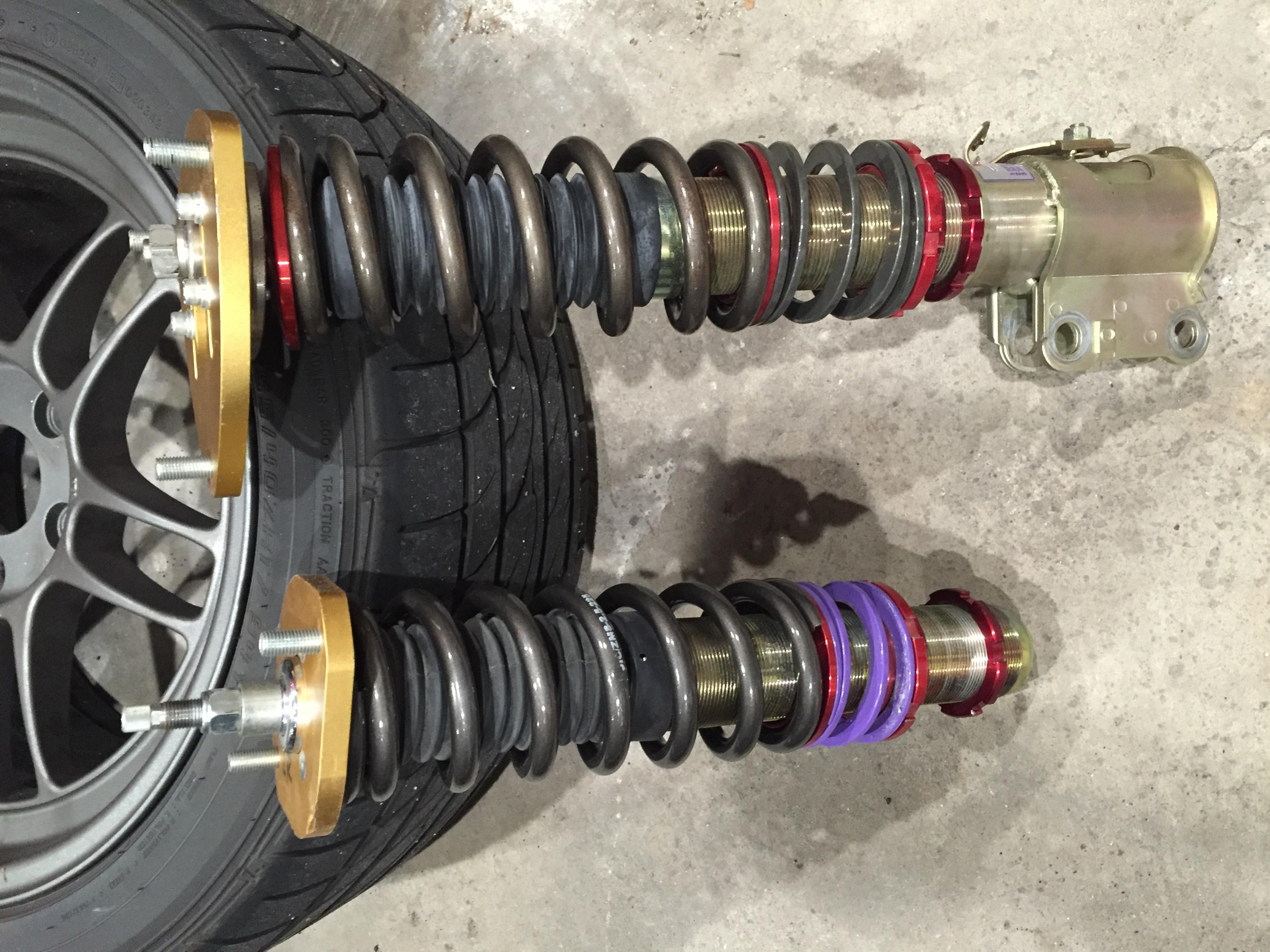

Well, continuing off my last post and deciding I can't get there from here, I picked up a set of good coilovers from EvoM, JIC Magics. Of course there are a few challenges, but that's what makes it fun.

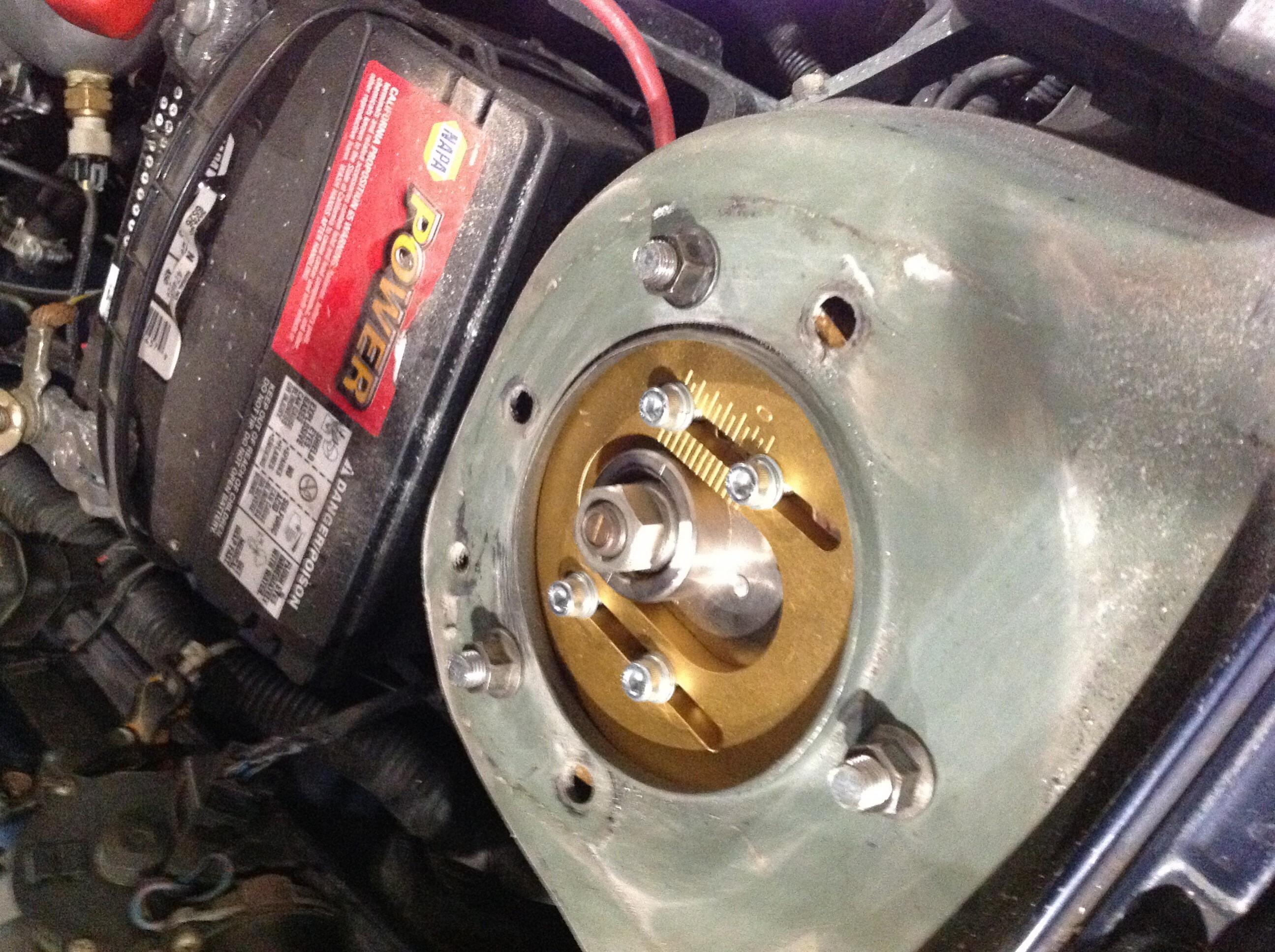

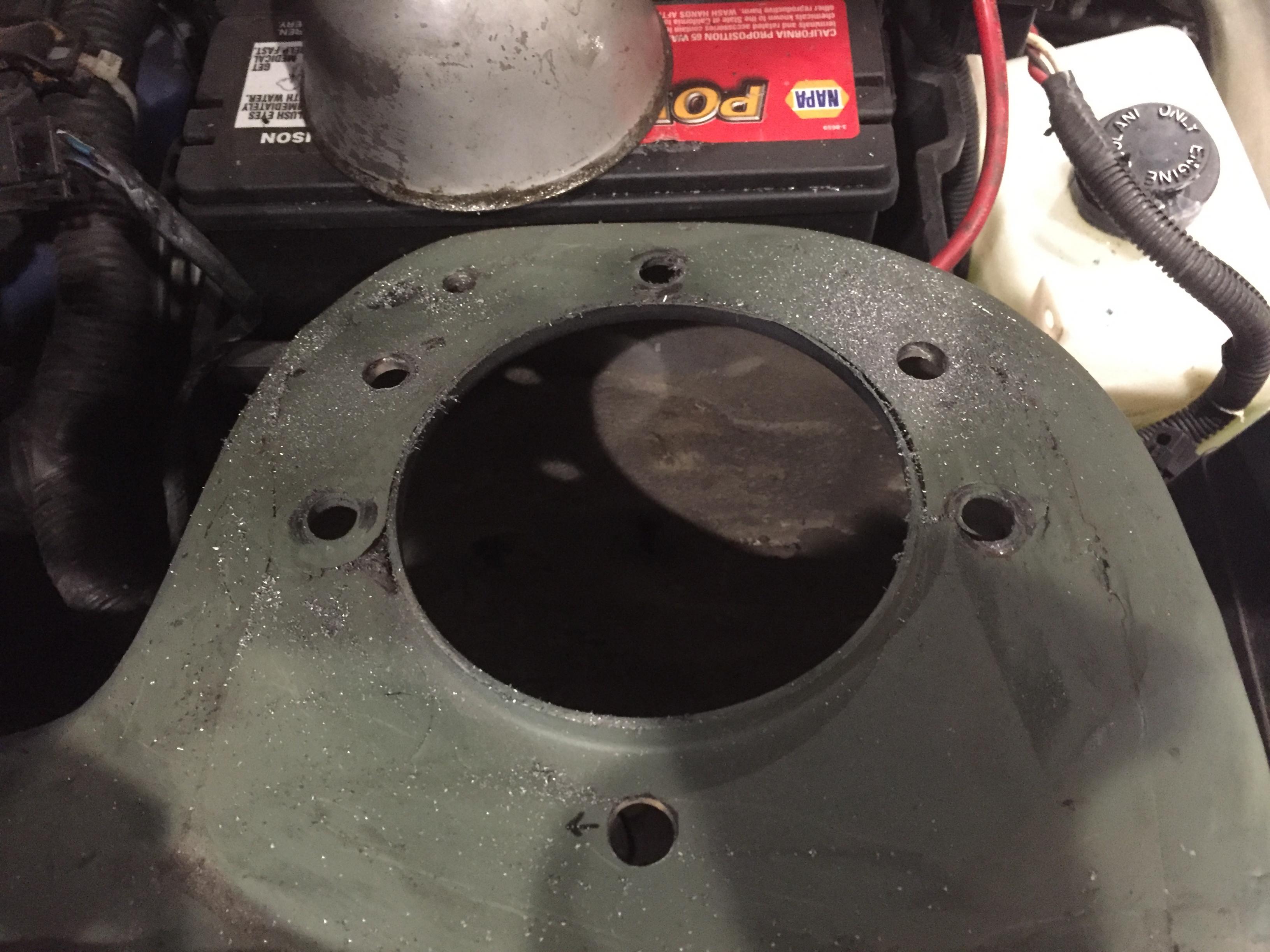

Then comes the fun part, converting from Evo fitment. First, after a lot of measuring and luckily having an Evo 5 feet away, I drilled new holes for the top mount.

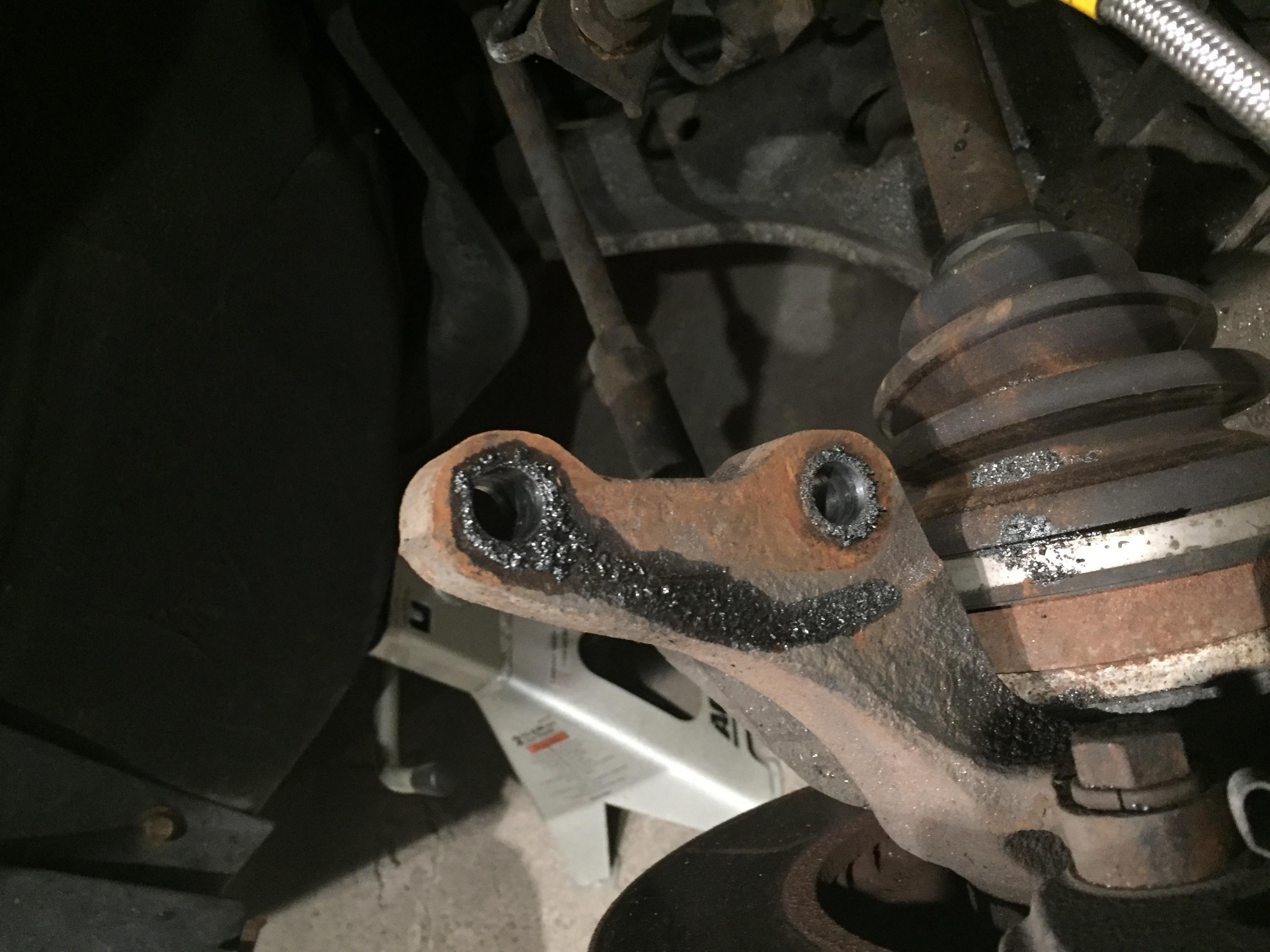

Then comes drilling out the lower holes for the larger Evo bolts and grinding off the factory eccentric portion of the upper bolt since I don't need that weak camber adjustment anymore. Up next, fabbing the brackets for the extra width of the coilover lower mount and bolting up the fronts. Holes on the shock tower will be welded up and the whole engine bay will get painted this winter.

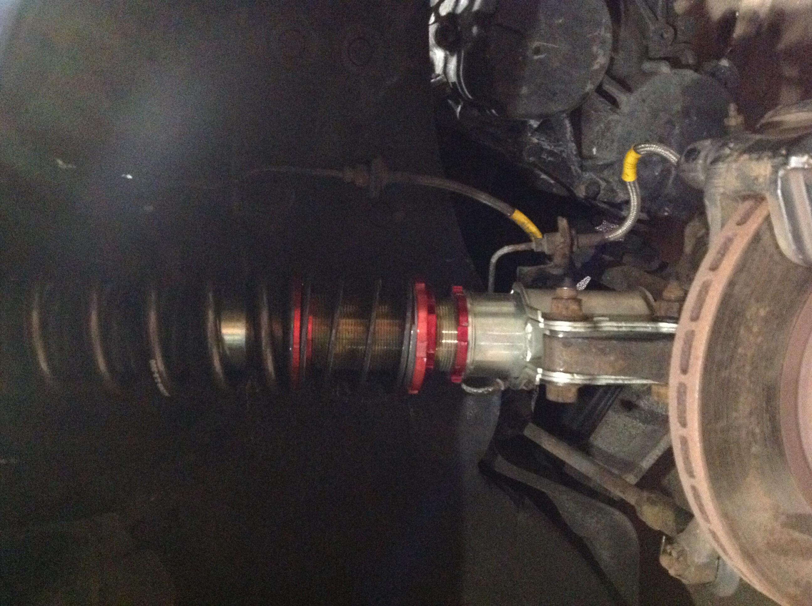

Success! One down, three to go. Bonus, with a little coaxing, the factory brake line mount bolted right up to the JIC.

I suppose I could update this a bit. Ended up buying new parts store rear shocks just to cut the lower mounts off of to weld on to the Evo rears. After clean up and paint, they look good. I've found the spring rates to be a little stiff for my taste, so among other projects this winter, I'm looking at slightly softer springs. I've also picked up an Autopower 6-point bolt-in cage with halo bars for road racing next summer. I'll probably just unbolt the front bars for street use. Off to storage for the winter.
