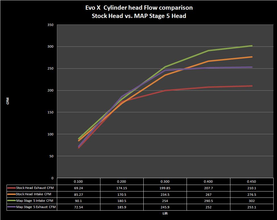

to put it in perspective.....

Quick formatting error on my part, I should have staged the table out below intake/exhaust/intake/exhaust, I can re-upload if Chris wants to use the table for anything.

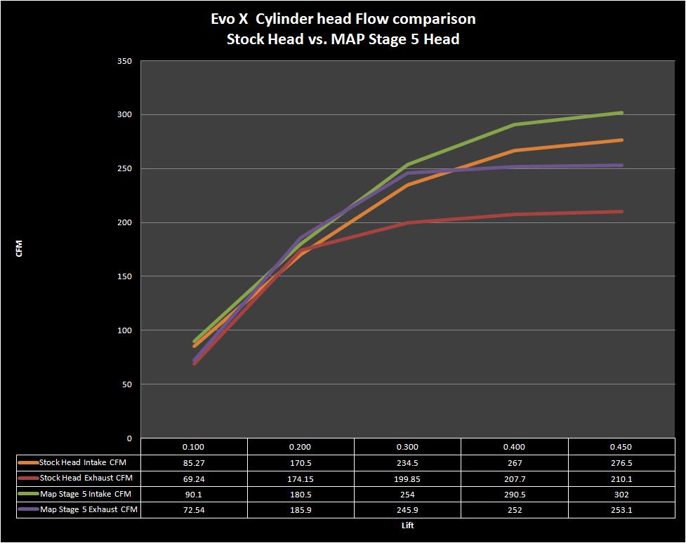

Originally Posted by v8klla View Post
Sure I could put it on the site, thanks!
Done, and you've got a pm.

That is fucking insane. DSM option?

We can certainly perform the same service to DSM or Evo 8 & 9

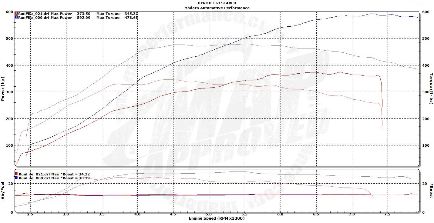

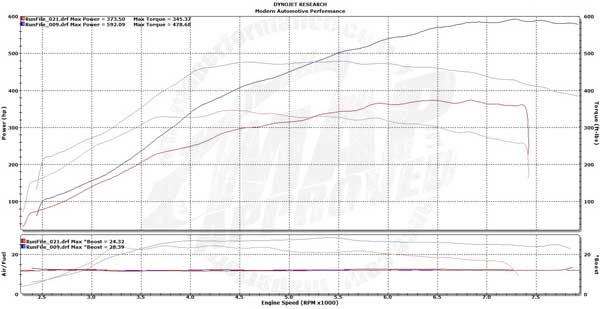

Well this has been a long time coming as my little project always seems to find itself on the back burner lol. Long story short, by combining some additional displacement with our EF4 turbocharger we've created what I believe to be the ultimate daily driver. 5000+ miles on the engine already, 60+ miles round trip daily, and no plans to put her to sleep for the upcoming MN winter
4th Gear - 603whp / 503wtq / Full Boost ~3300rpms
3rd Gear Comparison to Stock Turbo
