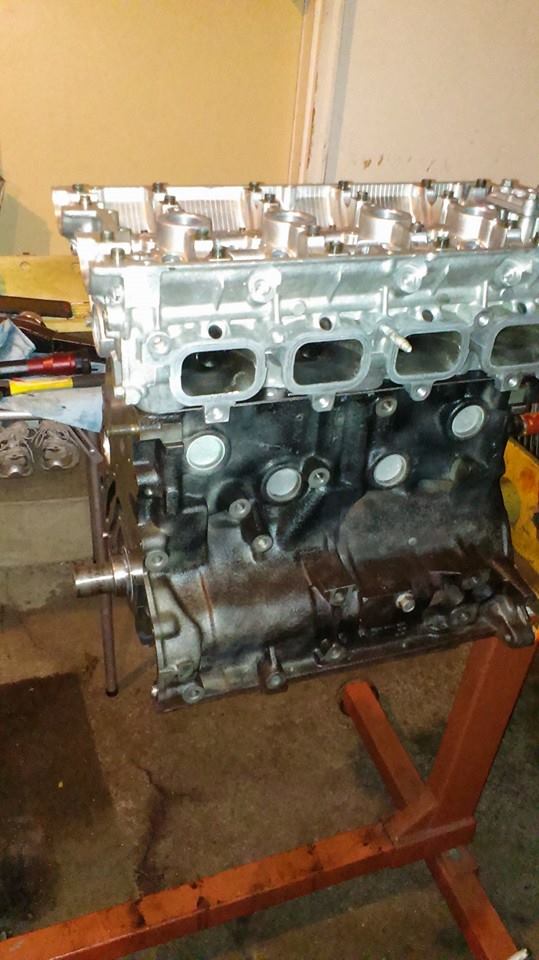

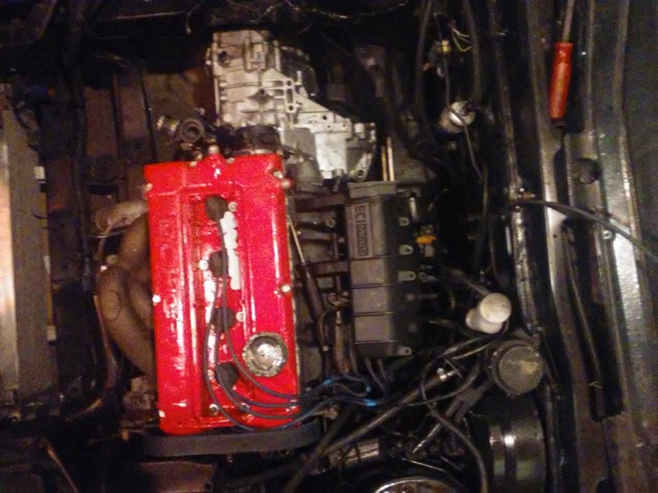

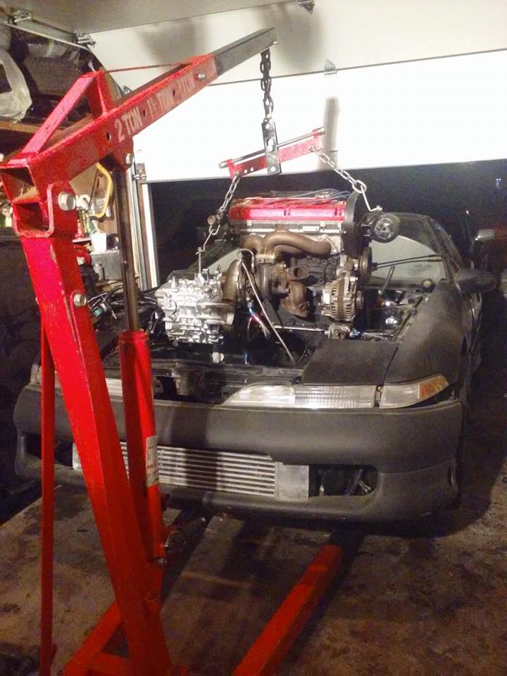

Zomby Bump...Bring the Talon back from the dead! Looks like its been a while since i have updated my project thread. Not much has changed but a few things have changed like...
I have a mildly build short block in comparison to the GREAT :P ! Now forged rod's forged pistons....my head has springs and retainers and 280 camms...rocking 1450cc injectors....Got my PTE ported...FP Race manifold ported...and a couple other things here and there....Just some random improvements.
Future Plans,Goals & Dreams:
-Brake in the new Assembled engine sometime tonight when the streets are empty.
-Put a few successful miles on the car get it ready for a tune
-Wire tuck my harness ( ITS A DISASTER)
-Put it away into storage untill temps warm up and occasionally work on it here and there
-Make it to the Race Track and run some decent times mid 11's with the ideal goal of 10.9
-Find a shell worth the new engine tranny combo
-Upgrade ECM Link V3 To full
-HX40 TURBO UPGRADE OR A 62 SERIES
*A lot of things as usually are pending funds
I want to give a big big BIGGGGGGGG SHOUT OUT TO ONE OF OUR BEST MEMBERS JOHN PUSH IT 2.0 FOR SPEER HEADING THE RESURRECTION OF MY CAR THANKS MAN! TAKES A HUMBLE INDIVIDUAL TO ANSWER ALL MY QUESTIONS RESPOND AT ALL TIMES OF THE NIGHT HAHA!
*@John for sure get that Moon Taxi for some laughs and giggle cruises through DOWNTOWN, YES SIR!
*Sorry for the terrible pictures, ill get better ones as time goes lol!
