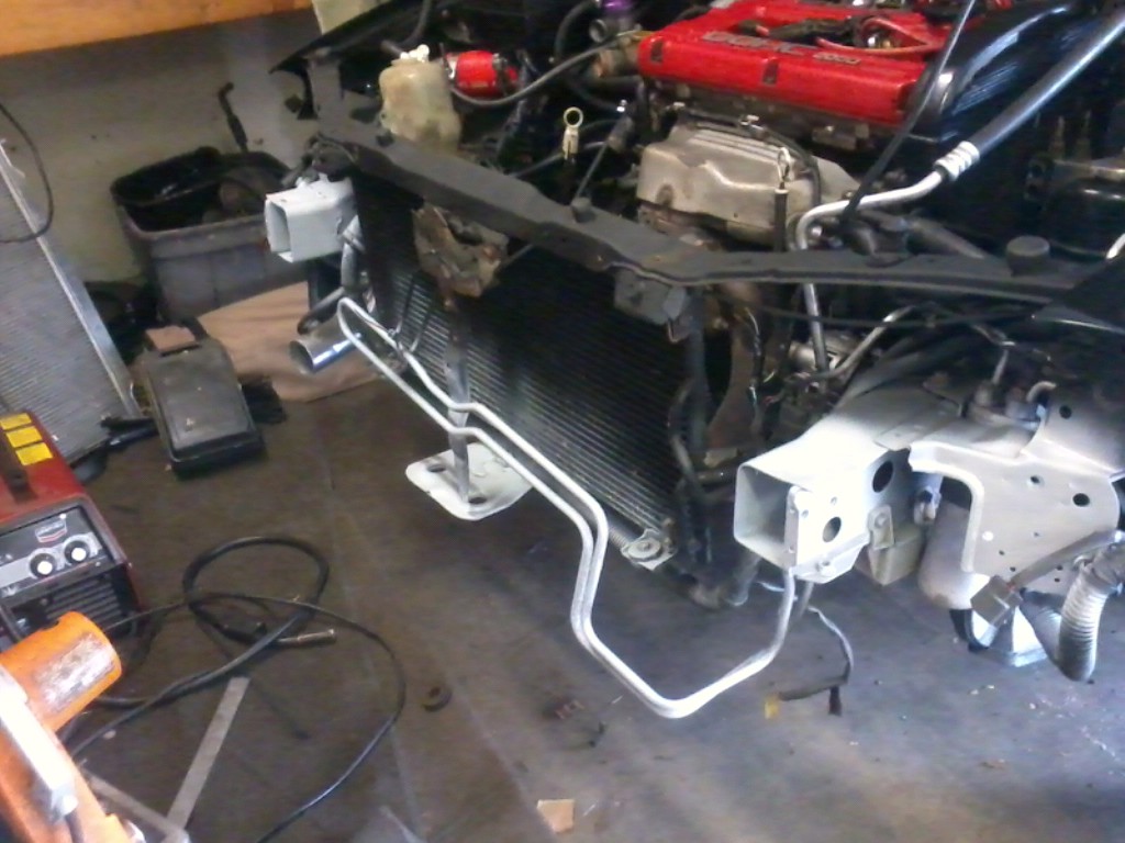

Picture 6 explains to me why you tackled this project!
Yeah it had previously been reinforced by a piece of angle iron but it was still pretty sketchy. I could have riped the drivers side radiator mount off with my hand. even with it only being tacked in place the radiator was way more solid then before.

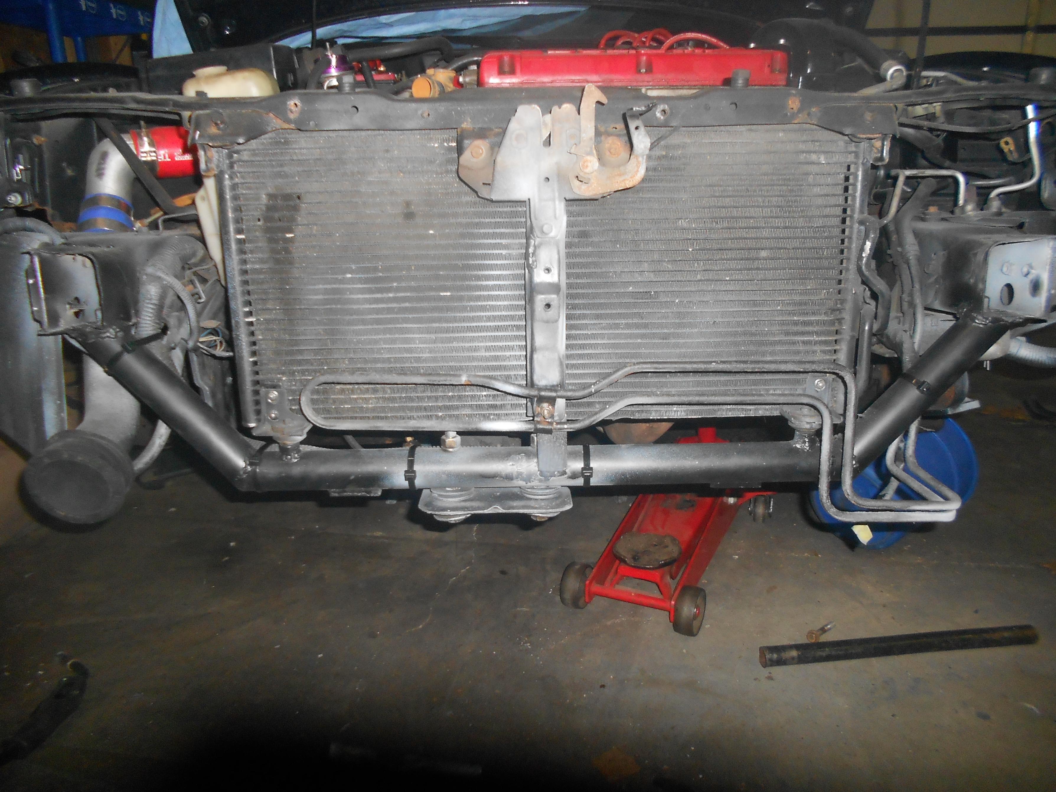

I got the core support welded this weekend and took advantage of the warm weather today to paint it before welding it onto the car. I also repainted the front of the fraimrails while the front was taken apart. I will hopefully be welding it up to the framerails tomarrow. onto the pics.

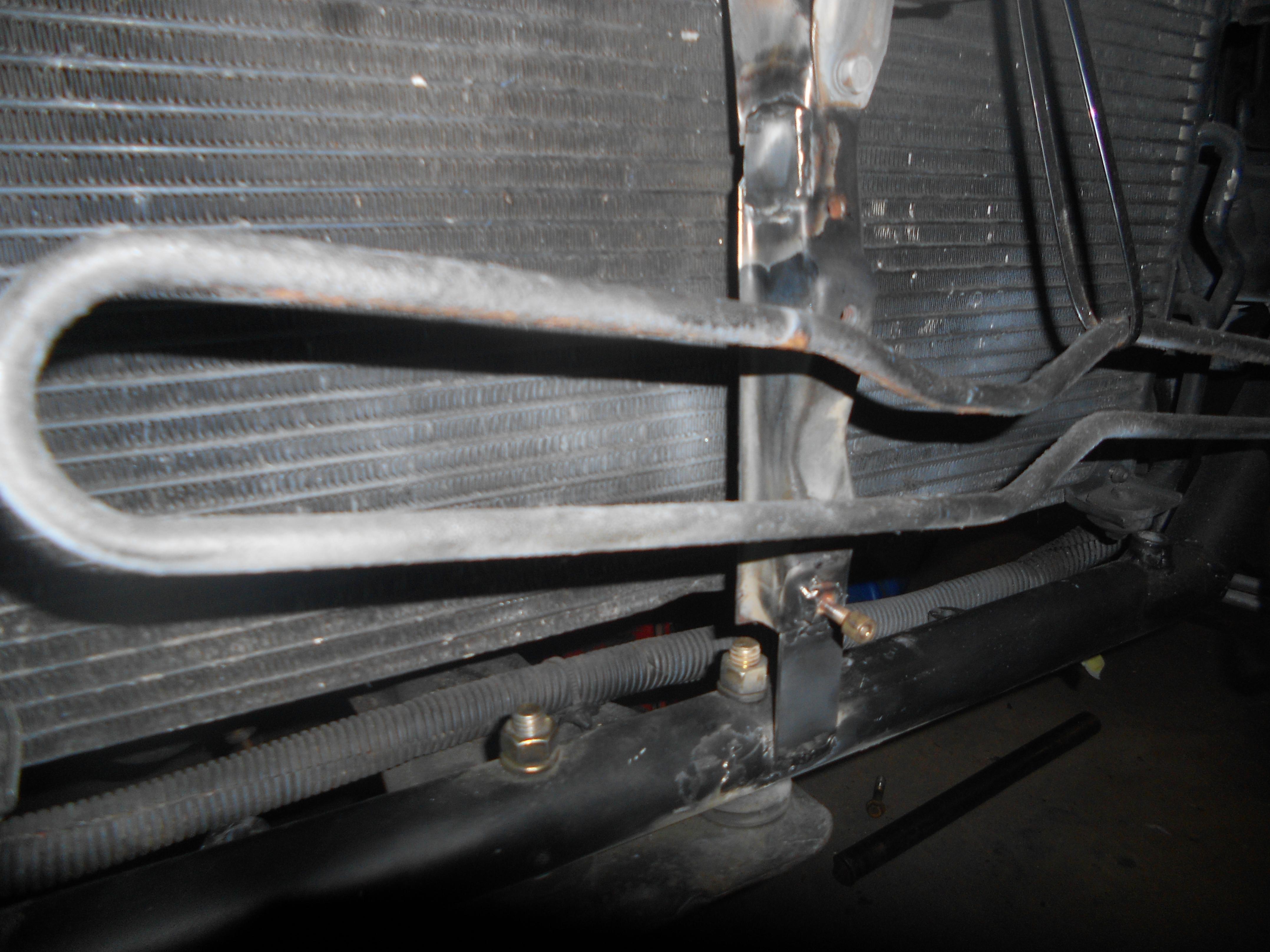

The core suport is now fully welded in. Welding it to the frame rails went pretty good except for a few burns on my arms because I had to lay completley under the car to weld the back sides. I think I need to add a pair of good welding leathers to my X-mas list. Welding the hood latch suport was a little tricky. it was pretty rusty and crusty at the bottom so it just wanted to burn away. I also had to get the hight and angle just right so the hood would line up properly. I ended up notching it at the top and adding a piece of flat steel to reinforce it, I then cut 2 inches off the bottom to get to some weldable steel and added some more flat stock to get it to the tubular support. I finished off by zip-tieing the wireing harness to the support. I test fit the radiator and it fits great.

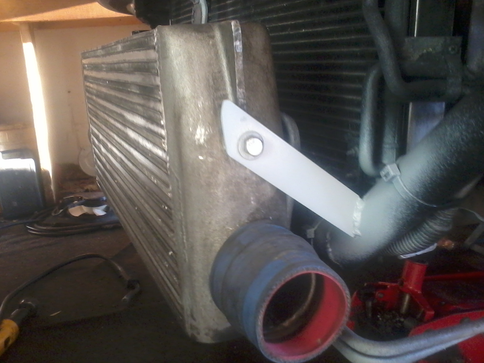

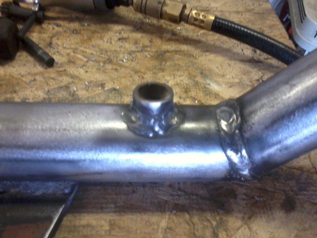

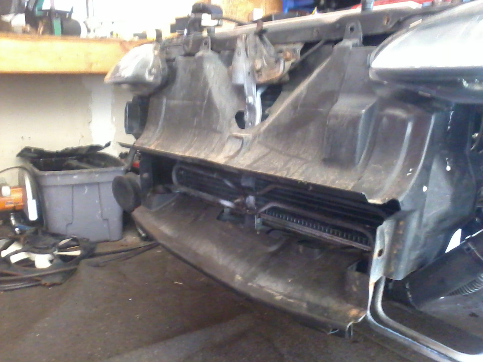

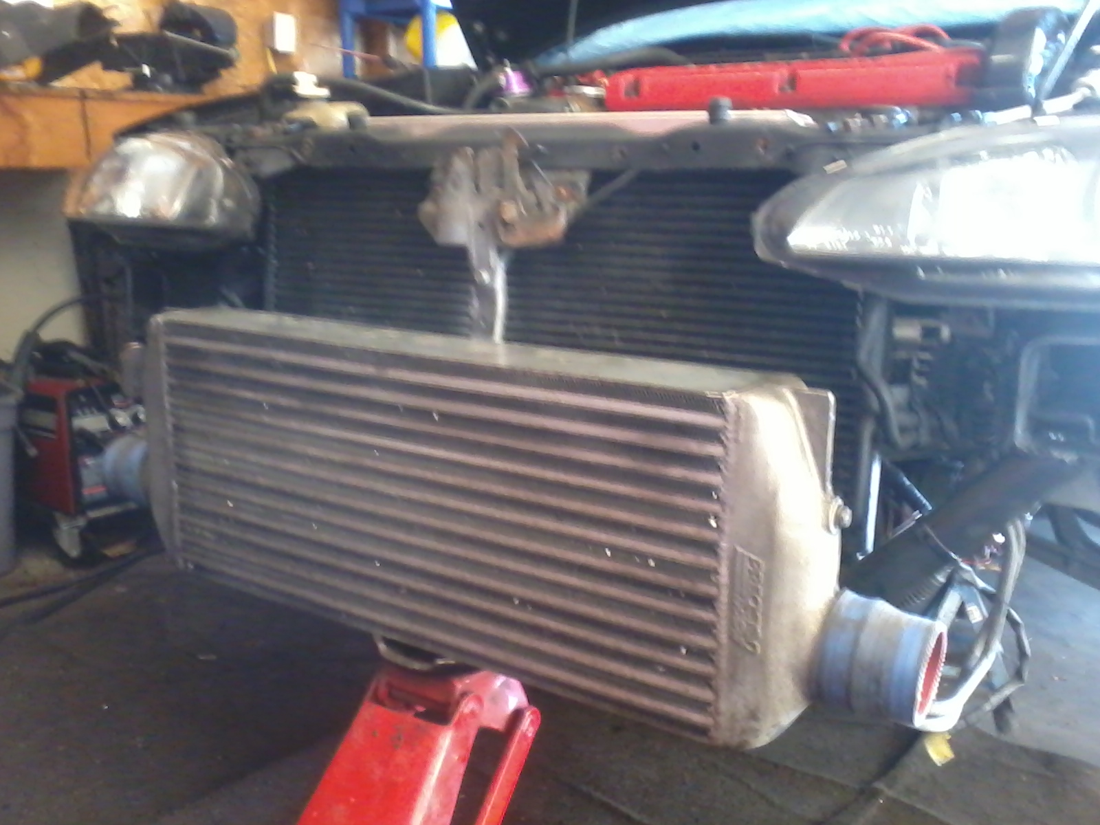

I picked up a Precision 750HP intercooler today off of Craigslist. Its a little dirty but in good shape. I welded mounts off the tubular core support. It is nice and solid and the pipeing I have will hook right up. I also got the stock radiator ducting from the parts car I picked up and modified it to work with the new FMIC.
