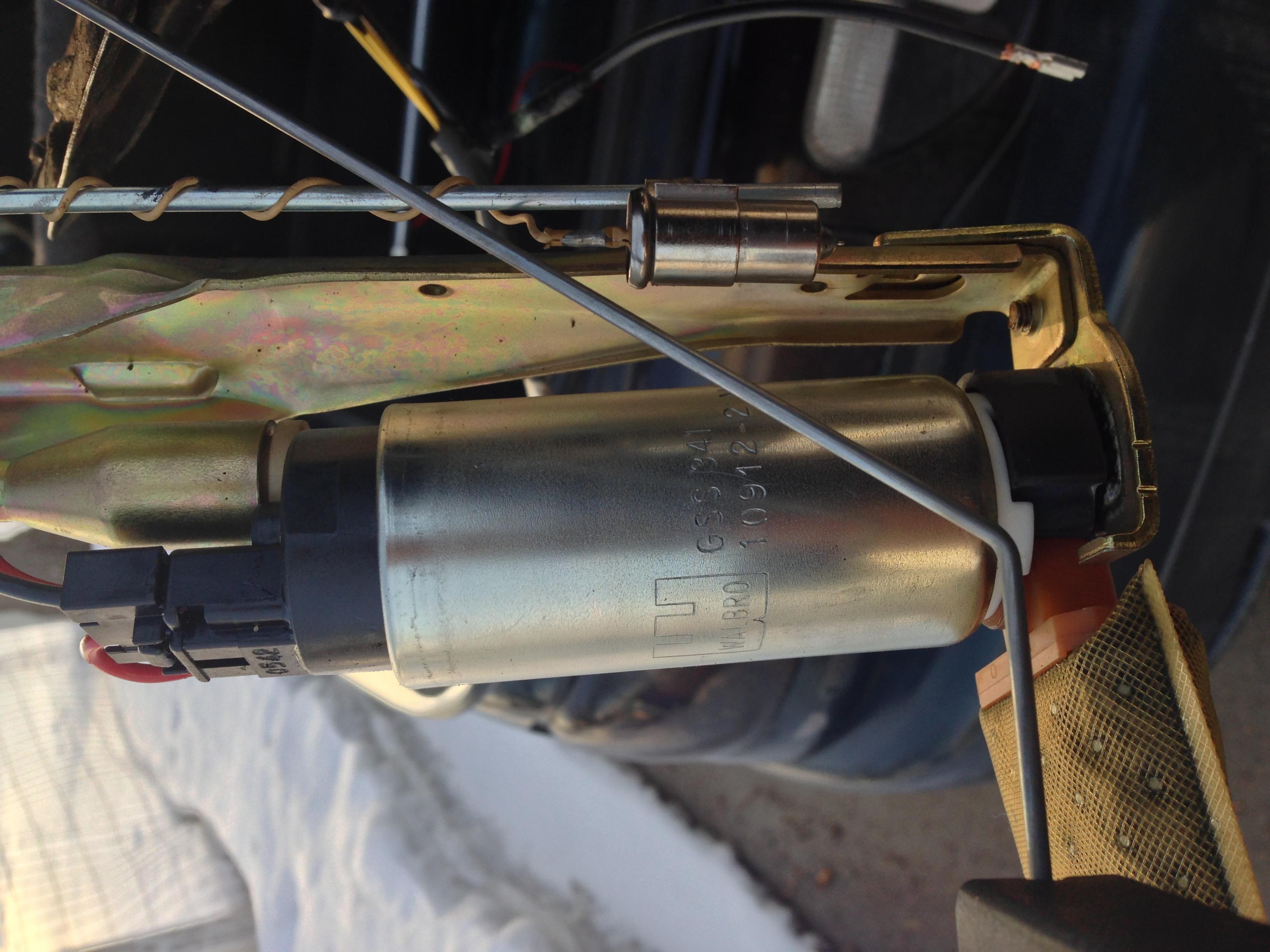

Got the new walbro installed after work today.
