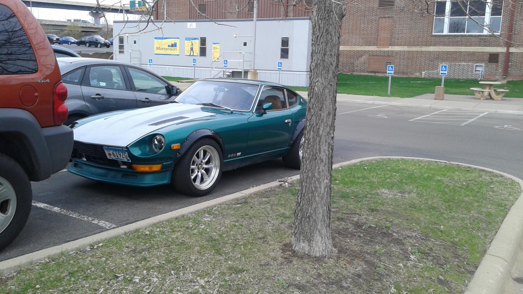

I recently bought a really nice 260z, that already has a SBC and automatic. Swap was done sometime in the 90's and apparently saw nearly no miles after it was done. Not enough miles for either of the 2 previous owners to be bothered to get the right combo of drive gears to correct the speedo, for example. When I bought it, the tires were from 1992.
Album: http://imgur.com/a/ic8Bx#tokFrVf
The car is really in amazing shape. There's one small spot underneath starting to rust. The hatch, battery tray, tool/spare wells, fenders, hood, are all pristine. It still has what I can only assume is the OEM spare with a date code of 473 which I assume corresponds to 47th week of 73. It also came with the OEM manual, window sticker, radio guide, tool kit, jack and wheel chocks. The electric rear defrost, map light, and motor to raise/lower the antenna work. The light under the hood still works, too. Brake pads/shoes were replaced last year.
