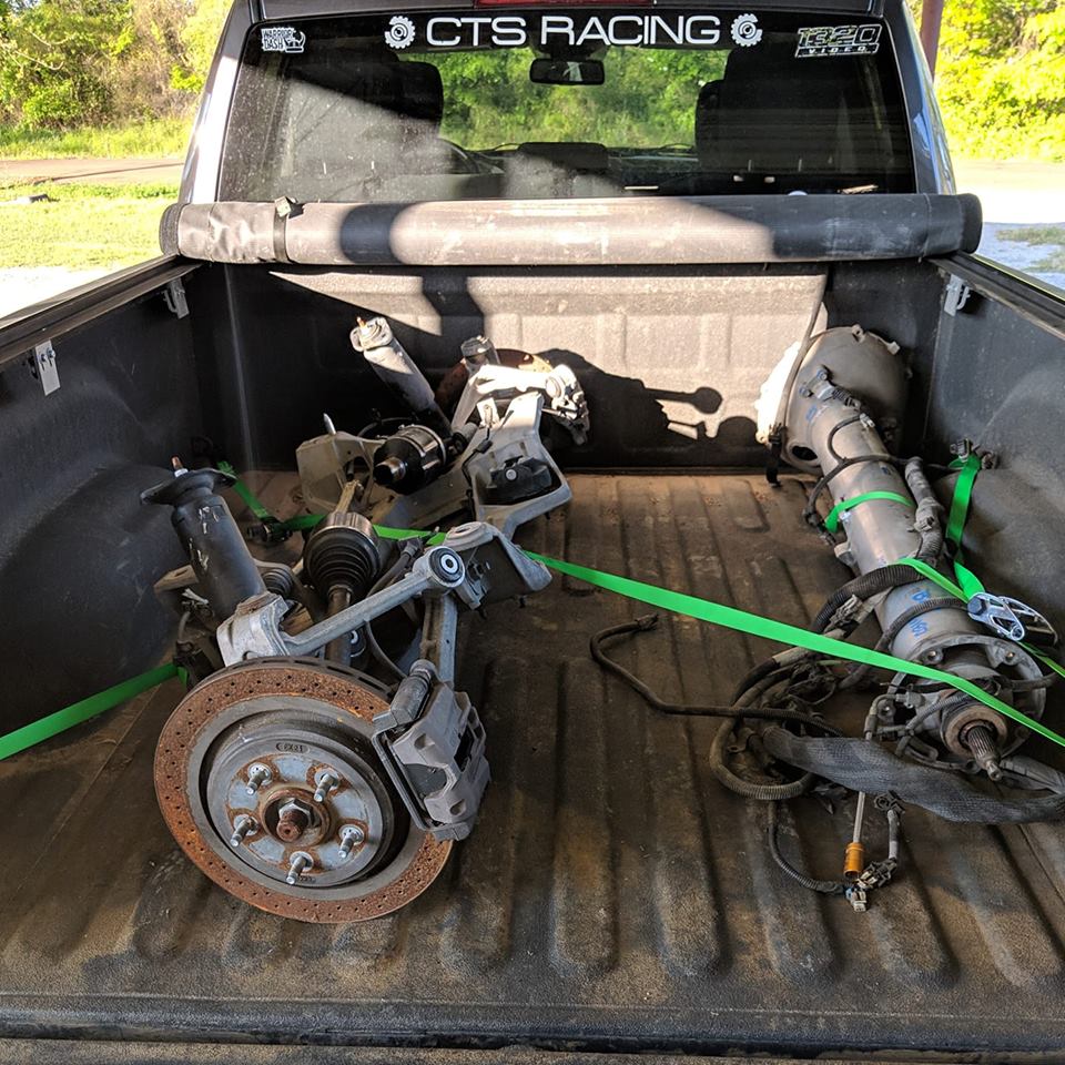

Picked up some goodies yesterday.
2007 Corvette Z51 full rear cradle. I'll be selling what I don't need off this. A 2009+ is ideal but I can tweak this a bit to fit the differential setup.
Also pictured is the 12mm Torque tube that is an upgrade.
Today I ordered the conversion "kit", includes TR6060 lines, differential/transmission mounts, and new diff cover to eliminate the heat sink.
Working on securing a differential and probably ordering a new transmission. Then should be set to assembly later in April.

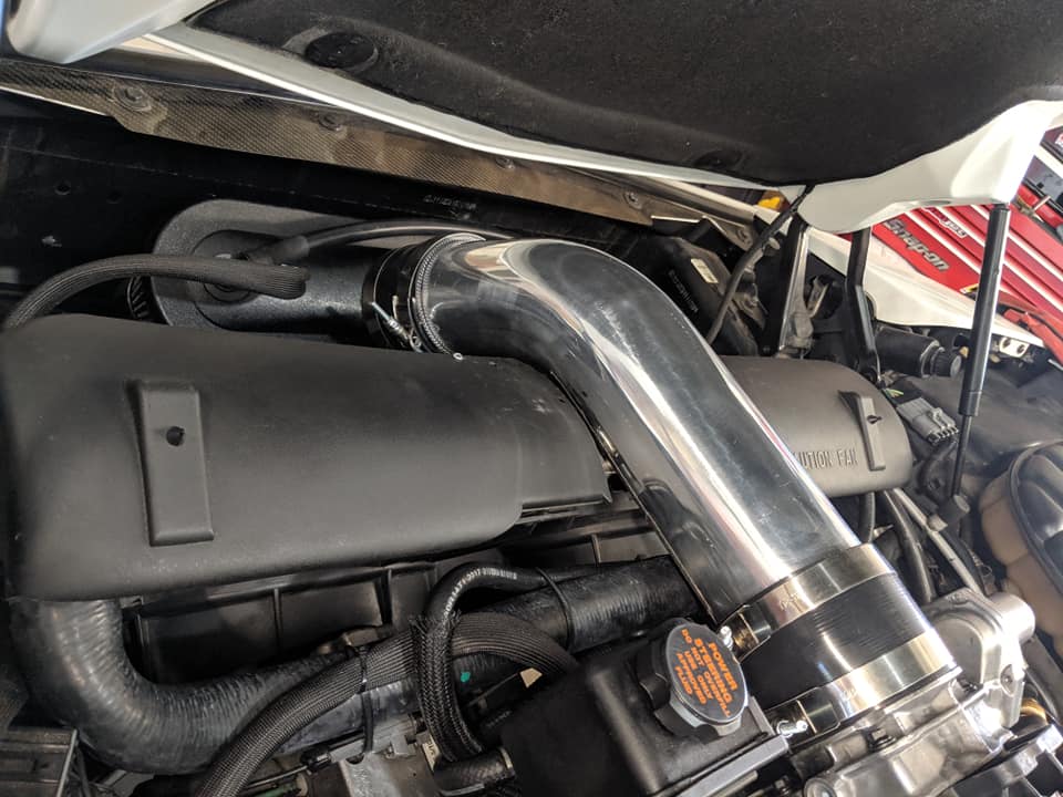

I swapped in a brand new TR6060 out of a 09+ Spec Z06 and a 07 Z06 differential. With this swap came in a C6 rear Cradle, C6 Lower control arms, ECS Transmission/differential brace and torque tube tamer. I also put in energy suspension bushings in all components in the rear.
While I was there I upgraded to a 12MM torque tube with Driveshaft Shop Poly couplers, new bearings, and ARP Hardware.

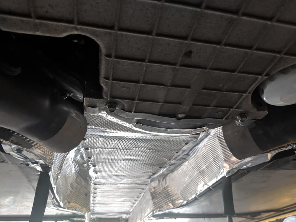

While reviewing the car and looking it over, I realized I dyno'd on stock plugs and they were cooked. I swapped in TR6 plugs (1 range colder) and sent my throttle body out to Tony Mamo for a port job. Also had my shifter box rebuilt as well and diy'd a 4" intake.
The headers did not fit well with the 6 bolt heads as they kept hitting the flanges, so I decided to go with Hinson Supercar 1-7/8" catless headers. That means I pulled emissions out. The emissions delete and the intake modifications dropped 8lbs off the nose of the car. Also they sound pretty good (youtube video of start up below) Finally I DEI wrapped the crap out of everything, including my mini starter.

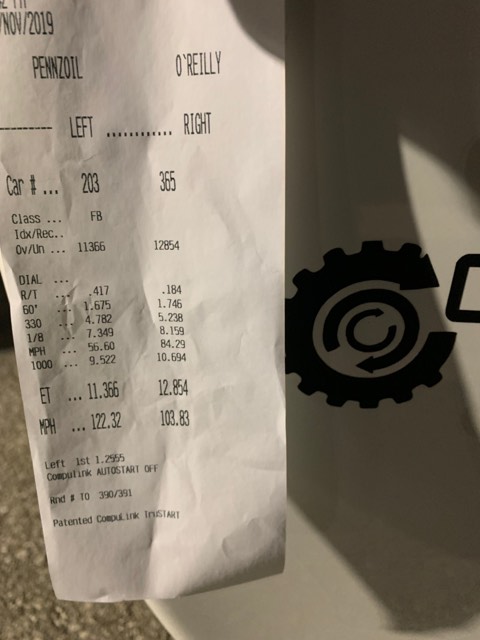

Went to the track Friday night. 11.3 was on the second of 3 hits.
Still learning to launch on this setup. Here is the youtube video:
https://youtu.be/f4l5zC0Bn3o
1.67 60', I think it has a 1.5 in it with more practice. Tire setup is Hoosier Quick Time Pro's 16x9.5x26" on Camaro 16x8 wheels. 17x4.5 M&H skinny setup on the front. I was running 21psi hot, so more to go!
Goal still stands of 10.99 on the motor.

First hit was a 1.9 60' bog, 11.9@119
2nd was the 1.67 60', to much clutch slip, 11.3@122.
3rd and final was a 1.8 60' hop, peddle, recover, 11.7@119.

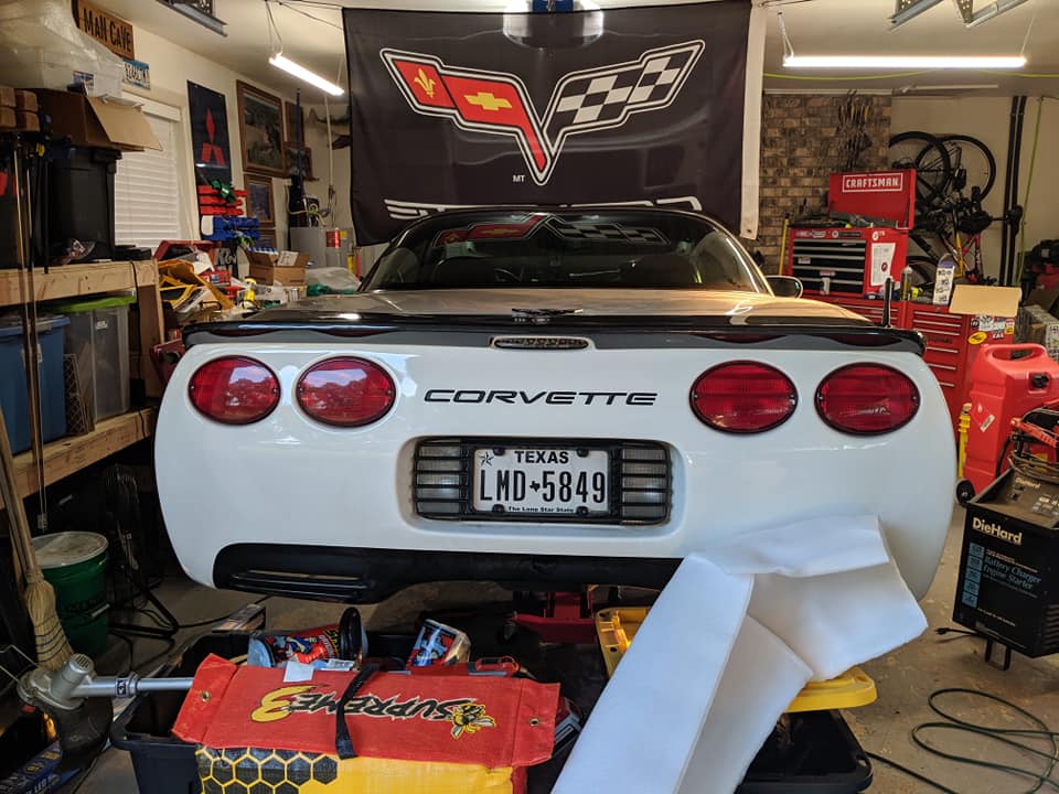

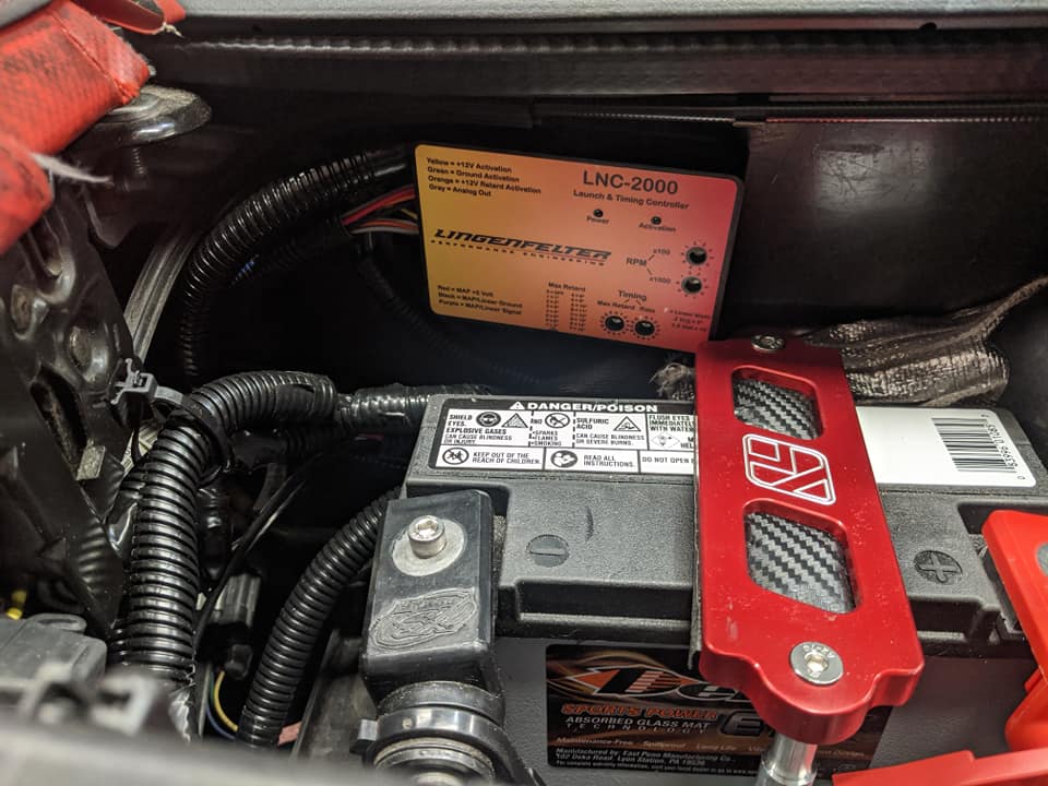

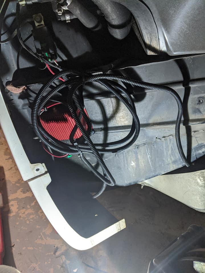

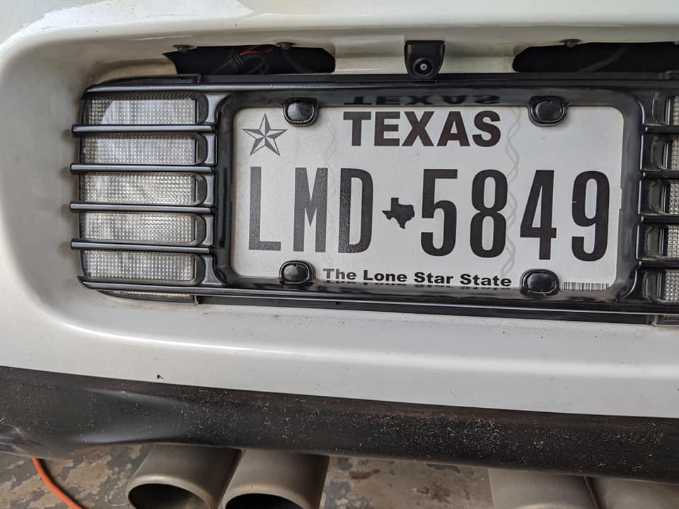

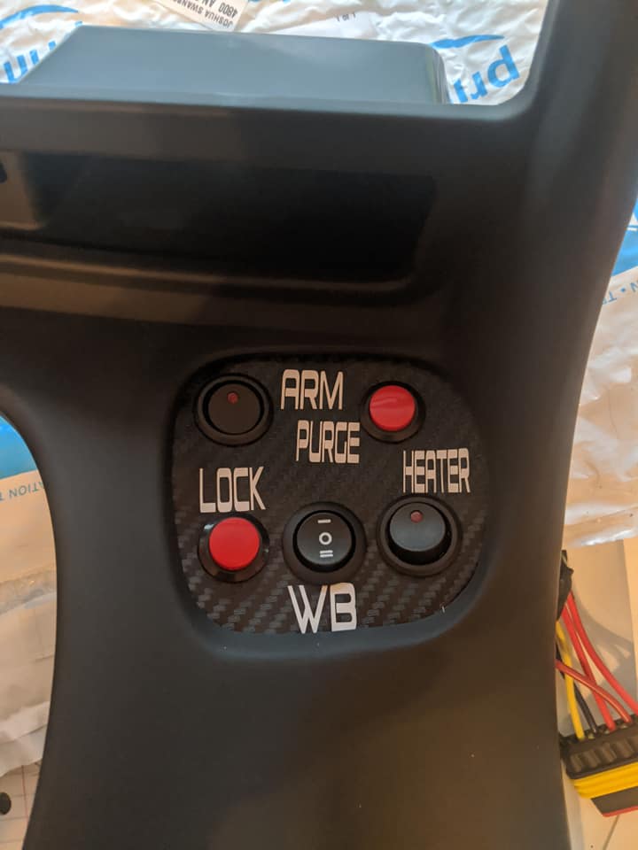

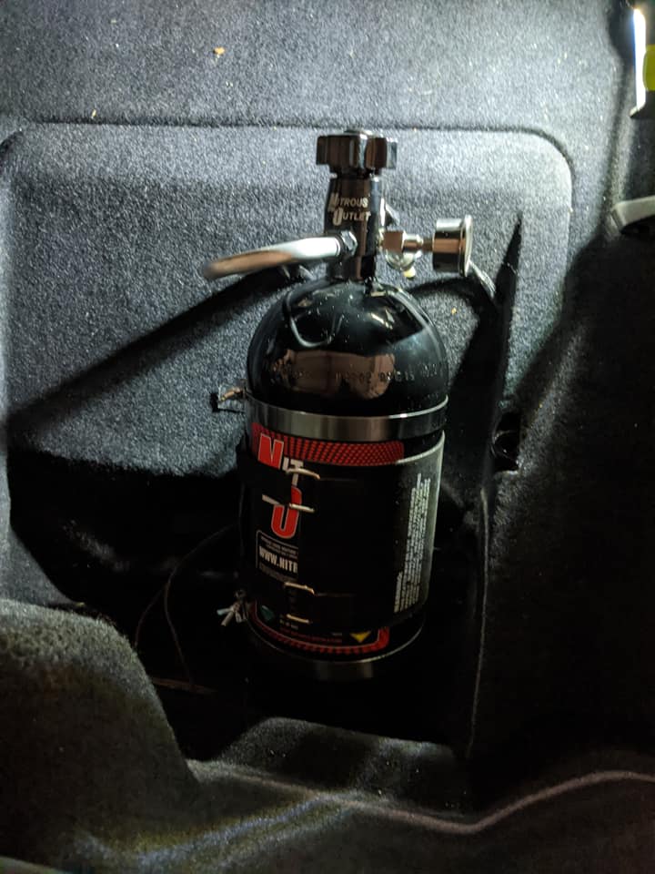

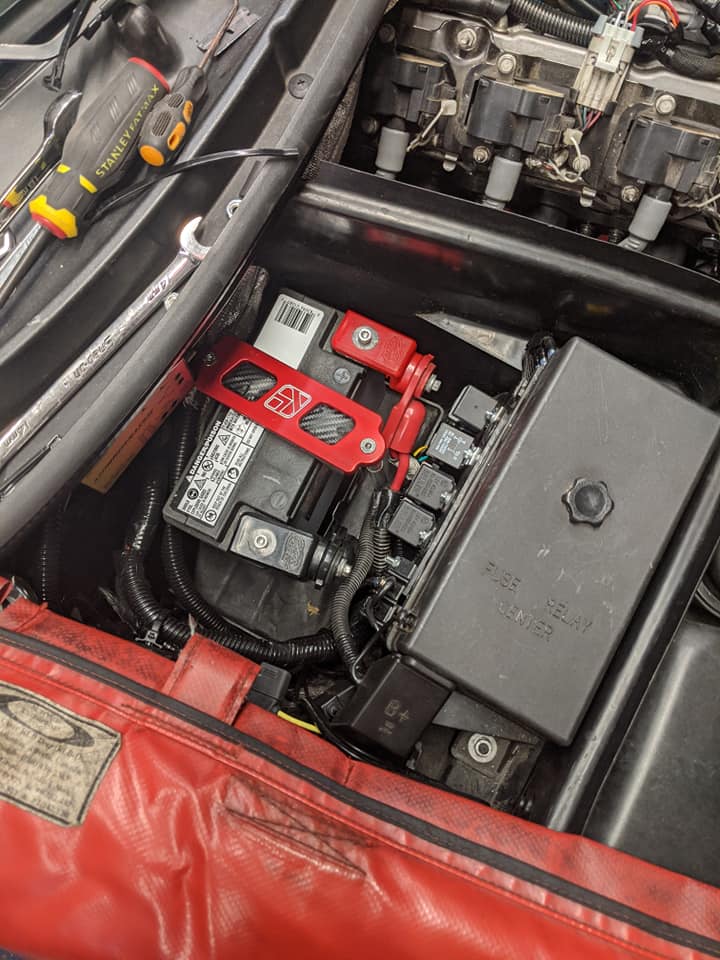

Been making progress. Of course nothing goes as fast as you want it to.

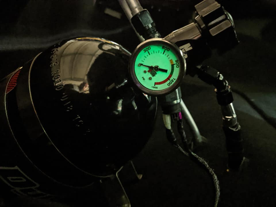

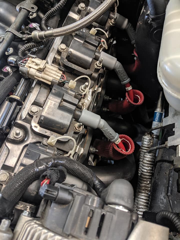

Installed the LineLock, Nitrous system, and LNC-2000 timing controller and 2 step with a lighter battery (should offset the weight of the nitrous kit)

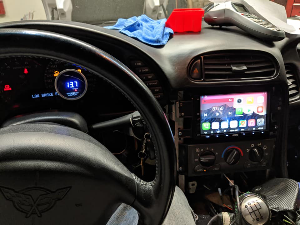

Also installed a backup camera, Dual Din radio setup (went with the ATO A6, not the amazon fire pad), wideband gauge (14point7, with switch reads both banks), and switches to control it all. Finally I added a hardwire kit to the fuel pump and a boost a pump.

Hoping for that 10.999 off the bottle and maybe a 10.5 with a little oxygen assistance.
Name:	wideband and dual din in progress.jpg
ID:	17377   Click image for larger version
ID:	17378   Click image for larger version
Name:	nitrous bottle gauge.jpg
Name:	nitrous bottle mounted.jpg
ID:	17380   Click image for larger version
ID:	17381   Click image for larger version
Name:	mini battery and lnc2000.jpg
Name:	mini battery nitrous wiring.jpg
ID:	17383   Click image for larger version
Name:	rear backup camera.jpg

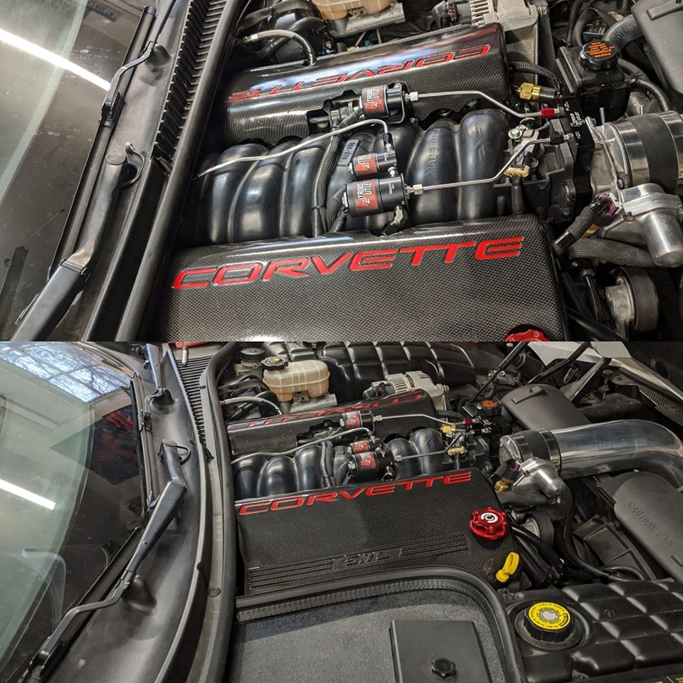

Fuel rail covers are back on and fit after some massaging. Need to do some wet standing and touch up some clear on the edges, but they should work.
Ready to serve up some 1/2 price apps at Gapplebees.
