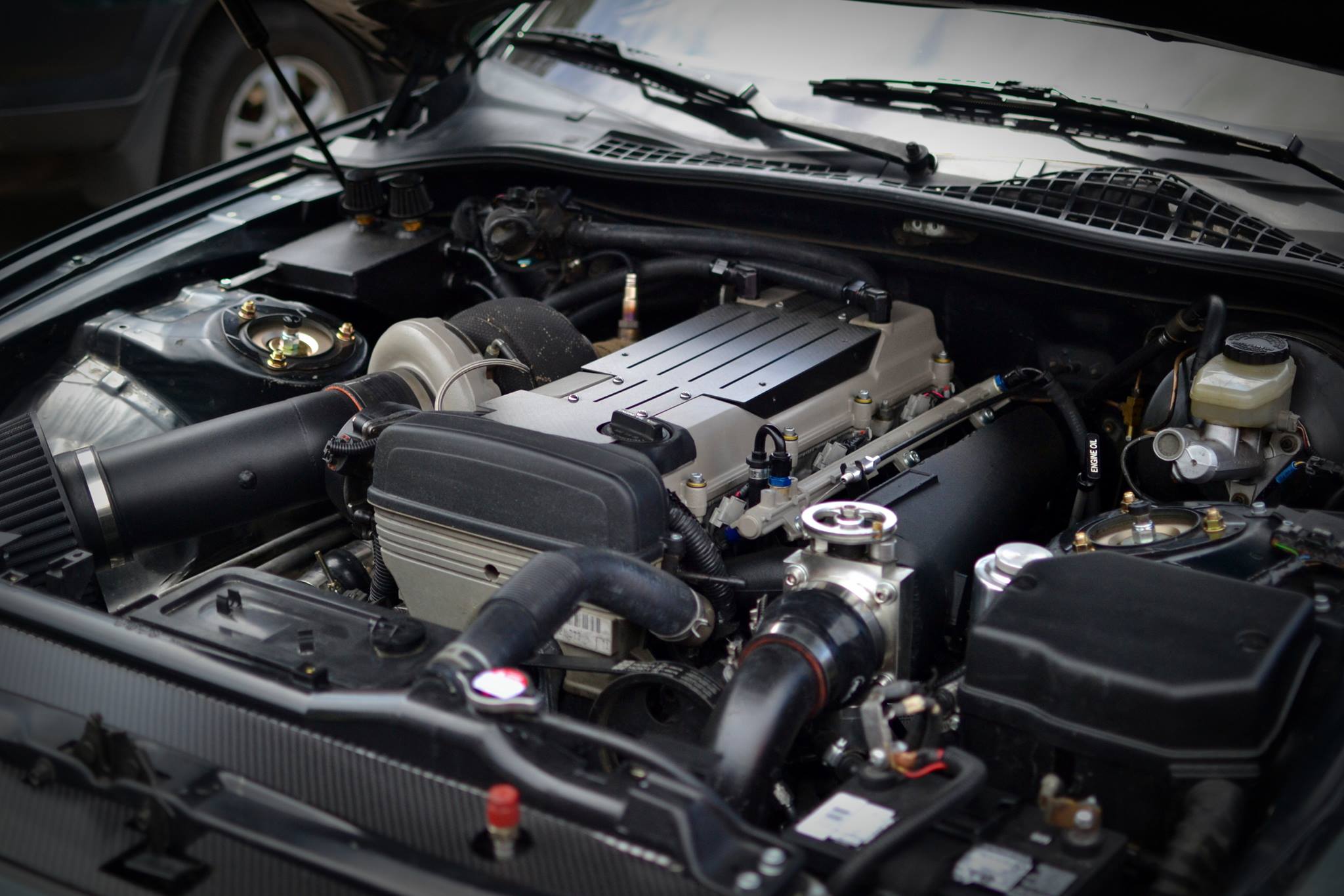

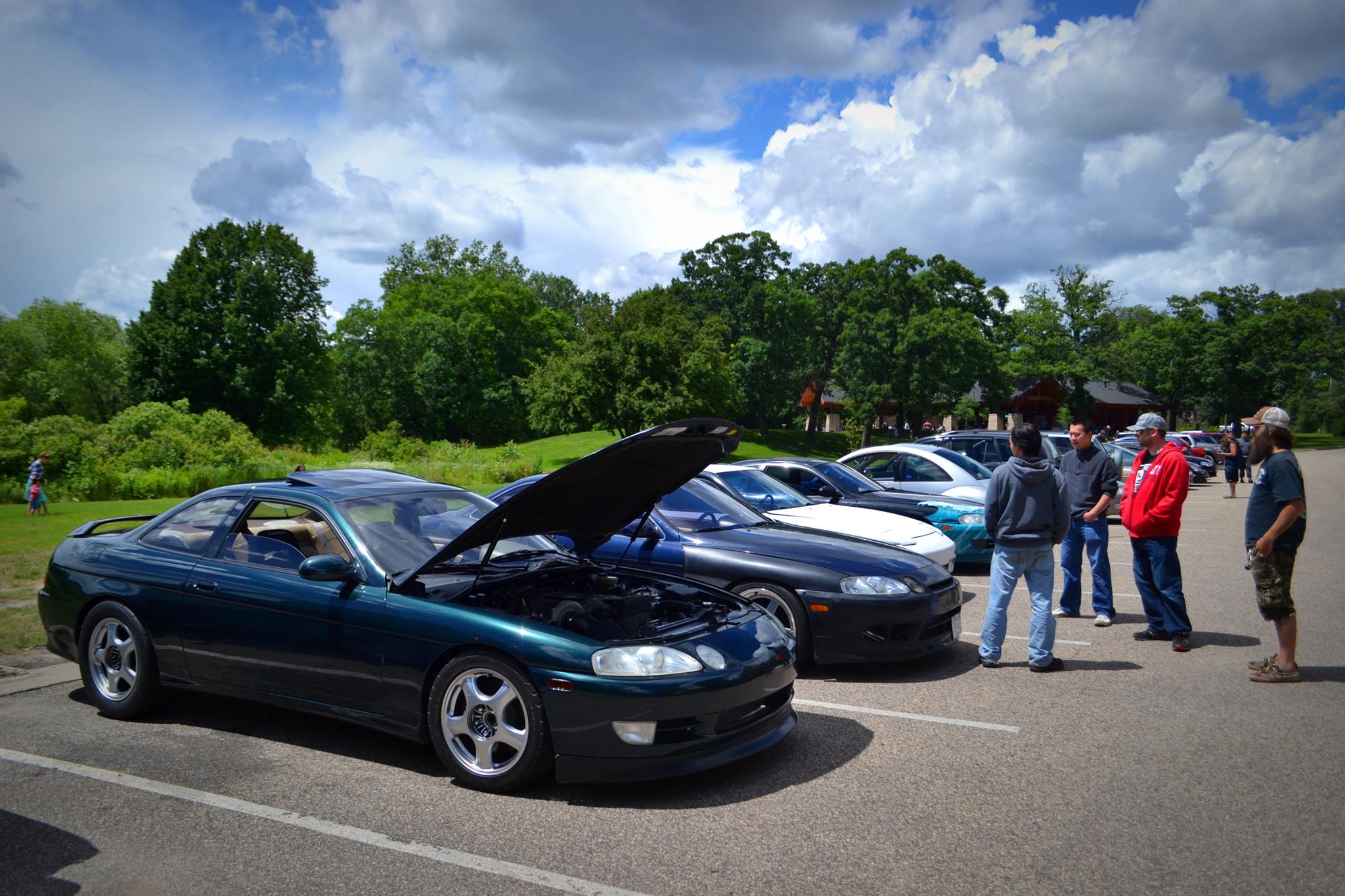

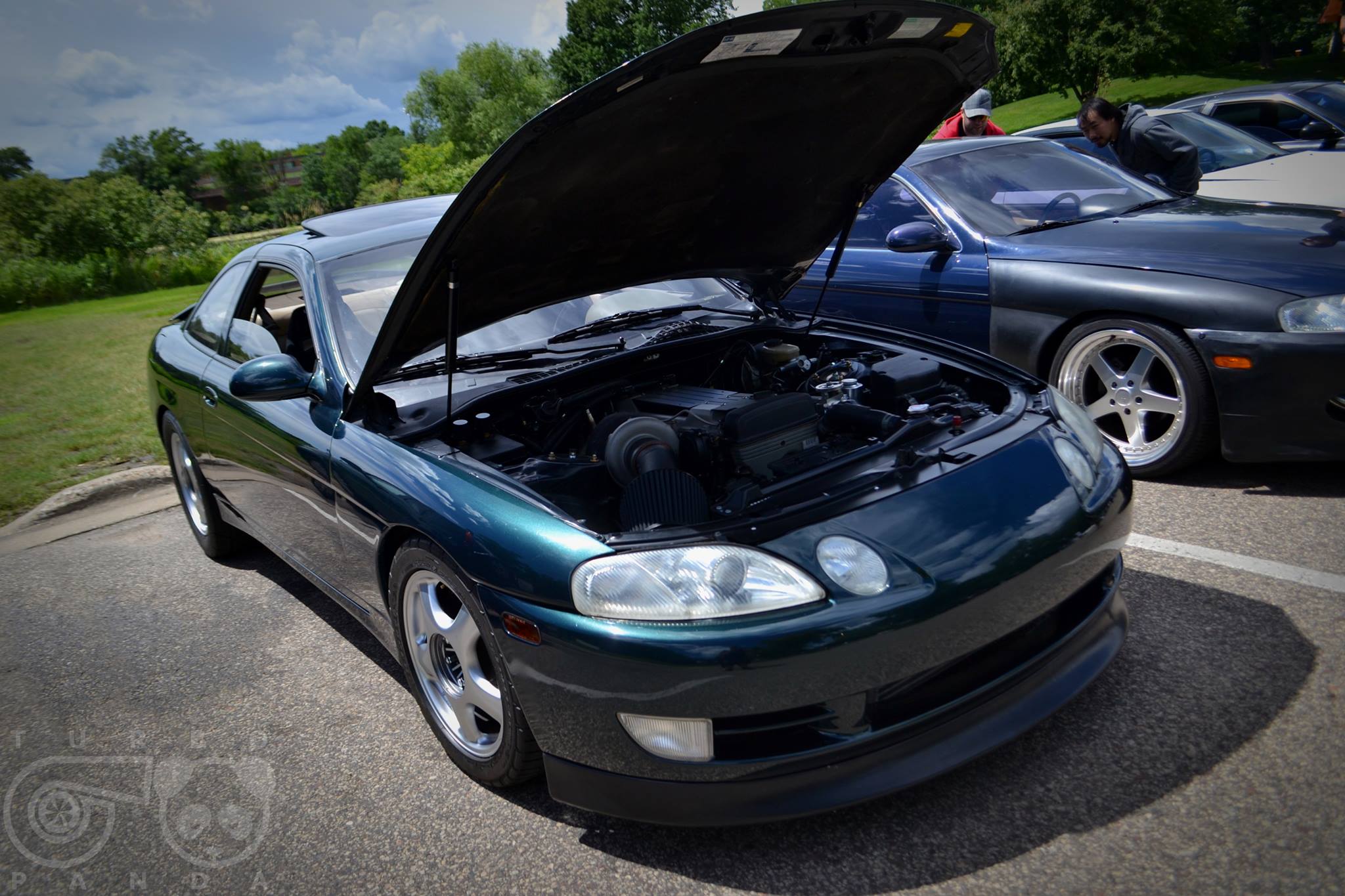

Some pics of the car from our Lexus/Toyota/Scion meet we had on Saturday.

Car looks clean, very nice!
