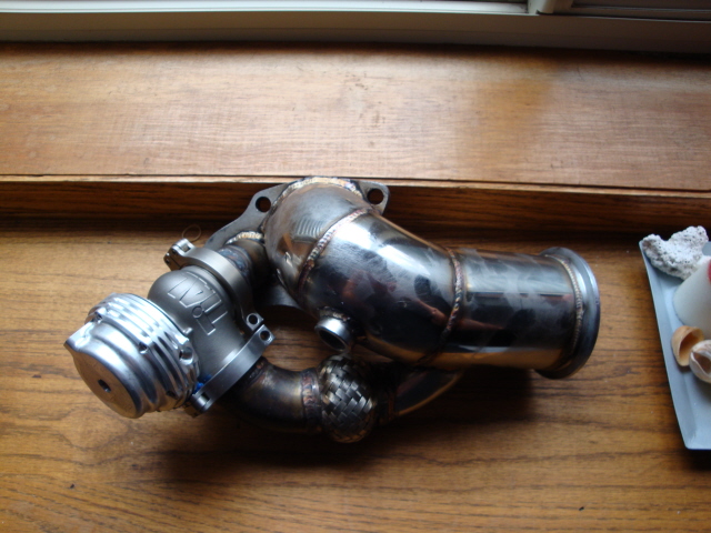

Some pics of my new o2 housing that I had vbands welded on.

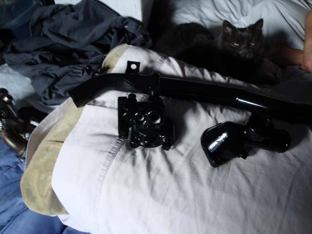

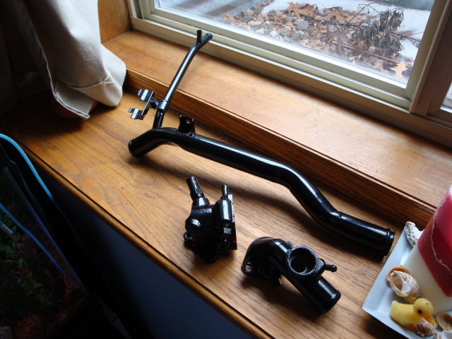

Some coolant parts I had powder coated, the 90 N/T thermostat housing and waterpipe (I had to dent the pipe a bit to clear my turbo's compressor cover).
That's the new Tial MS-V 38mm vband wastegate

Why do you have a flex pipe on the wg?
Old 02-18-2009   #147
Re: My Talon
I'd assume because it's a V-Band connection and it's nice to have a little flexibility in there for ease of installation. Mine is all solid with now flex, but a small flex in there would make install a hair easier.

Why do I see a black cat in one of those pics, Is that one of karas cats or did you dye twinke black. your setup is going to look nice.

This is a made-in-china special from ebay ($95 shipped). I had my friends at Primo chop of the wastegate flanges it came with, and weld on my v-bands for my Tial.
This o2 housing is way closer matching than my old ebay 2.5" wastgate, it's not perfect but its a significant difference.

I didn't put it there, someone in China did.
It's nice because that little flex (it's really not flexible at all) helps getting the wastegate on and off.

Haha that's Kara's cat, Gizmo.

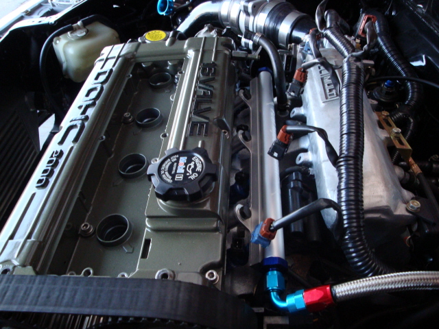

Some progress pics: I installed my Bluemax injectors and fuel rail both from FIC!
Also put on my powdercoated N/T waterpipe and thermostat housing, a Mitsubishi thermostat kit and radiator cap.
