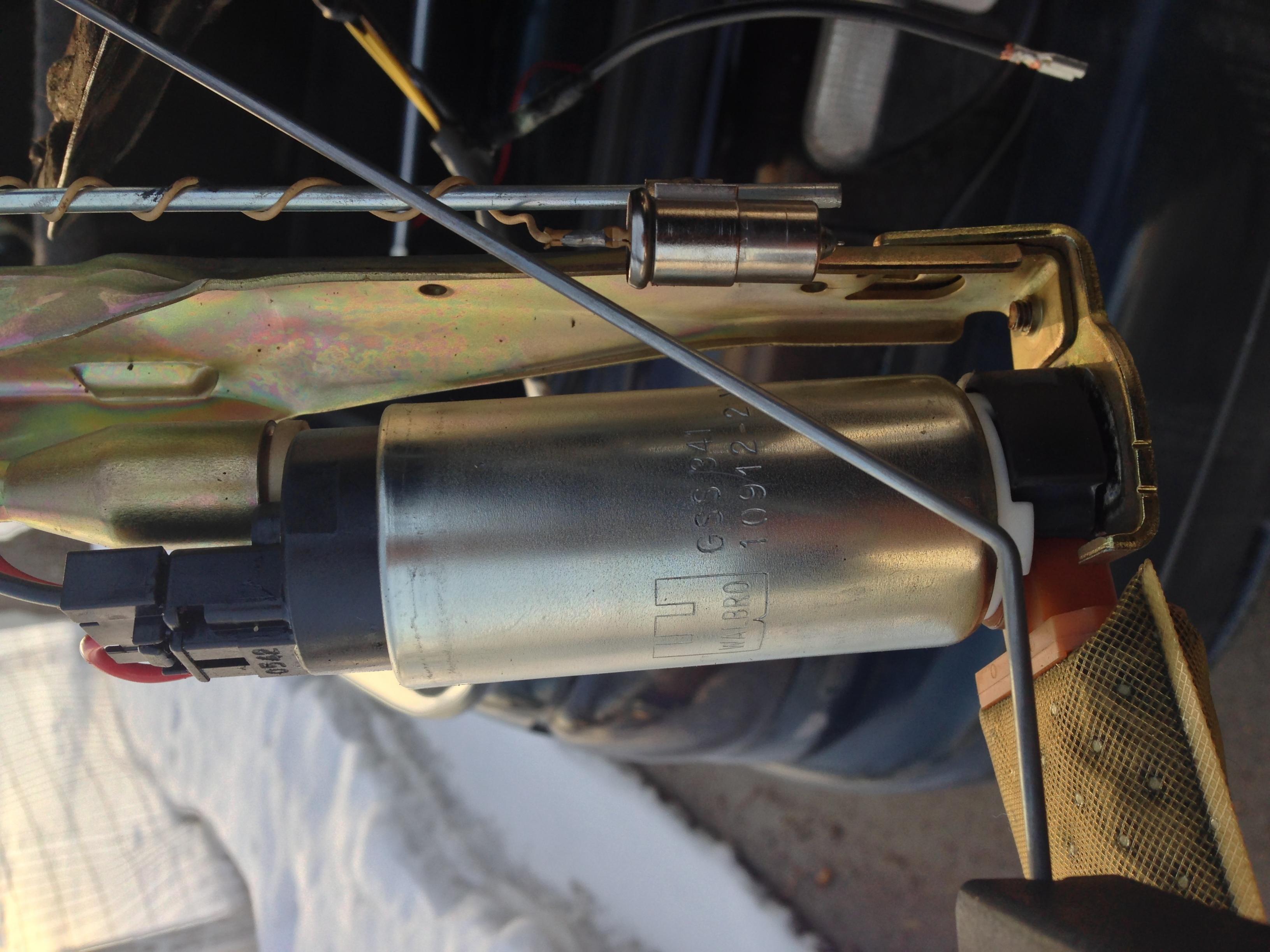

Well, today I pulled the fuel pump to do a complete rewire. I found a Walbro 190 not a 255 like I thought I had in the tank. So I put the rewire on hold until I pick up a new pump.

Got the new walbro installed after work today.
Hah wow, wonder if that's the one I installed way back when. I didn't go with a full 255 because it wasn't a race car (LOL) and I wanted to keep it simple on the street.
Yeah not sure, oh well. Glad I handle this before going in for a tune. It was pretty loud and since I was told it was a 255 I never questioned it. But I can't believe I didn't do this earlier, especially the rewire.

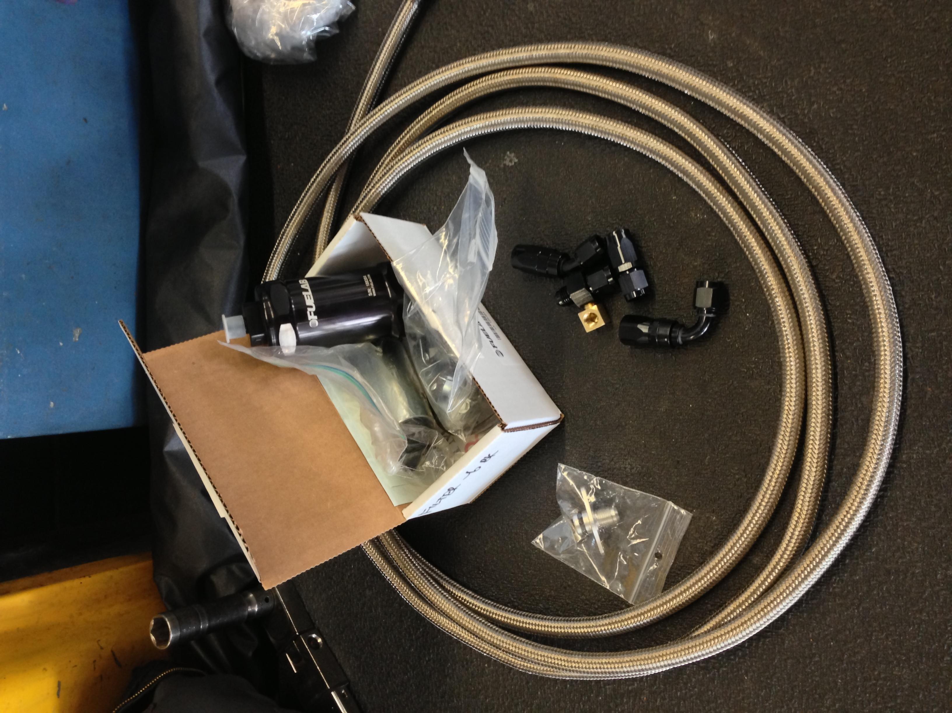

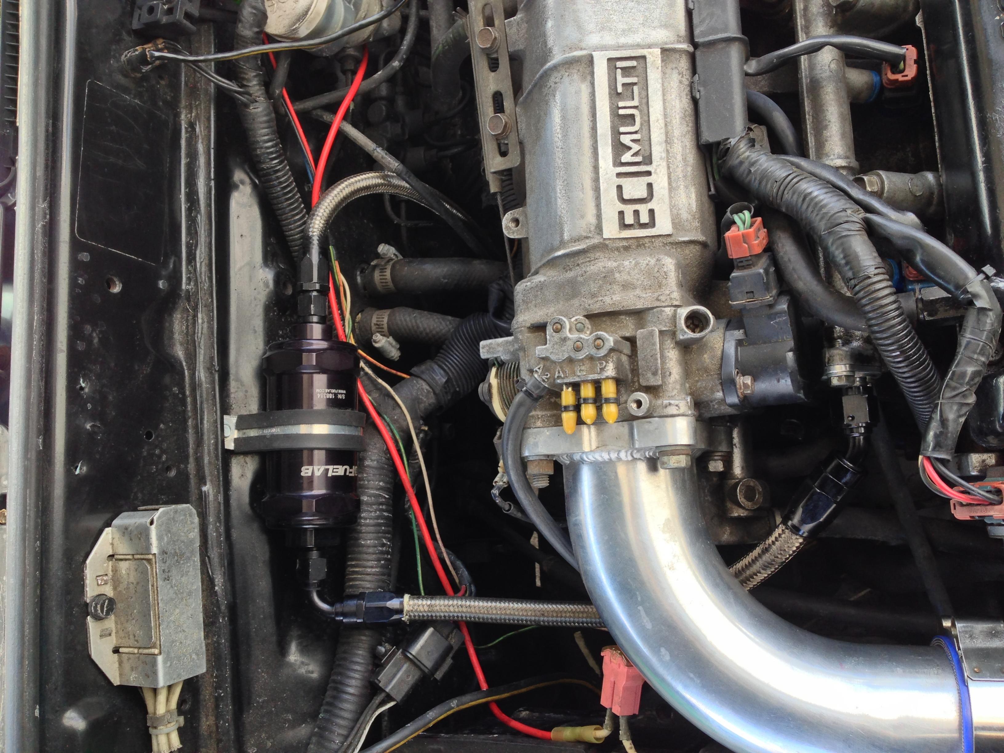

Installed braided stainless fuel line from the tank to the rail with -6an fittings and a fuelab filter today. Ill get more pics up later.

Old 03-16-2013   #153
Re: 1g 6 bolt 4g63 tsi build
Why the line from tank to rail?
Old 03-16-2013   #154
dsmghost
dsmghost's Avatar
Join Date: Nov 2011
Location: South Minneapolis
Drives: 1gb Talon TSi AWD
Posts: 525
Since I've started driving the car there has always been a fuel smell but no major fuel leaks. I finally got around to fixing it, it turned out I had a few issues. The sending unit had no gasket and half the studs on top are broken off. Also, the hose section was seeping at the crimps. I decided to just replace it all and make it look better too.
Old 03-17-2013   #155
Ah, good call. Yea when the car got parted I didn't recall what pump went back in. I thought I had a 255 before I went to the double pumped setup? When parting a car, fixing bad gaskets and such aren't really top priorities, I just wanted to get rid of everything.
Anyways, glad you got it all sorted out and are doing things the right way! This thing is def headed in the right direction.

Pic of the new fuel line/ filter, today ill be installing a prosport fuel pressure gauge, and a prosport egt gauge. Ill post pics after install.
I don't get why these pics keep loading sideways.

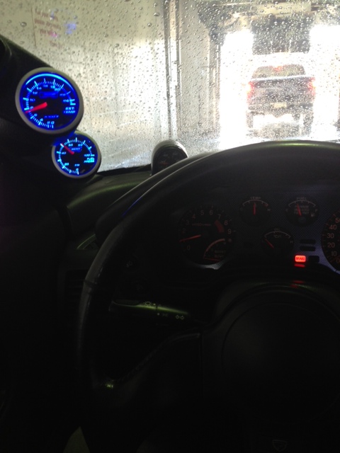

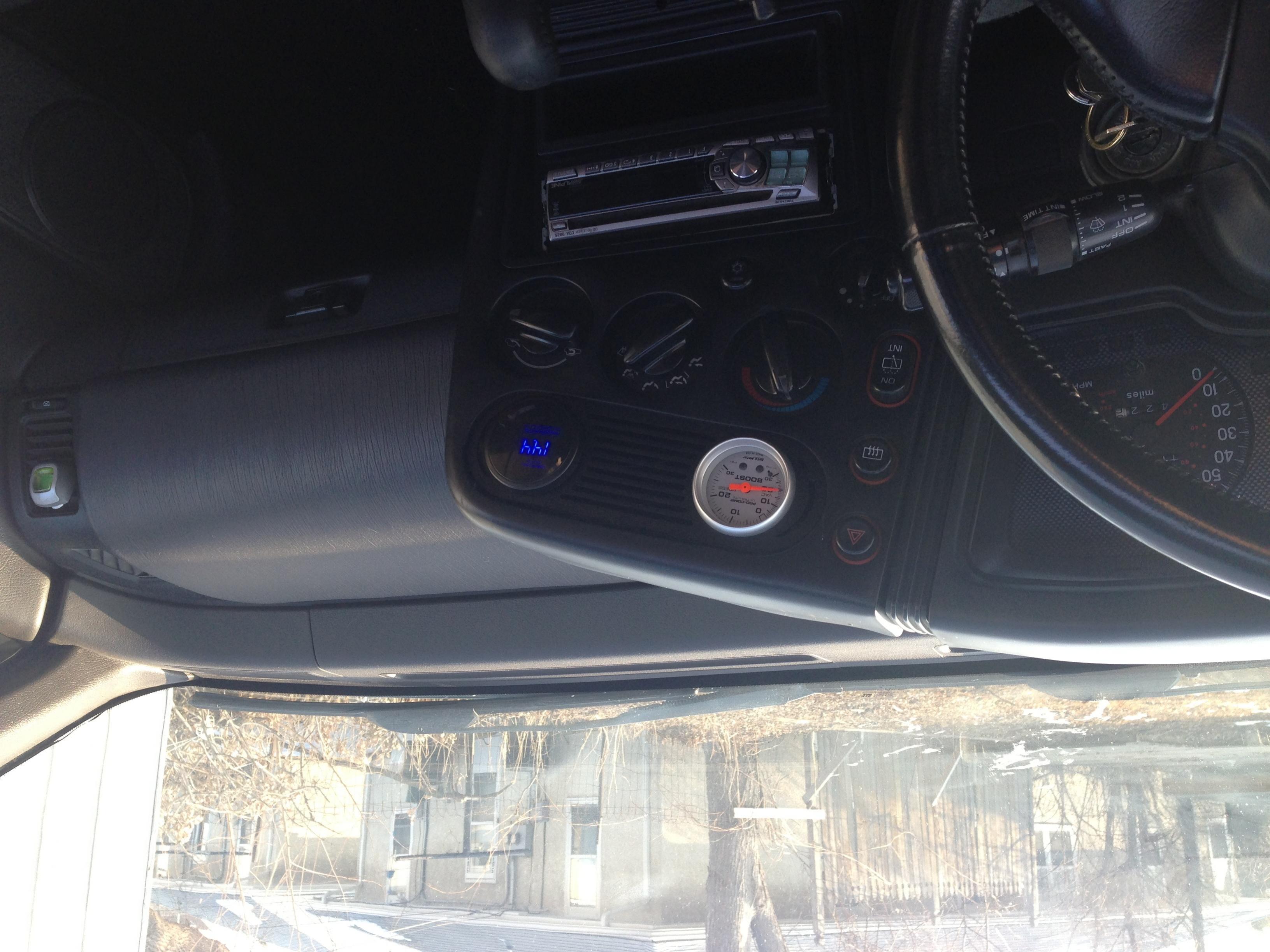

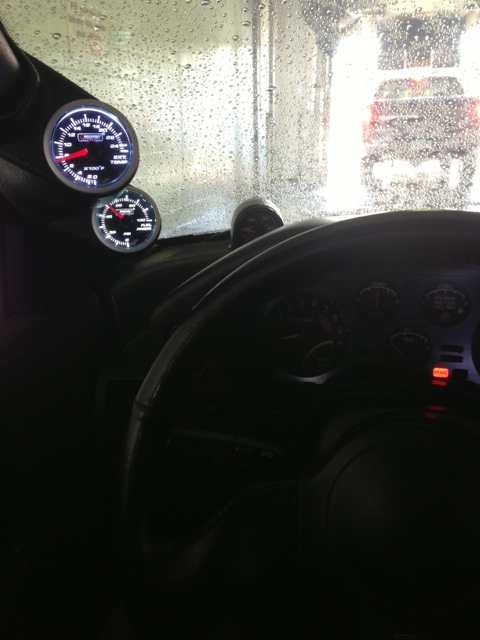

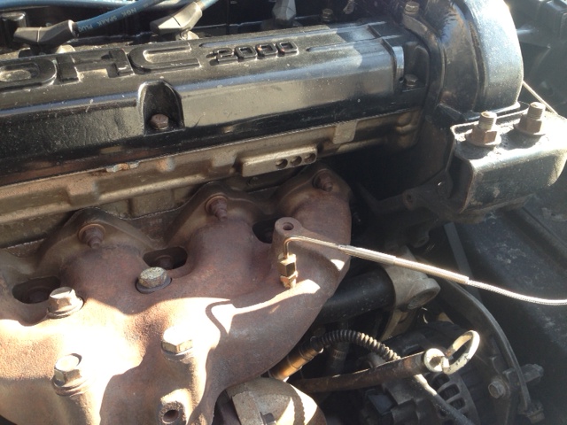

Install of the EGT gauge and sensor was a breeze thanks to a previously tapped manifold I bought from Carltalon a few months back. The fuel pressure gauge install went well too, except it reads 10psi high. I contacted prosport and ill be measuring the resistance of the sensor tomorrow to test it. I like the how the gauges are either white (daytime), or blue (nighttime). I wired them so they come on white, I hit the fog light switch to change to blue.

Just put in this vent pod, holds my boost and wideband gauges.
Damn phone uploading pics upside down
