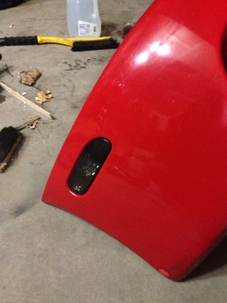

Jealous?!? Got these from my silver 99 N/A shell and they work mint!

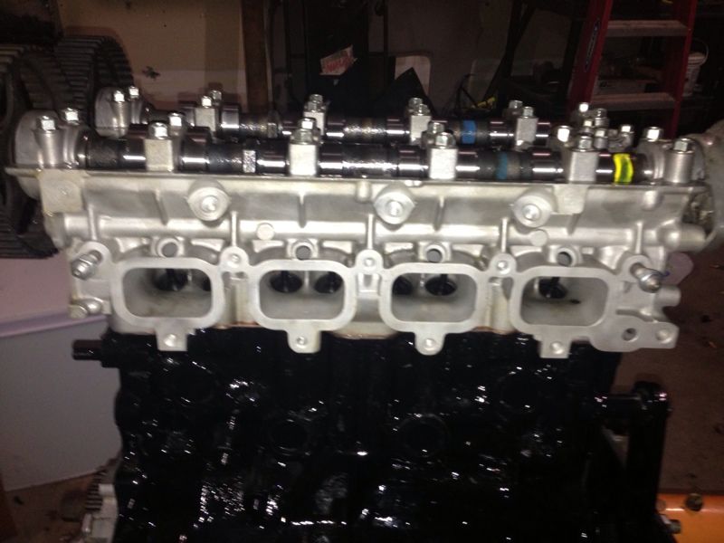

Got my cams installed
