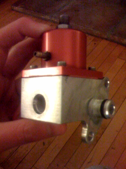

I picked up a Buscher FPR and Walbro 255 hp pump today from Jakey when I was driving through Ames on my way home this evening. However, it's missing the fitting for the fuel return line, hopefully I can get Buscher to sell me just that, or maybe I can rig something up myself.

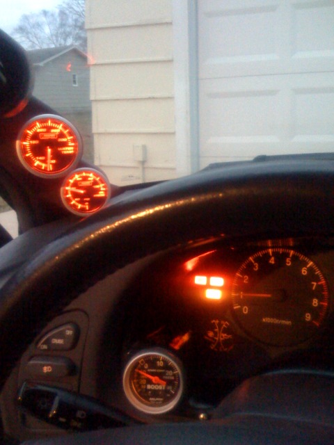

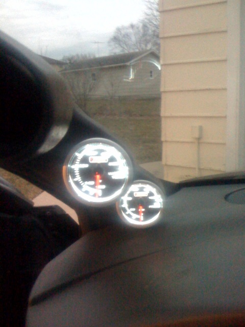

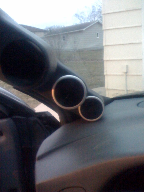

Got my gauges installed, they look great. Now I just have to figure out a third gauge for the pod. I took pictures of the gauges off, then with the lights off, then lights on.
I should have everything else installed by the end of this weekend, and I have tuning scheduled with Shane on April 11th. I'll be all set for the cruise.

Awesome! Seems like more and more people are actually getting their cars tuned, rather than throwing a bunch of parts on them and just tuning them enough so they run.
