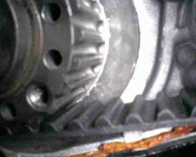

Or, did you put that thin metal spacer between the timing belt and balance shaft belt gears (the one you use to align the crankshaft timing mark) on backwards your timing will be off, and the car won't start. Thanks to a friend, that happened to my old car, wouldn't rev past 3K and was all sputtery.

As you can see from the cell phone picture (sorry for the blurryness) the timing/balance belt separator is indeed installed properly, please note the black crap that has built up over the years is only worn out where the timing belt has kept it polished clean.
And yes, even though it is not shown in this picture, the timing is done correctly.
