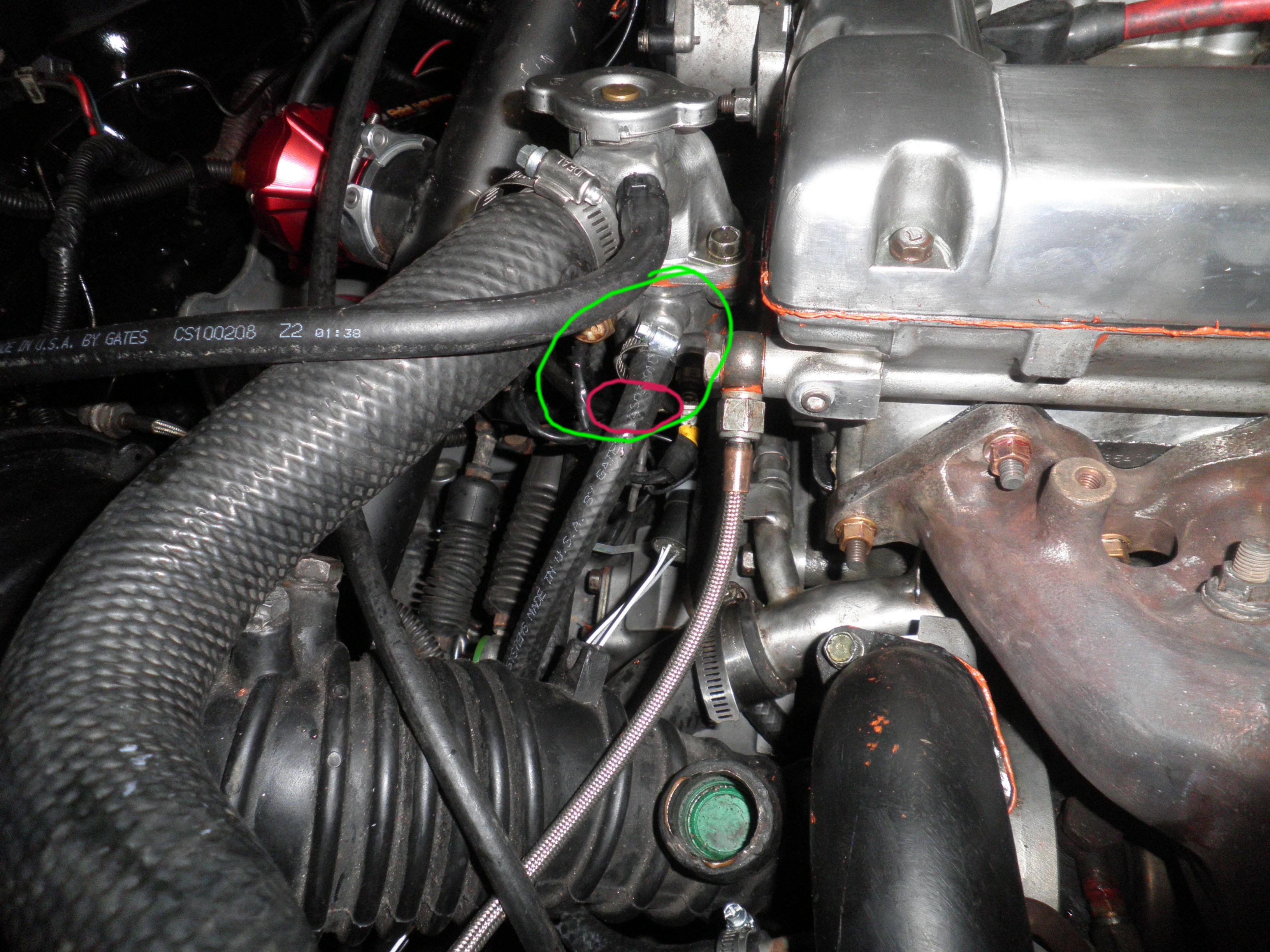

here is the pic, Green Circle is the dump line from the turbo. Pink circle is where the coolant temp sensor is. The feed line is coming from the spout from the smaller main water pipe (by the throttle body)

Ok, so you have the upper line going to the tank, and the lower line feeding the turbo right? Do you have a pic of the overflow?

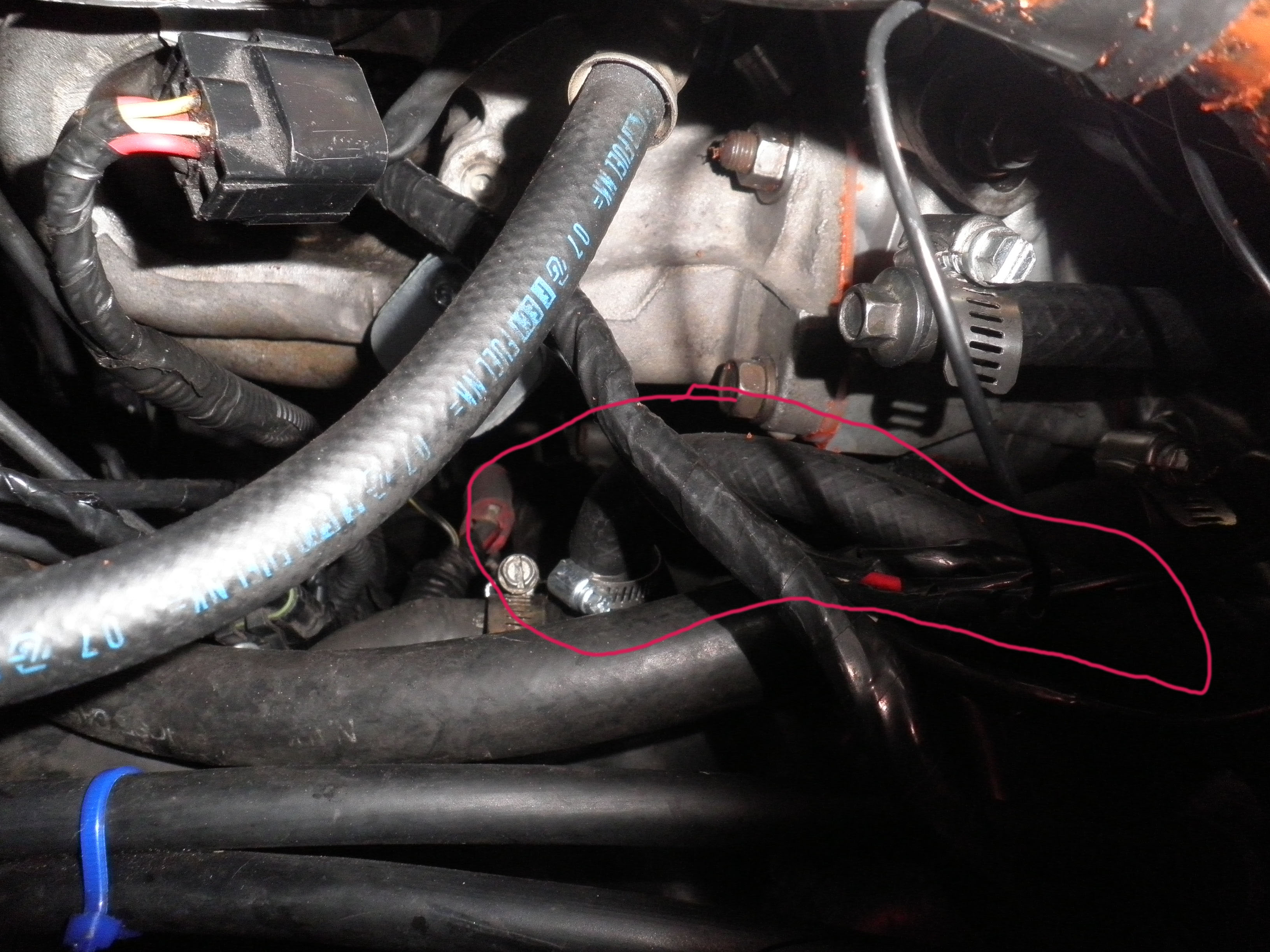

POST #3 mike. Read post 1 and that shows the coolent bottle i have, then read post 3 and realise the solution is there. I had it hooked to the top port and nothing to the bottom, when i should have had it on the bottom port and nothing on the top. When the coolant expands and drops some in there, it starts to fill up the bottle, then when it cools down and sucks it back in, the bottle will empty back down into the radiator.
The line feeding the turbo is coming off of the smaller tube on the water pipe, the one that goes across the transmission and towards the firewall. Pic attached. look where the intake mani is and that should tell you where the feed is coming from and i circled in pink.

Yikes, what a mess of hoses haha
I get what you are saying now that you pointed out which posts you were talking about. I didn't realize you had the same catch can in the linked thread.

yes it is a mess, but it works. I really think its just a false reading from the sensor due to the turbo dump. ill just look for another port to link into. and see what happens.
