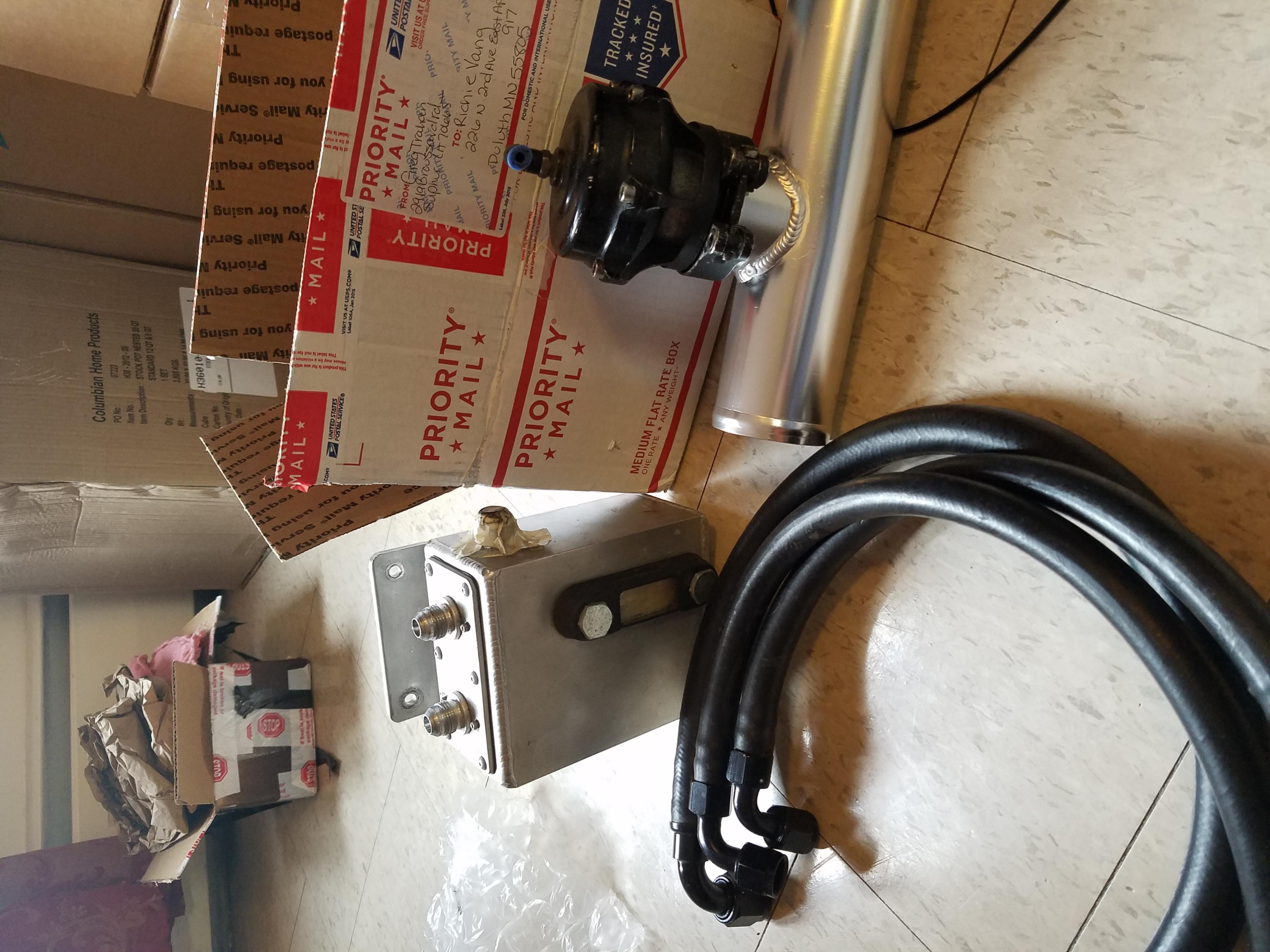

Update* I just ordered a Calan VS3 catch can. I'm planning to delete the pcv and have an -8an fitting welded in place of the pcv and valve cover breather. Then have a -10an welded onto the fp intake pipe. I'm gonna start working on a spare valve cover and hopefully by the time I'm done, Greengoblin from dsmtuners will have more baffle kits ready to ship!
VRSF FMIC and Tial BOV are also on their way!

Those cans are badass, you want a smaller fitting on the intake pipe side to keep velocity at a high level, I'd do a -10 on the VC and -8 on the intake.
Good luck and post some pics!
I don't think I can switch the fittings on the catchcan can I? The one I ordered comes with 2 -8an inlets and a -10an outlet.
Old 03-22-2016   #32
Re: Richie's 1gb TSI
Hmm, didn't know this. Thanks.
I actually thought about whether adding a slash cut (like is done with exhaust scavenging) to the fitting would help any. Would take all of about 5 minutes.

If we have a smaller fitting at the intake wouldn't that be a restriction for the catch can system? It would have higher velocity coming out of that fitting but the velocity from the two -10an fittings on the valve cover would be significantly slower.

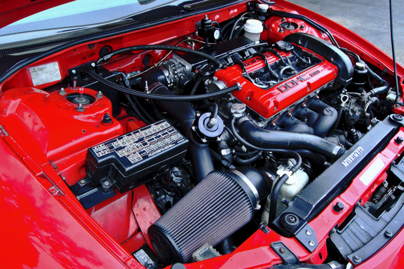

I'll probably paint the catch can black, planning to get everything painted black besides the valve cover which will be red. I attached a pic of what I want the engine bay to look like. Let me know your opinions!

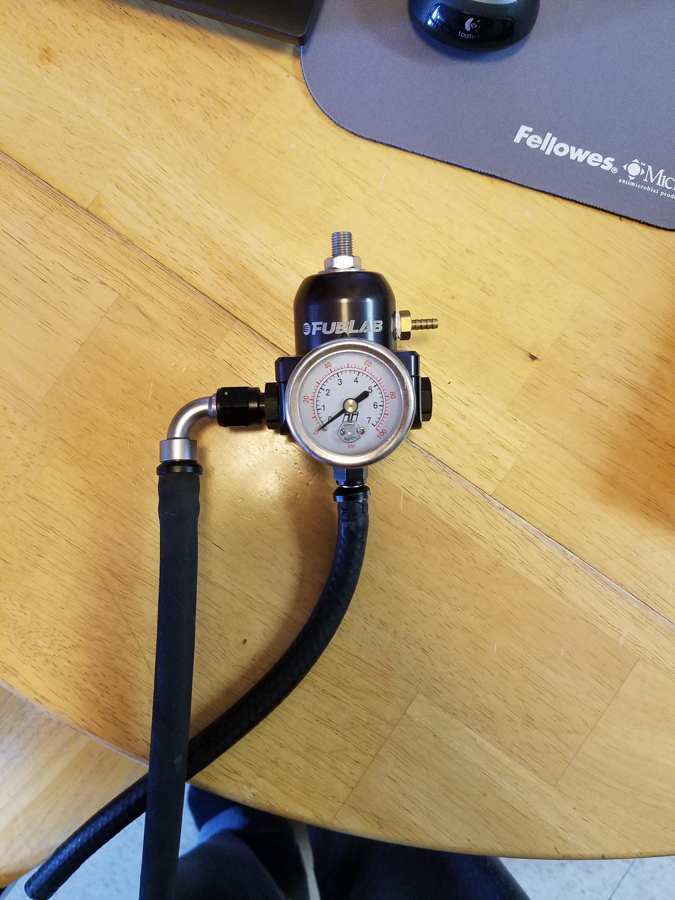

Got the fuel lab in a trade for my 1g wheels.
