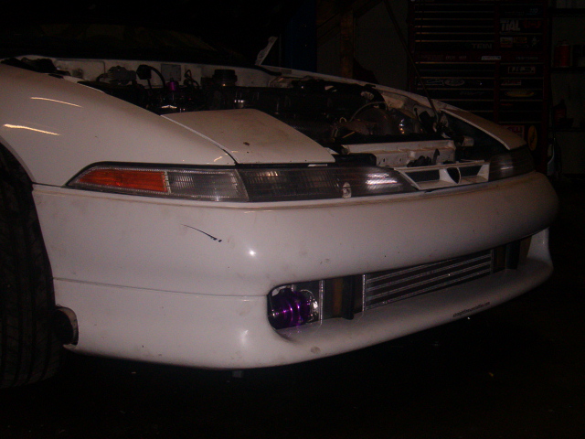

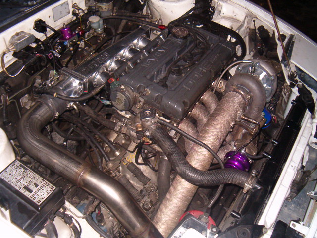

Custom 1G Setup Pics
Did something a little diff you usually dont see on DSM's as in most of the DSM crowd is if it dont bolt on i dont wanna bother w/ it. On the base tune it seems to be working out pretty well. Only made a few quick pulls on the dyno so far to get a rough tune as we ran out of time. So far on base timing 24 psi it made 484whp on a 3rd gear pull maxing out the 650's. Gonna be back on the dyno shortly after some new injectors. Only downfall is its a stock rod bottom end, doh!
Nick
SLS

Either way a manifold had to be built to accept the T3/T4 and i personaly like top mounts for the ease of working on them.

Being the turbine housing is that close to the hood, doesn't the hood get hotter than a bitch? Just wondering. That's the only thing that came across my mind when i checked the pics out.
Old 08-09-2005   #11
PSI2HI
Location: Fargo, ND
Posts: 181
Send a message via AIM to PSI2HI
Re: Custom 1G Setup Pics
nah, its perfectly fine. It's not as close as it may look.

um.. look at it this way...
1. WHAT back preasure on exhaust??! NONE
2. holy freaken short route piping!!! from turbo right into the FMIC..
-E

i don't have a "fucking problem", I'm wondering what the point of doing something bass-akwards is, when to the casual observer, it offers no gains and creates headaches. Additional heat killing alternators (if not necessitating a move of the alternator mounting to begin with), no place for the PS pump, limited room for a proper intake, a bunch of spare room on the left side now occupied by a big exhaust pipe running through your engine bay instead of out the bottom, etc.

there you go, that'd be a real answer, not "typical dsmer go play with your 16g"
with a top-mounted turbine, wouldn't that place the heads of your mounting bolts underneath?

Sure wouldn't. If you look @ the pics you can see it all clearly. The car doesn't run power stereringf nor AC nor dsid it have it befroe this setup. Everything clears the alternator, we have an intake that clears for it, etc..

Actually there will be less heat on the alternator. There is usually a big DP running right next to it. Most drag cars don't use a PS pump either, so no biggie there. Intake? Cut a hole in the fender well. Why would you want spare room? It isn't doing anything, so why not use it?
The heat on the hood is a valid point. For a drag car it will be fine though. Other than that I kind of like the setup!
It is a full garrett turbo, hence the bolts thread into the manifold.
How is there additional heat to kill alternators? The hot side of the turbo and the exhaust(which the downpipe usually goes through right next to the alternator) is far away from the alternator. It is obviously for more of a race application.
