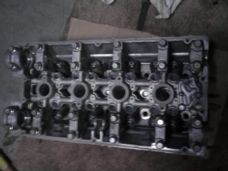

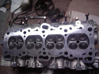

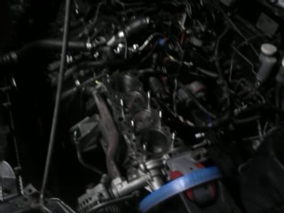

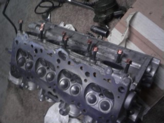

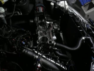

Couple pics of the progress.
Sorry if they are crappy quality, Head is shiney!
