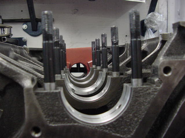

Most of the higher hp applications we "pin". This helps provide a positive center for the caps when assemblying the motor, and also helps prevent the cap from pivoting or "dancing" on main studs.

It's adding a dowel pin machined into the cap and the block that the main studs go through. It provides tighter clearances to supposedly keep the caps from moving at all.

Here's a good pic of the pin around the ARP's on my motor.
