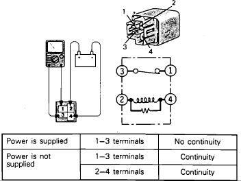

Which wire from the key cylinder is the wire that give's power to the starter? When you turn the key to run, you get electricity to the radio, a/c etc. But, which wire becomes hot when you turn the key to start? btw, this is a 92 talon.

Power from the ignition switch color is ( B - Y ) that wire goes to the starter relay, from the relay is becomes ( B - R ) on its way to the starter.

Its up to you , but it looks like you could go to the relay and do the splice.

which wire from the relay do I tap into then? The black and red one that goes to the starter?

I guess? I’m not sure what you are trying to achieve. If you apply 12 volts to the B/R wire the starter will engage, If you try to run something else off that wire, it will only get power when the starter gets power.
