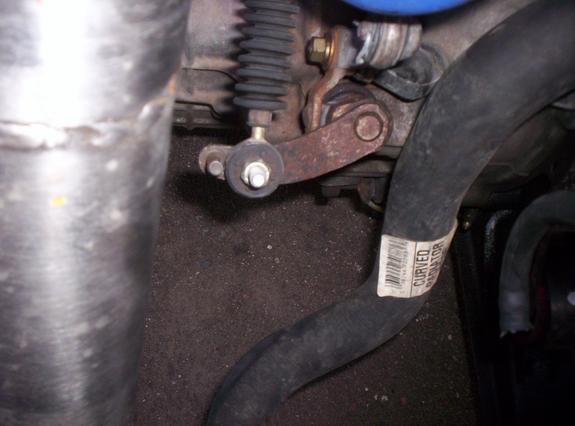

Just drill a hole in the 91+ lever and bolt the cable to it like this.

Sweet, i will have to try that.
