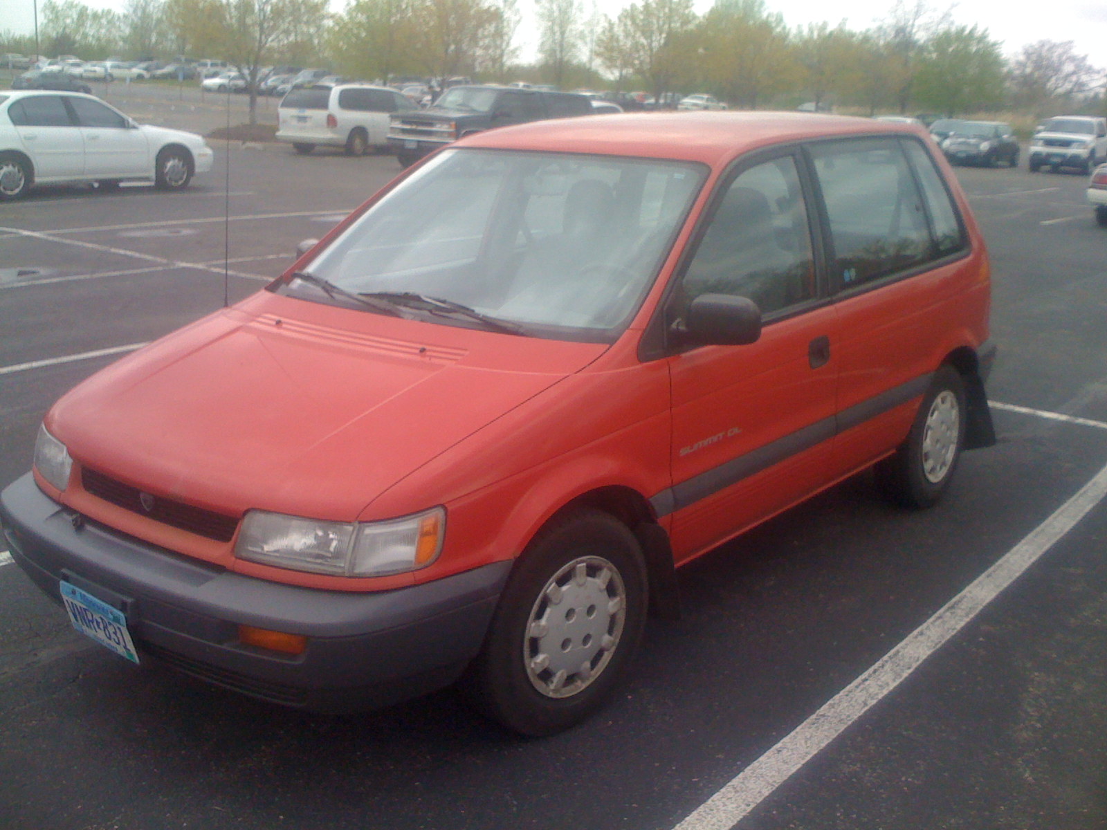

New ride off craigslist
I just picked up an amazing deal off craigslist.
-93 Red summit 3-door.
-1.8L 5-speed.
-One spot of rust.
-4 new tires
-tow hitch (class II)
126,000
He was asking $200, I was a total a**hole and got him down to $160, I feel so bad *not*
Transmission goes into 1234 no 5 or R
I assume the issue with the transmission is the nut that backs off all DSM transmissions, i know this is a CSM, but w/e....does anyone have any experience with these?
