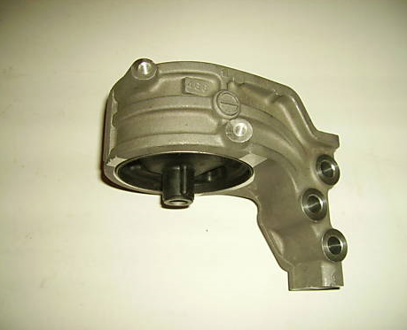

i need something like this only this is for a 2g

i got one from tkr i have to modify it to work it lines up ,but it sits high so i have to make a bracket to work with it

It looks like you have a 2g lower driver side motor mount on the block, you would need a 1g lower driver side mount and the timing belt tensioner setup from a 6bolt to make the "L" mount work.
