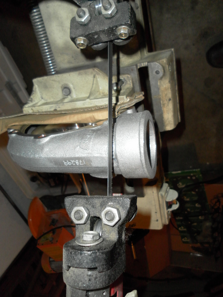

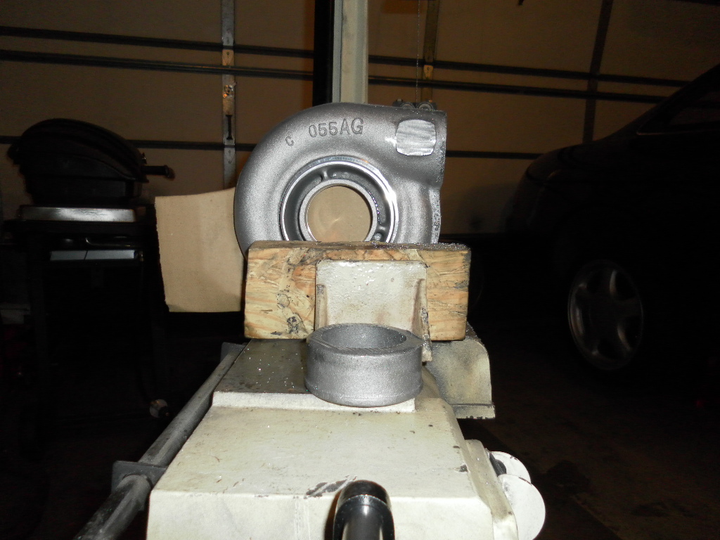

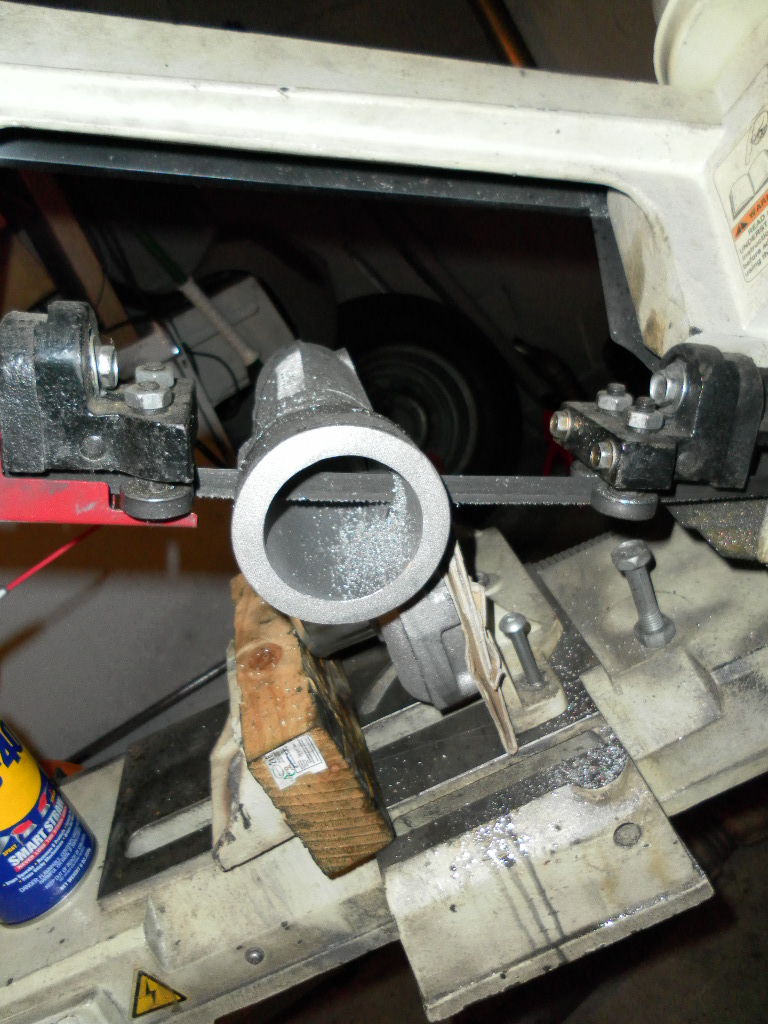

Chopped the big outlet off the compressor cover. Will need to get a 90* welded to it facing forward.
Started mocking up the piping. Not sure if this is the way I'll go yet, just a real rough start to one route...

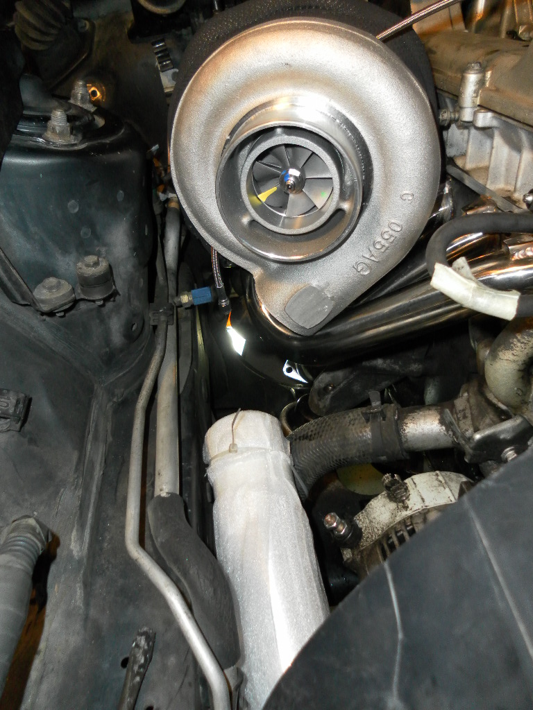

Oh. Does the stock intake inlet clear that massive turbo? I guess I figured you would have to run a FFIM because of the size of it.

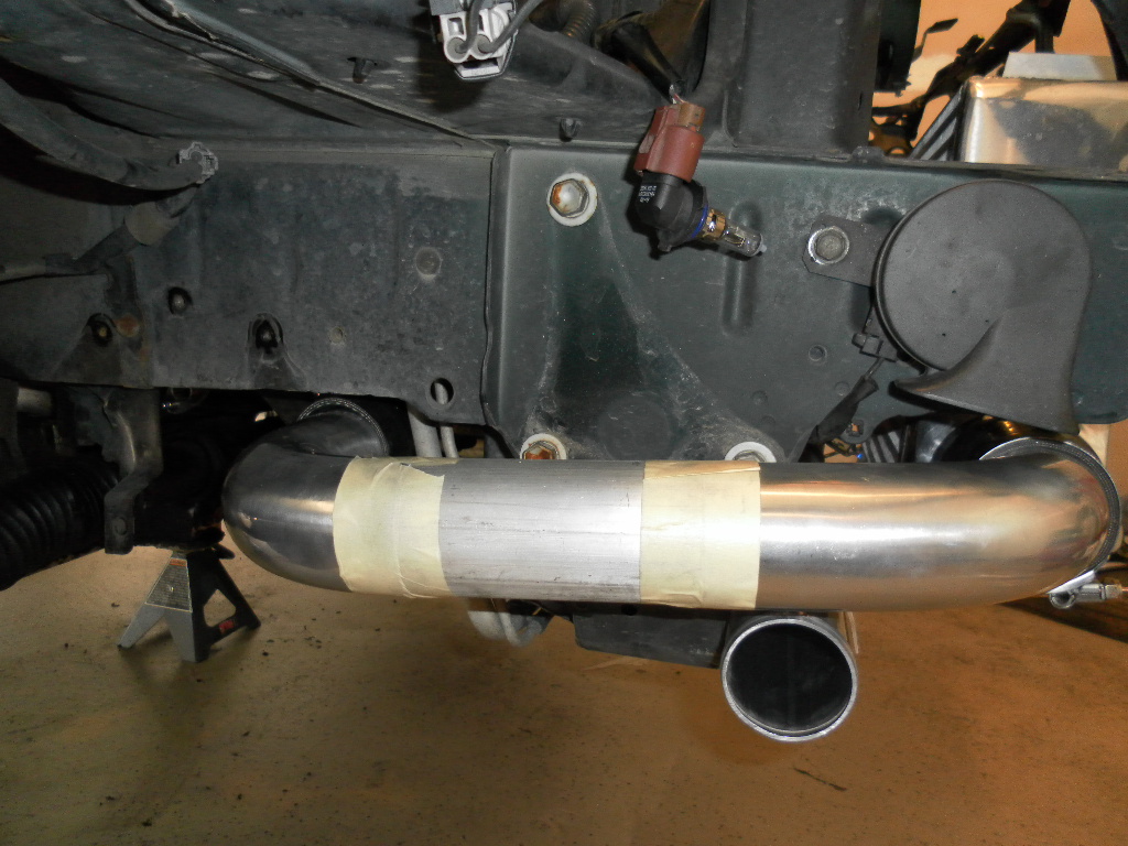

Re: Project Lex

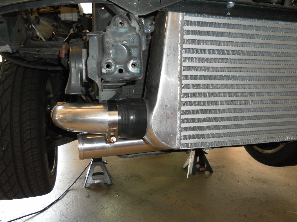

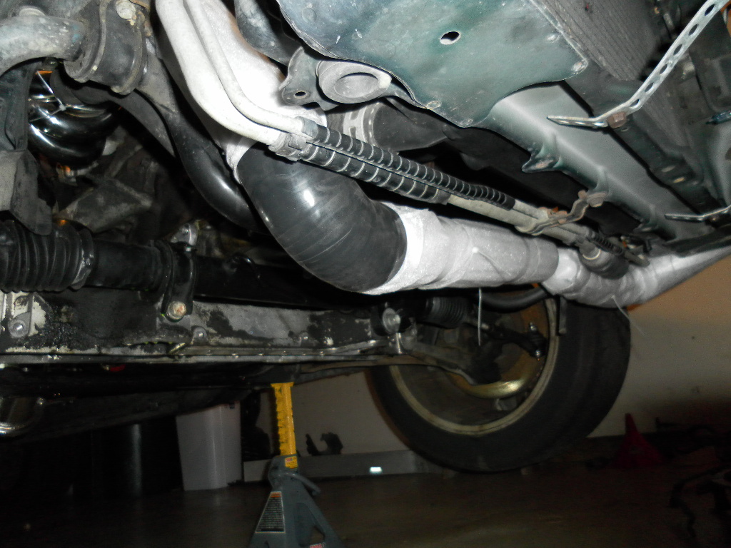

Decided to go a slightly different route with the IC piping. I have half of the Compressor side piping done and taped together ready for welding. Also have half of the TB side of the piping fabbed up as well. The bend coming out of the FMIC is uuugly, very sharp turn. Not ideal by any means, but it allows me to route it the way I want to, and plus that side will be changed once I switch to a different intake mani setup anyway so it's only temporary.
Here's pics of the compressor side piping I've mocked up so far.

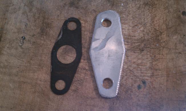

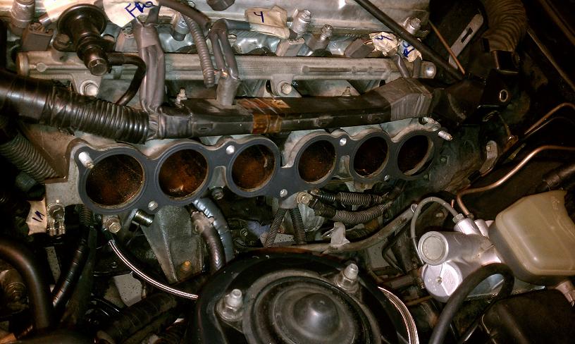

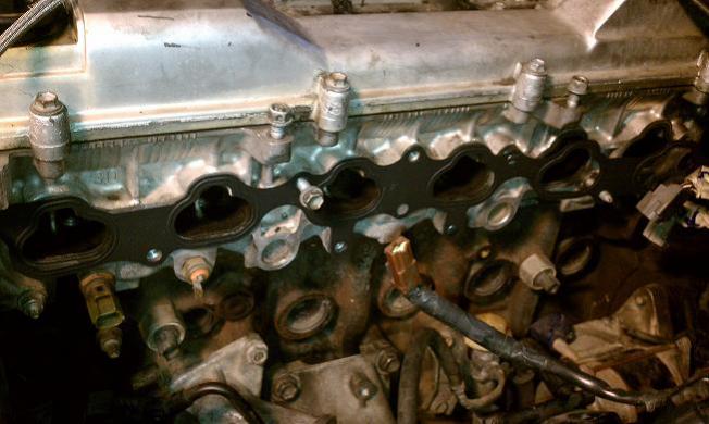

Decided next to start plugging stuff back in and putting the intake mani on. First I decided to make an EGR Block-off plate out of some scrap aluminum stock I had:
Putting the intake back on. Nice new intake gasket
As she sits right now

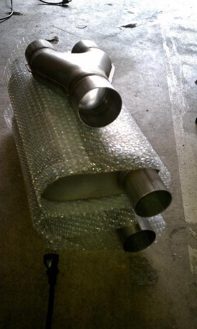

Some exhaust stuff showed up at the door today

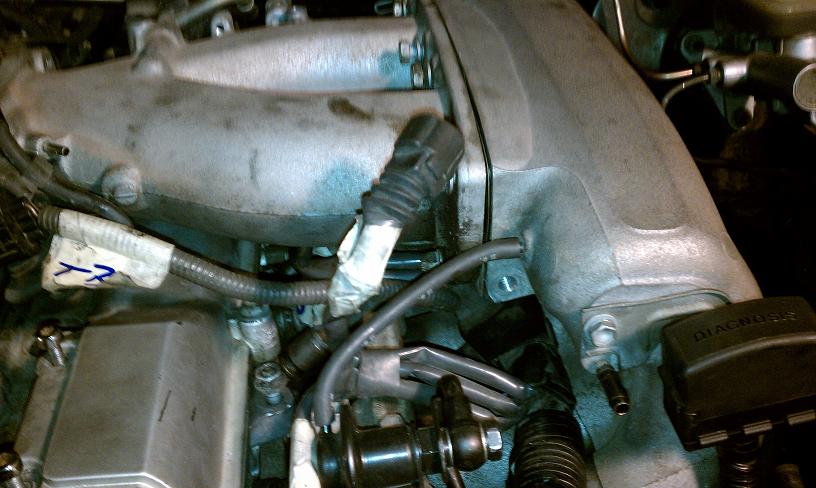

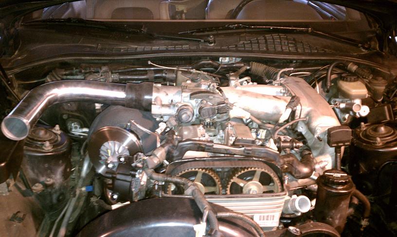

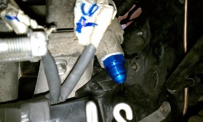

Put the plenum on the runners. Nice new gasket

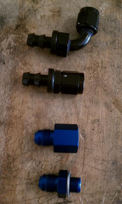

Also I kinked the fuel rail feed line, so I've decided to just replace it and the stock fuel dampener with a direct -6AN push-lock setup. TNT had all the parts ready to rock for me!
12mm x 1.25 male fuel rail fitting
14mm x 1.5 female fitting attaches to stock line
Straight and 90* -6an push-lock hose ends.
Got some 1/2NPT x 5/8" barbed fittings for the Turbo Oil Drain setup. Figured this will keep it a cheap and simple drain setup.
Here's how she looks right now.
Goodhart you asked about turbo clearance, well here ya go. There is none
LOL WOW!!

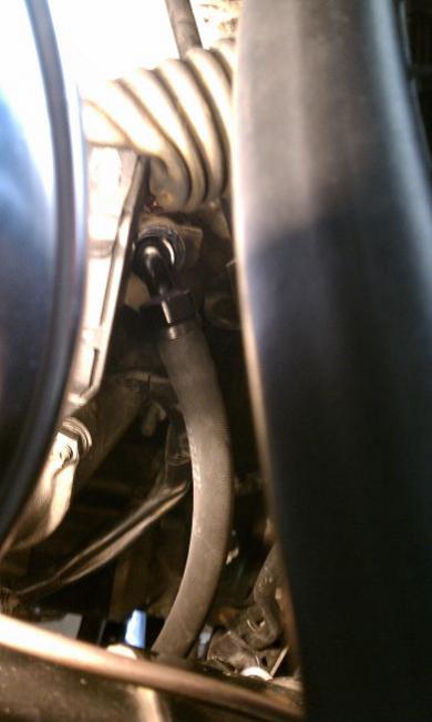

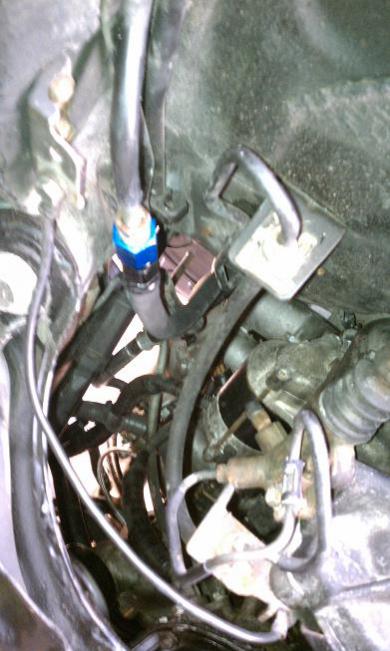

Made the new Fuel Feedline which will bypass the stock fuel damper. Used -6AN black Aeroquip Push-Lock hose (my favorite push-lock hose) with black push-lock hose ends. I don't like the blingy SS Braided stuff. I like clean and subtle, so this is perfect. Plus it's way easier to assemble than SS Braided. The adapter fittings are blue because I simply could not find them in black, oh well. They are 12mm x 1.25 (fuel rail) and 14mm x 1.5 (stock fuel line) fittings. 21" of fuel line used.
Fitting installed in Fuel Rail:
Fuel line installed:
Underneath the car where it attaches to the stock line near the firewall

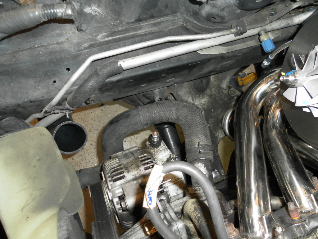

Got the Oil Drain Flange mounted on the turbo. That's another tight squeeze, so I think for now I'll just run a -10AN SS Braided drain line since it is so close to the turbo flange. Next year I may rethink the drain setup.

Looking good. I was thinking what if we did a hard return line half way down and then below that manifold and turbo had a fitting welded on the hard pipe that would go to a braided AN line for some flex the rest of the way to the block?
