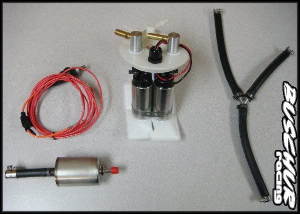

Old 11-10-2010   #17
travail
travail's Avatar
Join Date: Jun 2009
Location: St Peter, Mn
Drives: EV0 8
Posts: 261
Re: inline fuel pump booster
Here what it is
travail is offline   Reply With Quote
