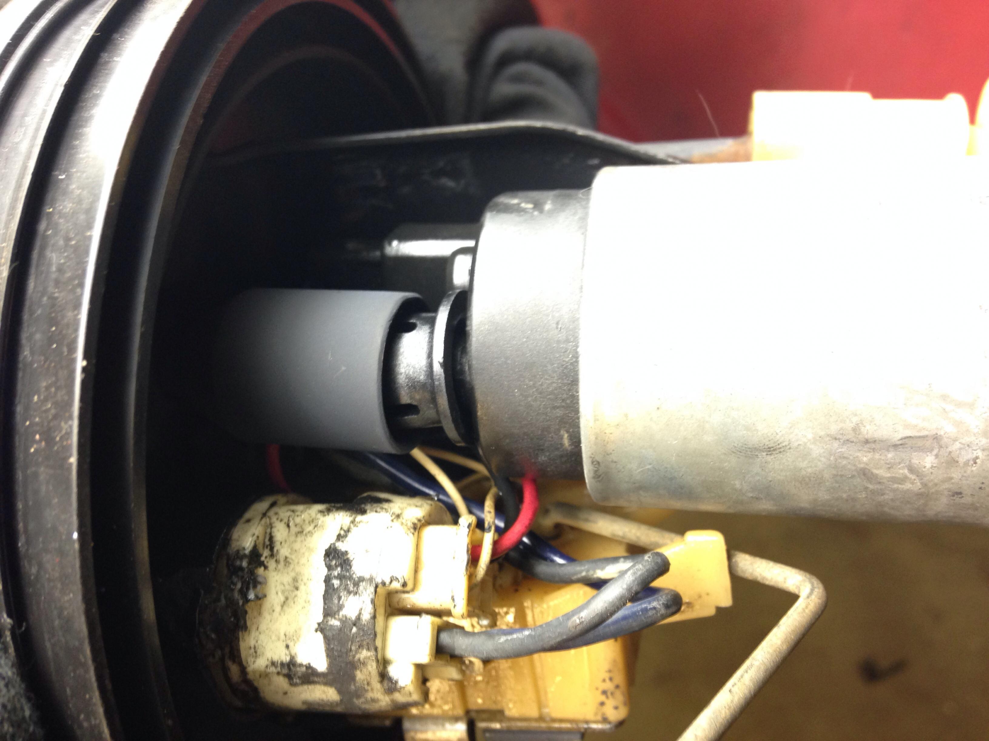

Here's how the pump sits

Problem solved!
Thanks Asshanson.
Problem was the pump not fully seated in the sender.
