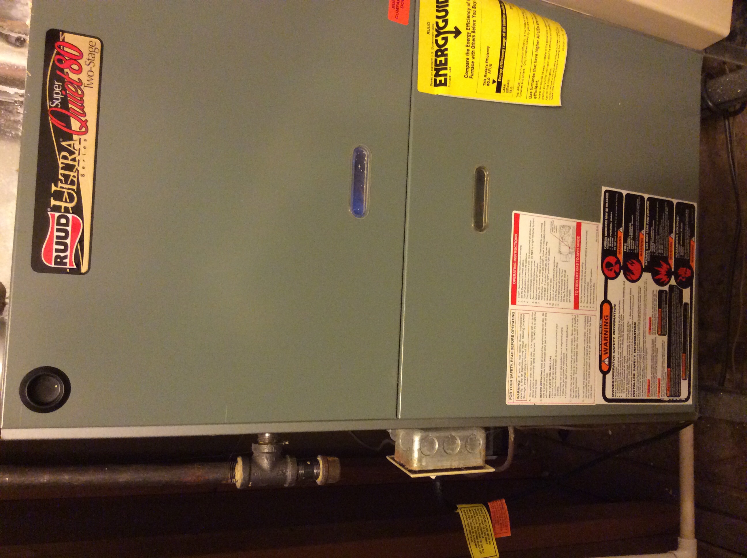

Went to Menards yesterday and checked out the csst stuff. Getting more comfortable with the diy option.
In trying to figure out where to place the heater, I have two good spots. Each would be sourcing the gas from a different ng gas line. Each would be from a similar junction (see pictures).
My question about the two junctions. They both have a cap at the same point, pointing toward the ground, near where they enter a furnace. Is this a valid point to take ng from? Just curious, as it seems like there is no reason to have those "T" junctions at those points other than maybe there is a reason for those caps at those points?

Could only attach one pic per post..

Yes, you could tap in to the gas line there. The csst was really easy.
I'd google it a bit. I know water lines have that extra length acting as an anti-hammer relief. Older houses have that hammering sound sometimes, this cured that. I'm not sure if it's the same for gas, but it's worth checking into. I T'd mine off the copper line in the ceiling above my hot water heater, and ran more copper line out to the garage.

1/4 psi won't be creating any hammering

2psi coming out of the meter, then gets dropped to 1/4 psi for the appliances (there is a big regulator shortly after coming in the house). 1/4 psi = 7" of water to go with the above post.

Mo, either of those spots look fine. Just make sure you have a shut-off valve somewhere upstream, treat it like water....turn on stove or a burner, go shut valve off, wait for burner to go out, be sure to shut it off. Always have a back-out plan once you open the pipe up--you don't want to be in a spot where you cannot run your furnace or anything.
