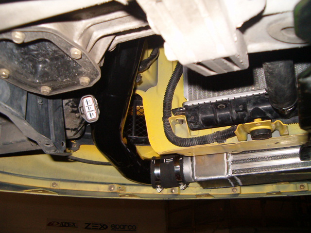

Setup i did awhile back figured i'd post up some pics. Don't have any dyno #'s yet or track time as the trans doesn't like to shift @ anything over 6500.
Garrett GT3076
SLS Manifold
SLS IC piping
SLS downpipe
Garrett 24x12x3.5 IC core
TIAL 44mm
FIC 750's
Nick
SLS

Just out of curiosity, are your flanges CNC plasma, CNC laser, or water jet cut?

CNC mill.

I don't think that IC is big enough, you can still close the hood.

Running just an AFC and stock motor for now.
As far as overall surface area a 1G DSM race core is actually a chunk bigger. The 24x12's just look so damn big.
