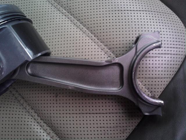

As far as the piston meeting the head, you really should get the head checked out before you slap it all back together only to find out you have a bent valve so you can pull it apart all over again. Please do not turn this into an "I told you so" fest.

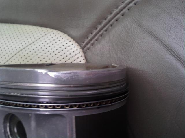

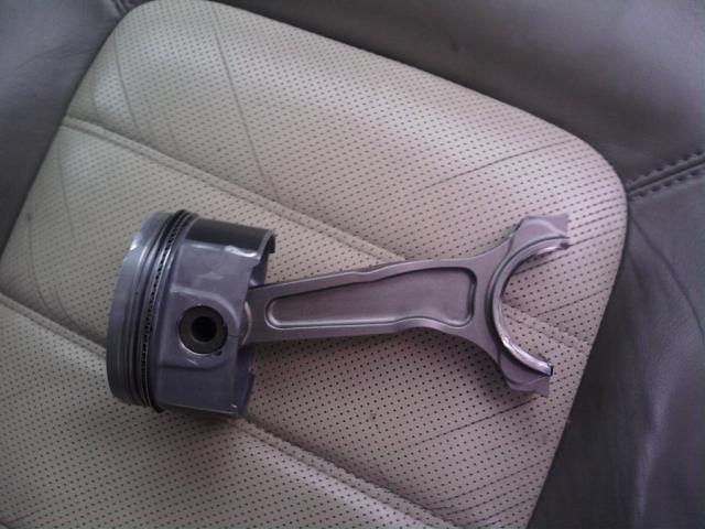

heres some carnage pics.
The picture of the piston you can see where it slapped the head, the top ring is compressed and wont come out. the other ones came out with minimal effort.

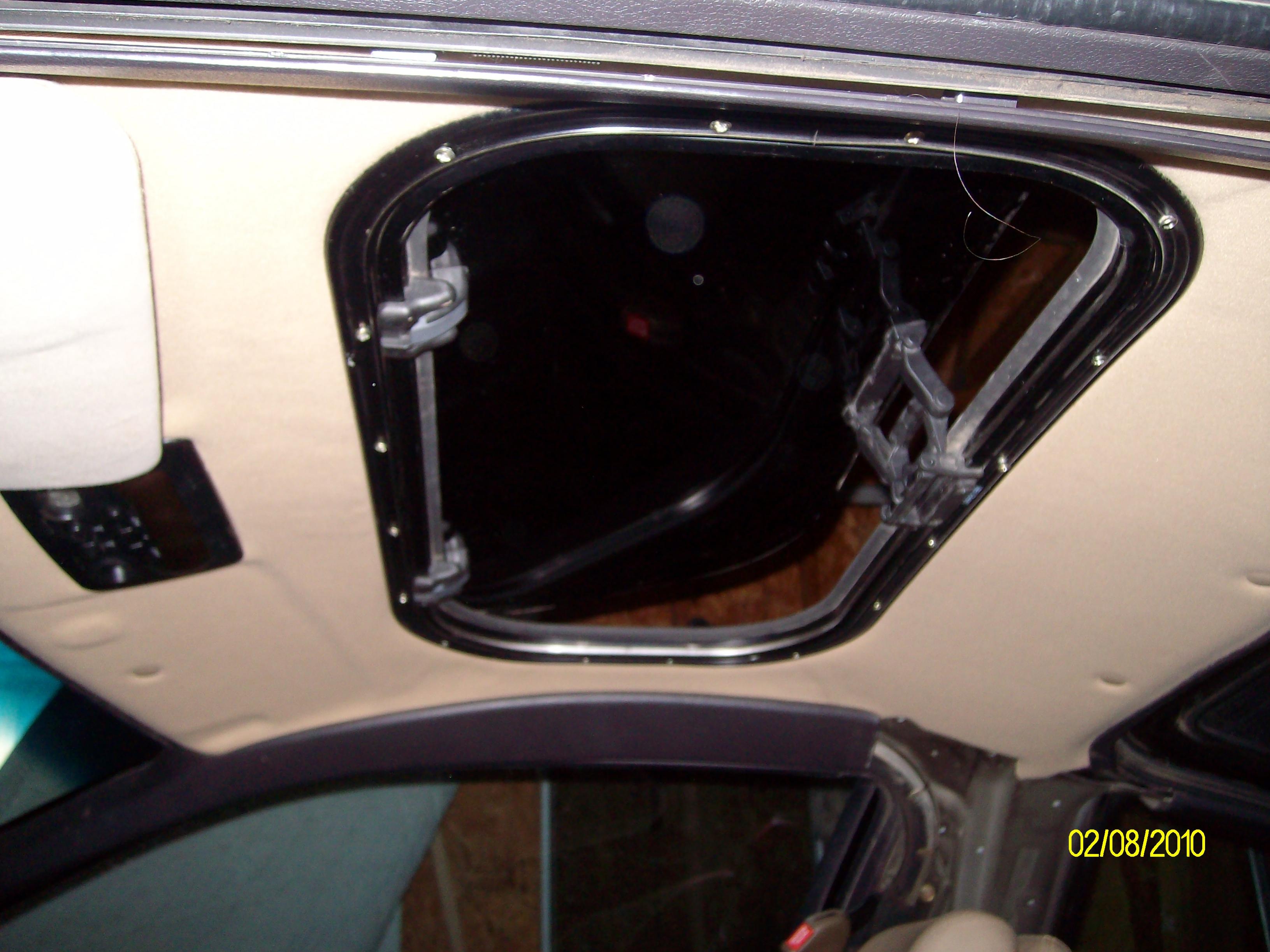

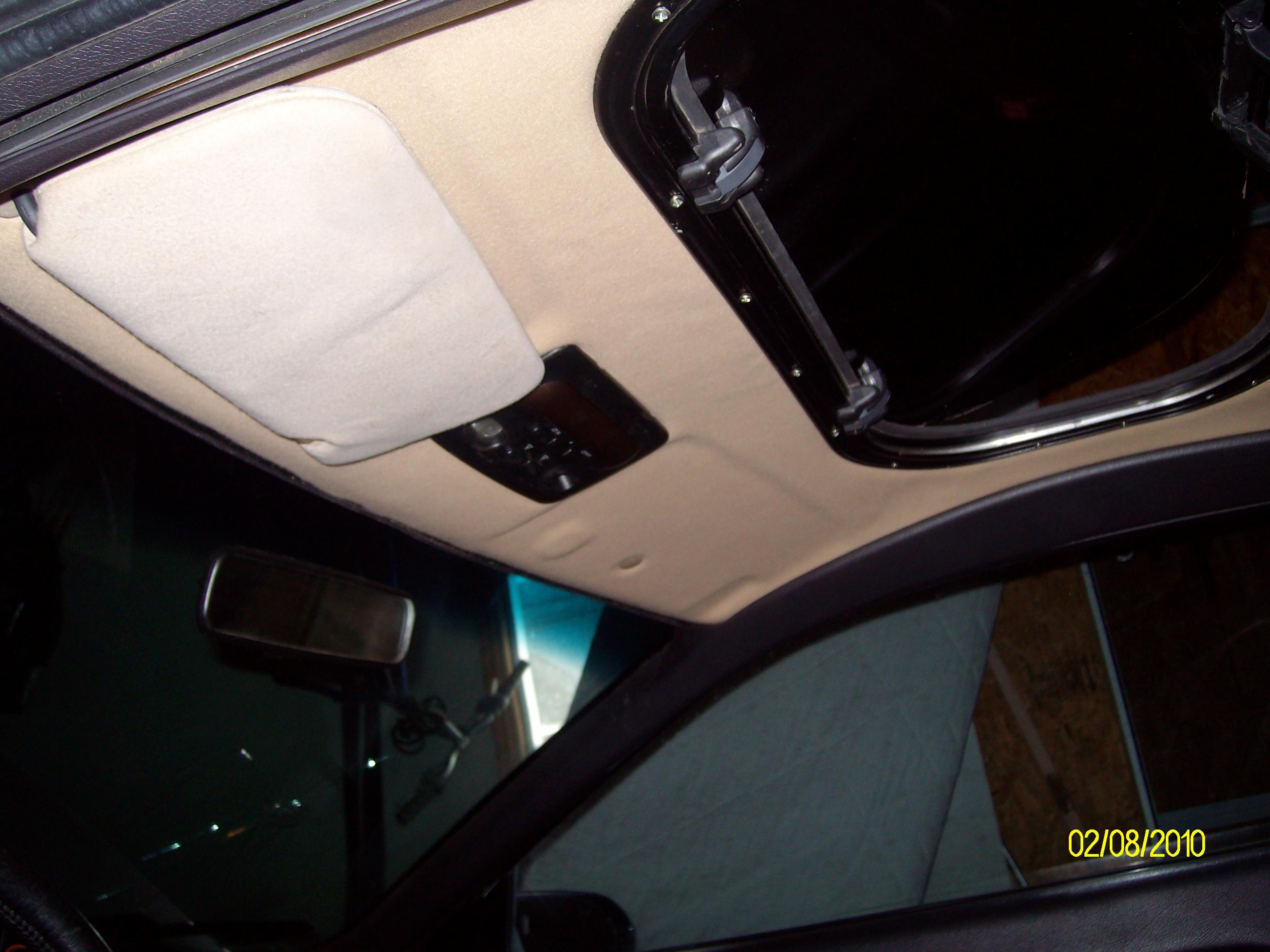

The car is missing one of the sun visors so i didnt pop the holes in the passenger side visor area. The driver side visor i have to recover still.
I first took down the headliner, and then used a welding brush (thick wire brush) to clean off the old foam padding. Then sanded it a little smoother and to clean the rest off. Then repaired the broken peices. I then sprayed the Super 77 and waited like 15 seconds to get it tacky. Then layed it down and smoothed everything. Then cut it out leaving a couple mm of extra to wrap a bit. Let her dry and she was good to go. The material i used is really nice, i was thinking i was going to have to get fabric and foam seperate but Joanns had the headliner material that the foam was on the back of the cloth.

Why didnt you cover it in black? Lookin good though.

I was actually thinking about that afterward, But i think when i get carpets ill recover it again in black or grey. But ill also have to get covers for the seats as it looks like ill have to keep the 1g seats until i get race seats. Then ill have to change the carpet on the doors, and the leather on the doors as well.
