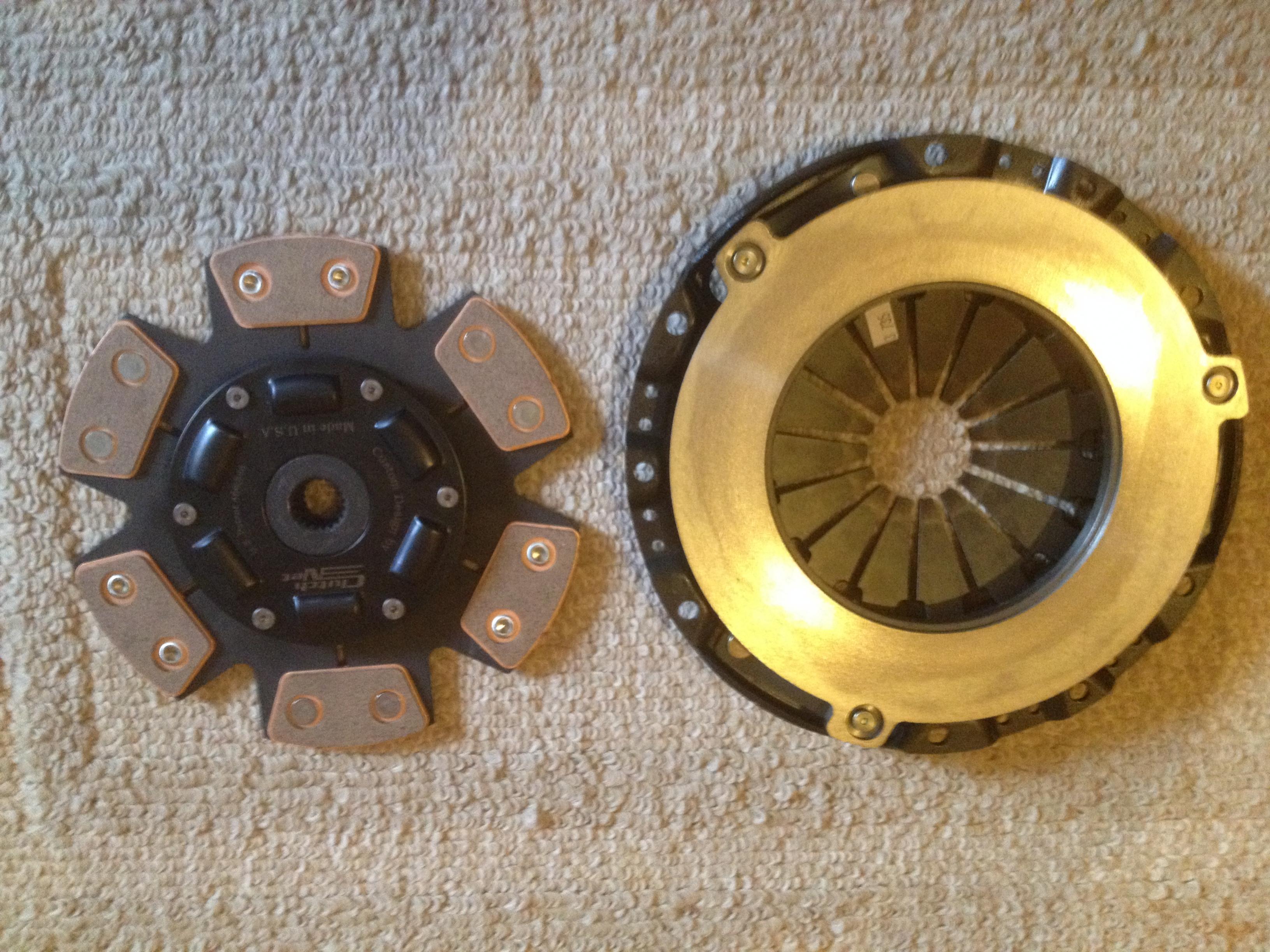

Okay sounds good I wondered. I'll definitely call them tomorrow morning! Unfortunately the ACT plates are sold out but maybe I can convince them to separate a kit and sell one. Or I'll see if I can buy a competition clutch stage 5 plate.

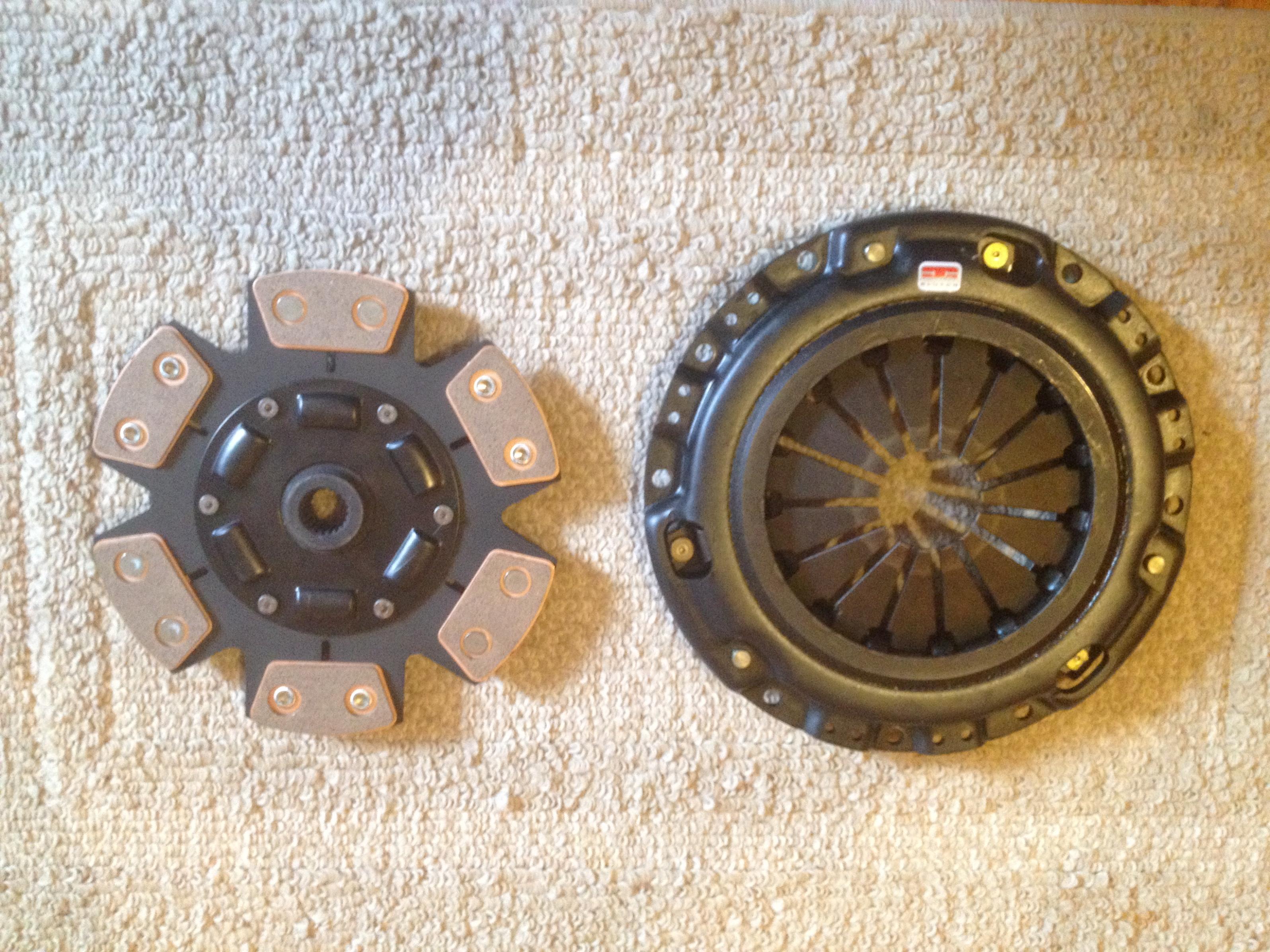

New goodies finally came. Time to get going!

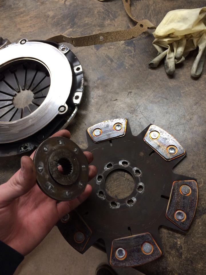

ID:	14090   Click image for larger version

Clutchnet disk and Comp PP?
Yep! The pressure plate runs 2700# and the disk, well, you guys know the disk. I look forward to seeing how well it works and I'm sure it's miles ahead of my old setup. I'm saving the XTD plate for another idea later on...

Never heard of anyone running that combo, but good luck with it!
