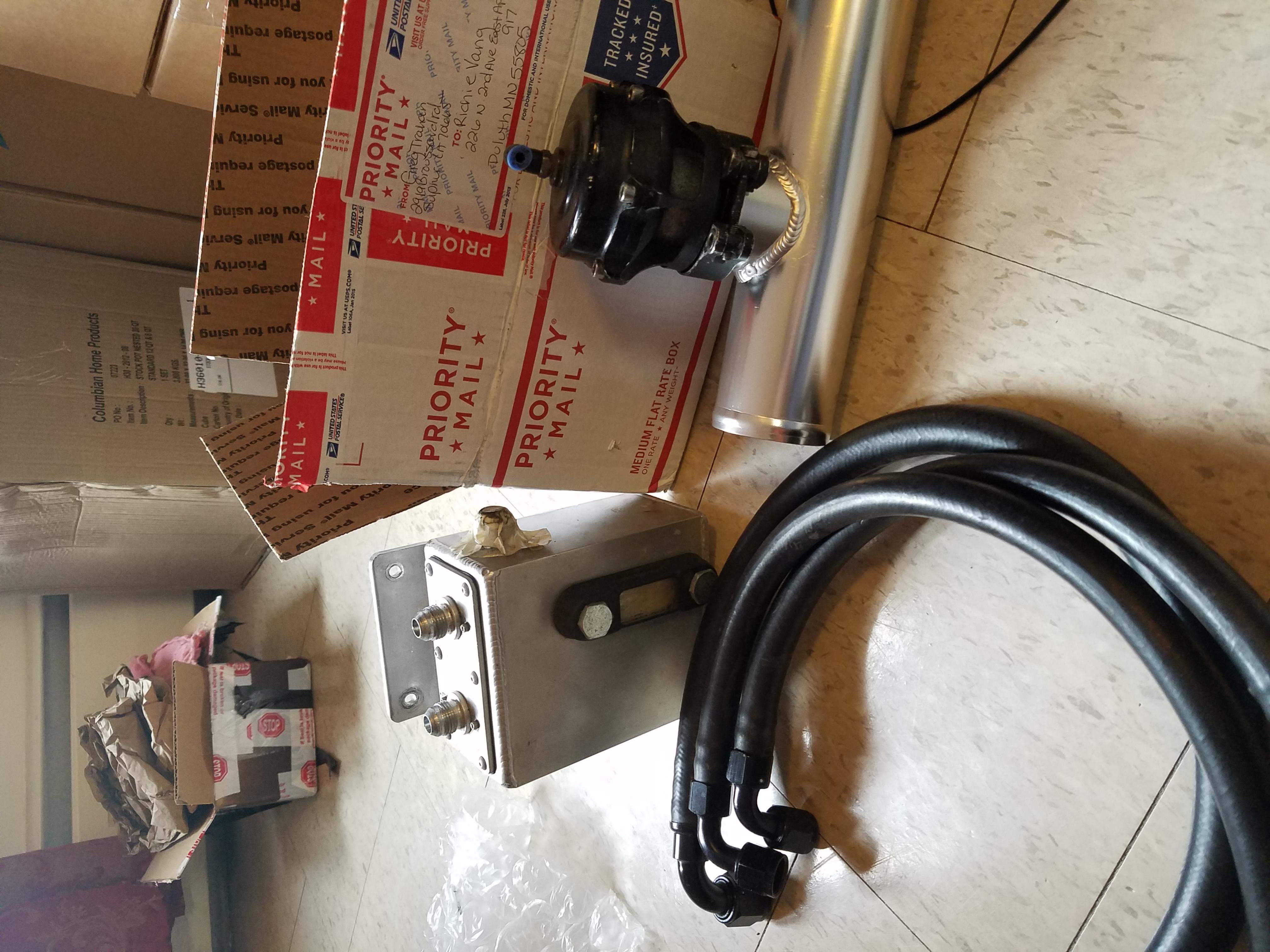

Update* I just ordered a Calan VS3 catch can. I'm planning to delete the pcv and have an -8an fitting welded in place of the pcv and valve cover breather. Then have a -10an welded onto the fp intake pipe. I'm gonna start working on a spare valve cover and hopefully by the time I'm done, Greengoblin from dsmtuners will have more baffle kits ready to ship!
VRSF FMIC and Tial BOV are also on their way!

Those cans are badass, you want a smaller fitting on the intake pipe side to keep velocity at a high level, I'd do a -10 on the VC and -8 on the intake.

I don't think I can switch the fittings on the catchcan can I? The one I ordered comes with 2 -8an inlets and a -10an outlet.

If we have a smaller fitting at the intake wouldn't that be a restriction for the catch can system? It would have higher velocity coming out of that fitting but the velocity from the two -10an fittings on the valve cover would be significantly slower.

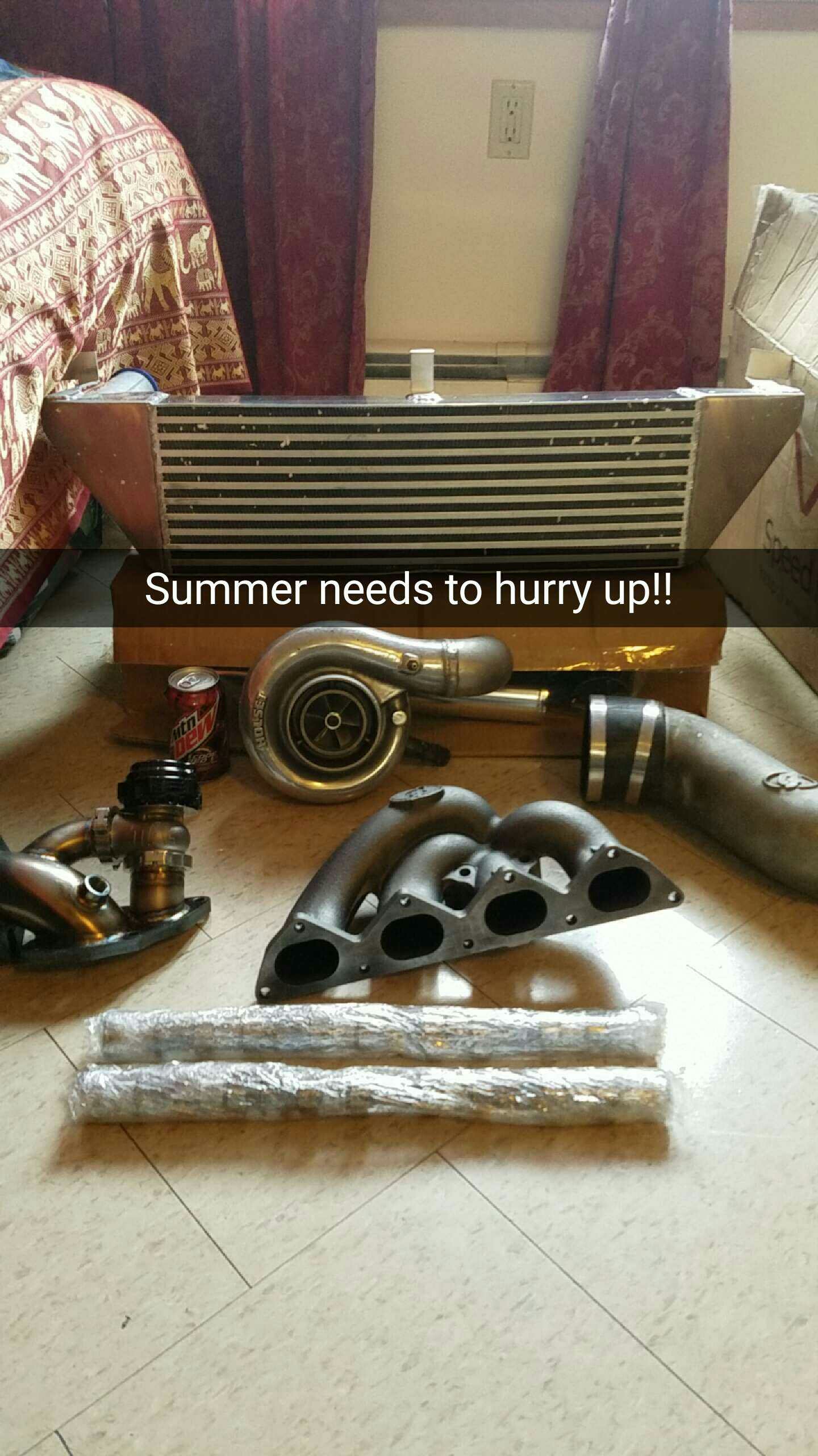

DSMLink and a premium built Jacks transmission are on their way!
I currently have a gm maf and my dsmlink came with a gm maf cable. What's your opinion on gm maf vs speed density? Would it be worth it to sell my gm maf + cable and add a little cash to get speed density? Or just run gm maf? The engine is still stock, just going to add cams and valve springs/retainers to rev a little higher. With that in mind I won't be pushing the car past 500hp until I get a built motor and bigger injectors next year.

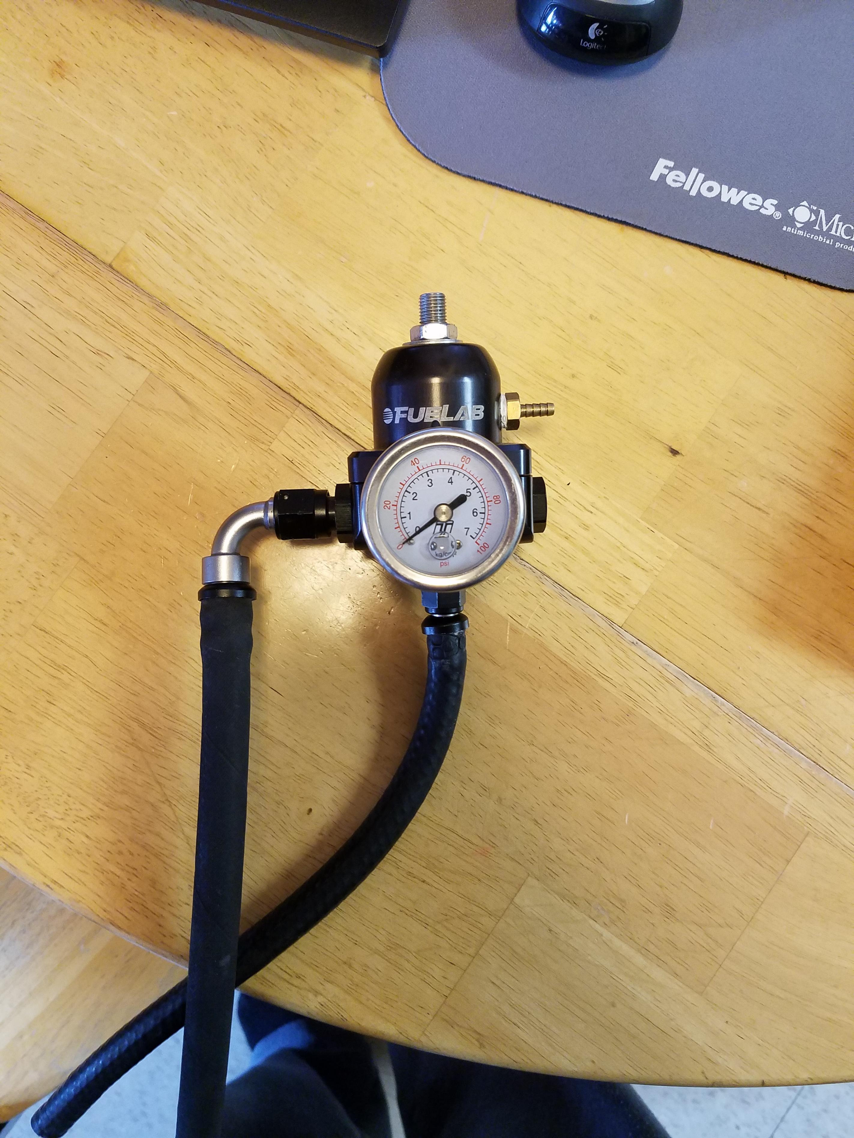

Got the fuel lab in a trade for my 1g wheels.
