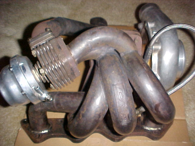

Id be worried with high back pressure on 2-3 and low back pressure on 1-4. When the wastgate is open. But like Steve said people have been running gates of the #1 cly forever. I would try to do a single setup like in these attached pics.

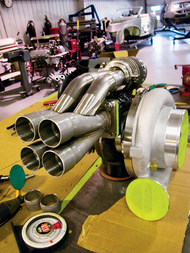

Goat Blower is offline
Old 03-12-2007   #447
Re: Finally getting stuff done on our cars
There is another way.
I thought of that as well. Unfortunately, that would defeat the purpse of keeping the runners separated.
Matt D. is offline
Old 03-12-2007   #448
Not really unless you're running real low boost.
