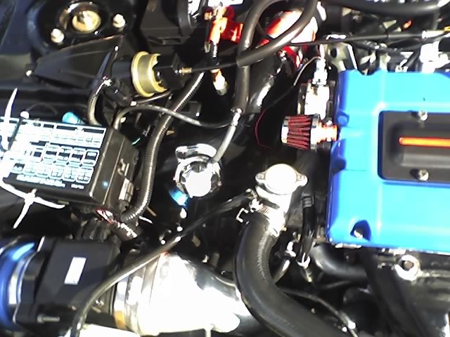

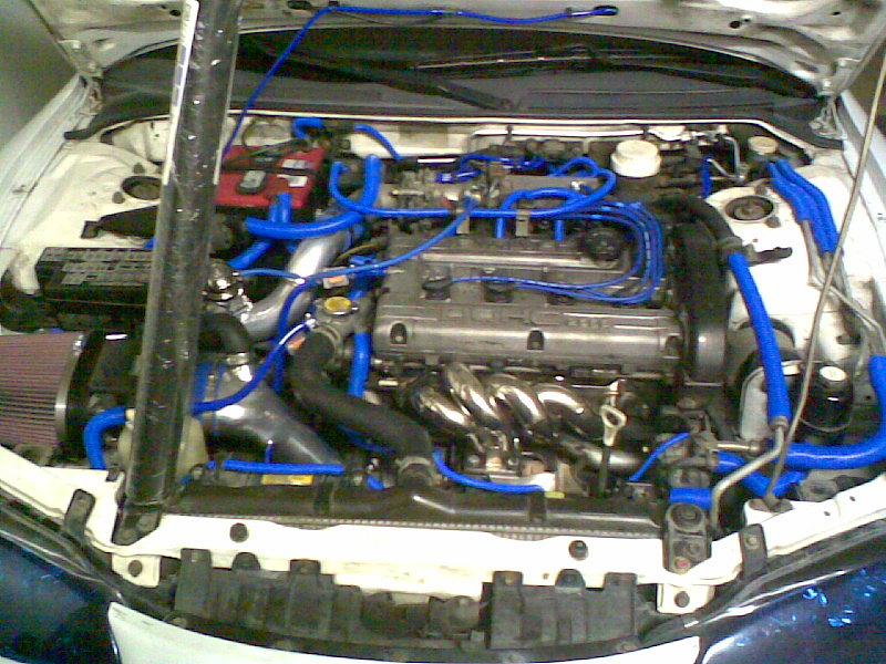

Well I just re-read this thread twice and I don't think I've learned so much at one time before! I vote this most informative thread on style for quite a while. I would like to clear a few things up for other newbs including myself in this situation.
The first pic is of somebody with just a filter on their vc. This is bad because it allows air to get sucked back into the vc.
The second pic is a setup with a simple catchcan/filter that goes on the line from the vc to the intake.
My understanding of the Krank Vents is that one goes on by your pcv valve and acts as a backup making sure no air gets into the vc, and the other goes on a line from the vc to the intake sucking some air out but again not letting air back in. You would also want to use a catchcan/filter on the line going from your vc to your intake.
I'd appreciate it if somebody could edit my post and correct anything that's incorrect. It may be a little late for this post, but I'd like to think I'm helping out some future newbs we might direct to this thread.

Holy jebus, look at all those blue lines. LOL
yea i searched for like 15 pages after I saw that because it's kinda hard to see and the blue just hurts my head. Sadly, that's the only car in the first 15 or so pages of tuners that has that little filter on it. 90% of the people just run a line from the vc to the intake. I'm doing this right now, but after reading all this I'm just waiting for a solid conclusion to what I should do.
