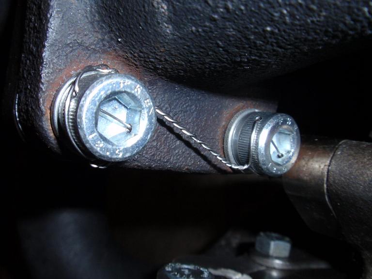

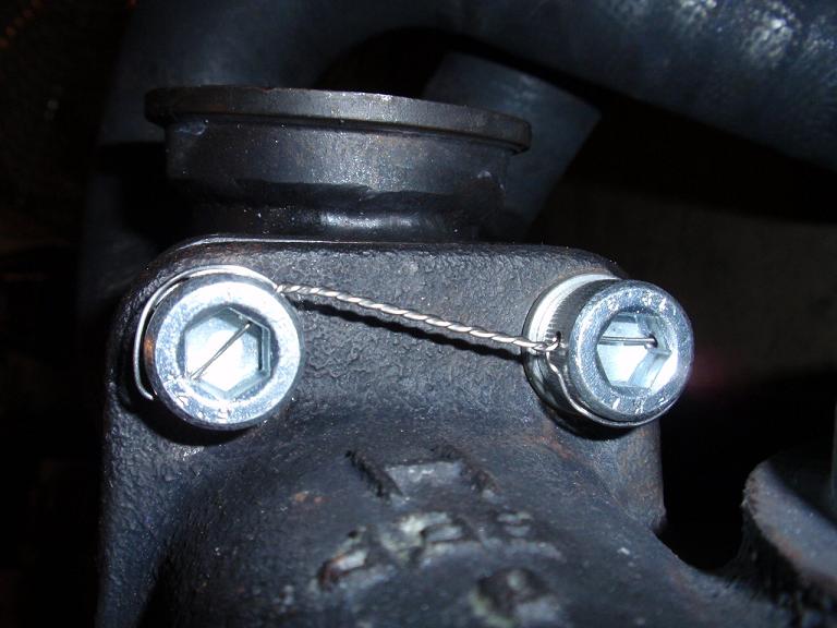

I've been having issues with the stupid turbo bolts constantly backing out. I think I have finally fixed that issue, see the pictures below
Nice bolt setup Brandon!

Haha thats awsome! Very creative!

Nice safety wire

Heh yea I have a whole spare head just sitting in my garage so I was gonna steal the bolt out of it. You're welcome to any parts of it you need, its doing nothing for me Nice safety wire job!

If I'm not mistaken that safety wire is an old military trick right?
Old 06-14-2009   #108
Re: Over revving issue
Yeah the military is where I originally learned to do it. It's pretty common practice in the air wing. Also in the nuclear field, we have to safety wire or loctite everything that will ever travel anywhere near the core. So I've done my fair share of safety wiring for the past 7 years. It's now just finally found it's way onto my car
