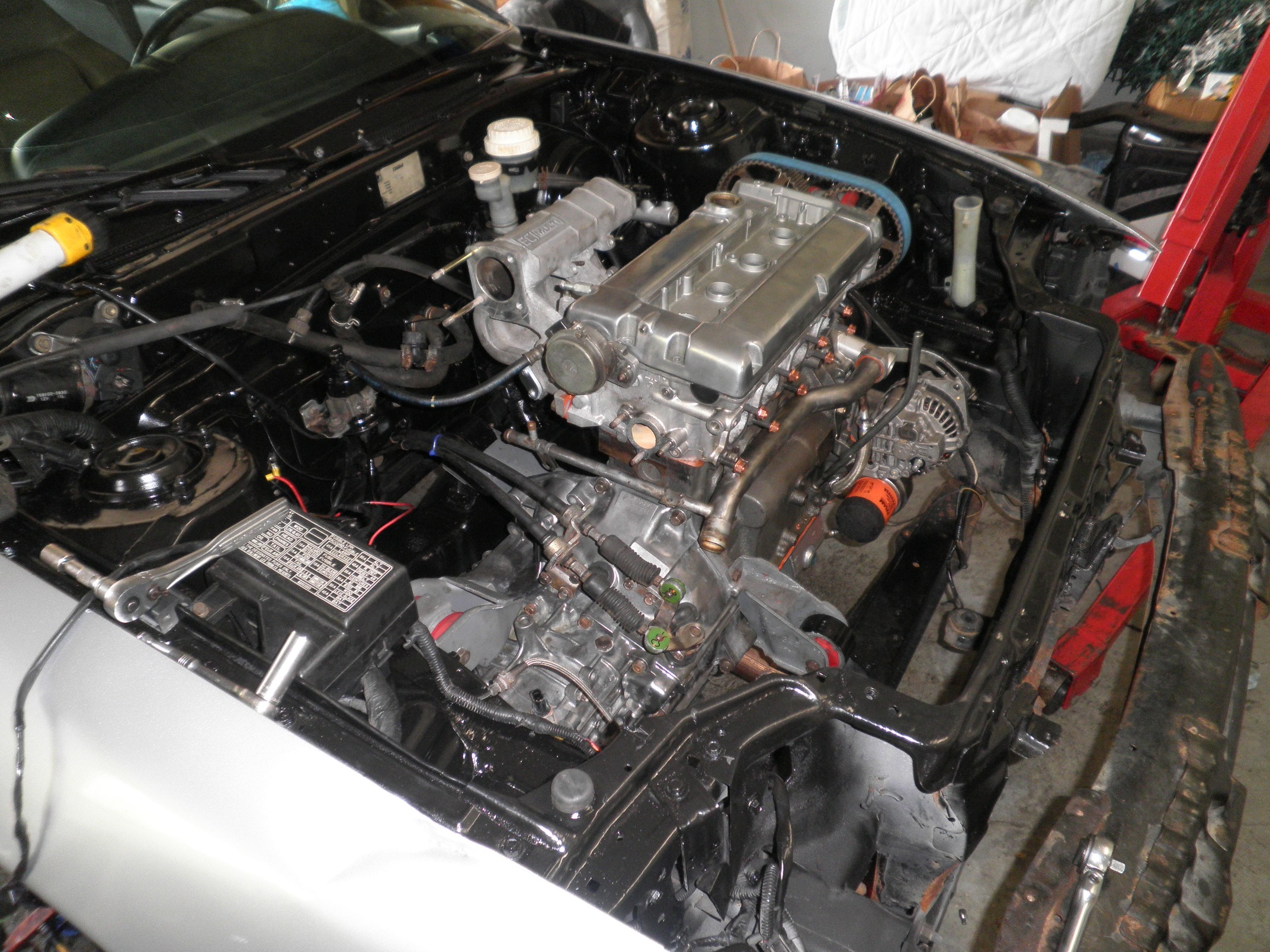

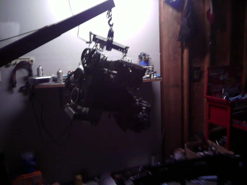

Re: 1992 Eagle Talon TSI Project
Sorry for the shitty pics, ill take better ones tomorrow with an actual camera. These really dont do it justice.
Thanks to Tehehodi and Lingling for helping out lining up the mounts.
Shes getting there.

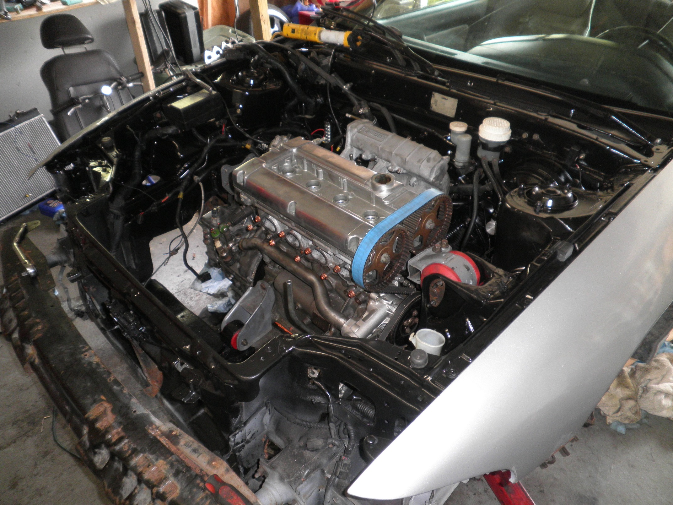

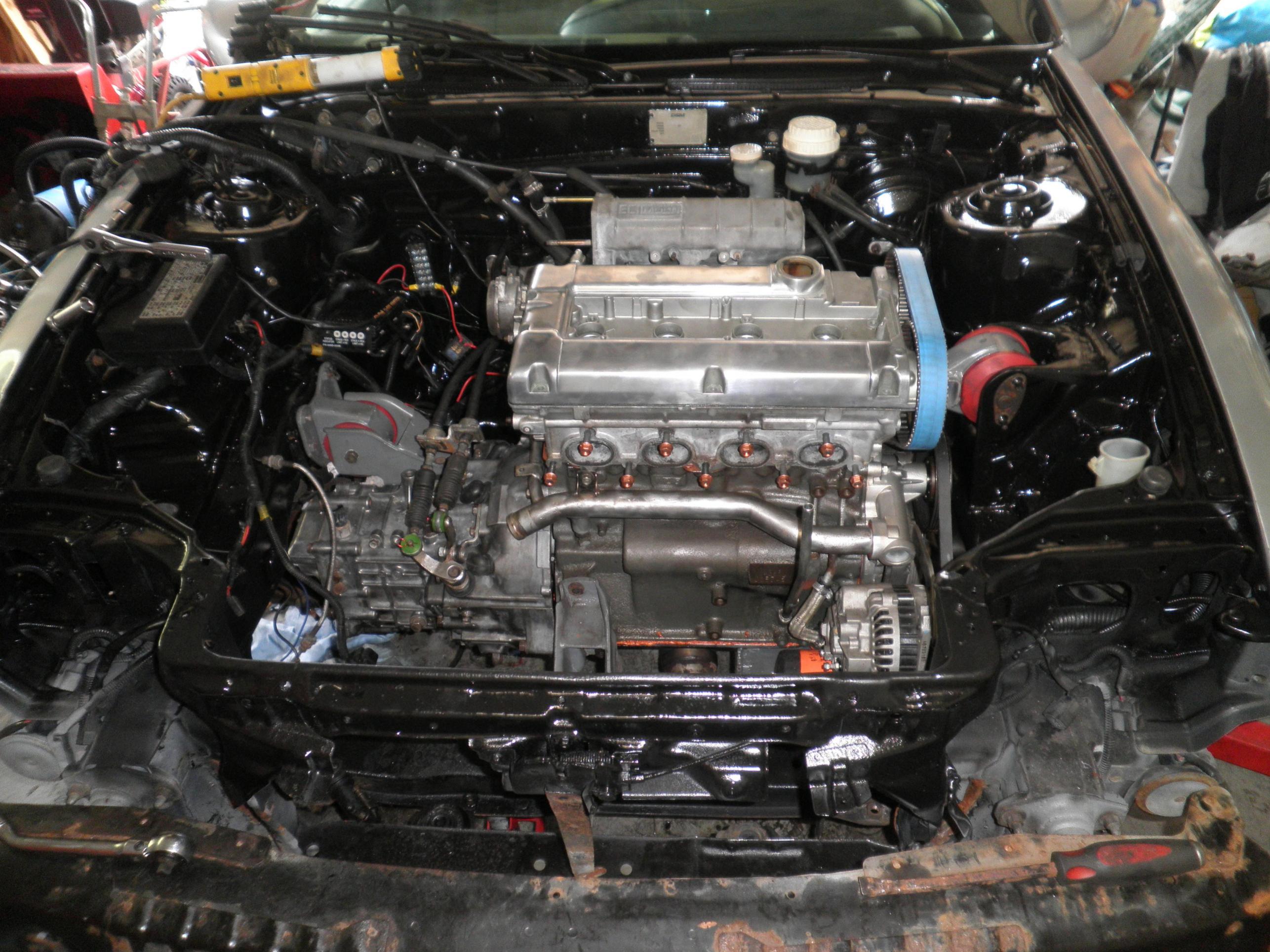

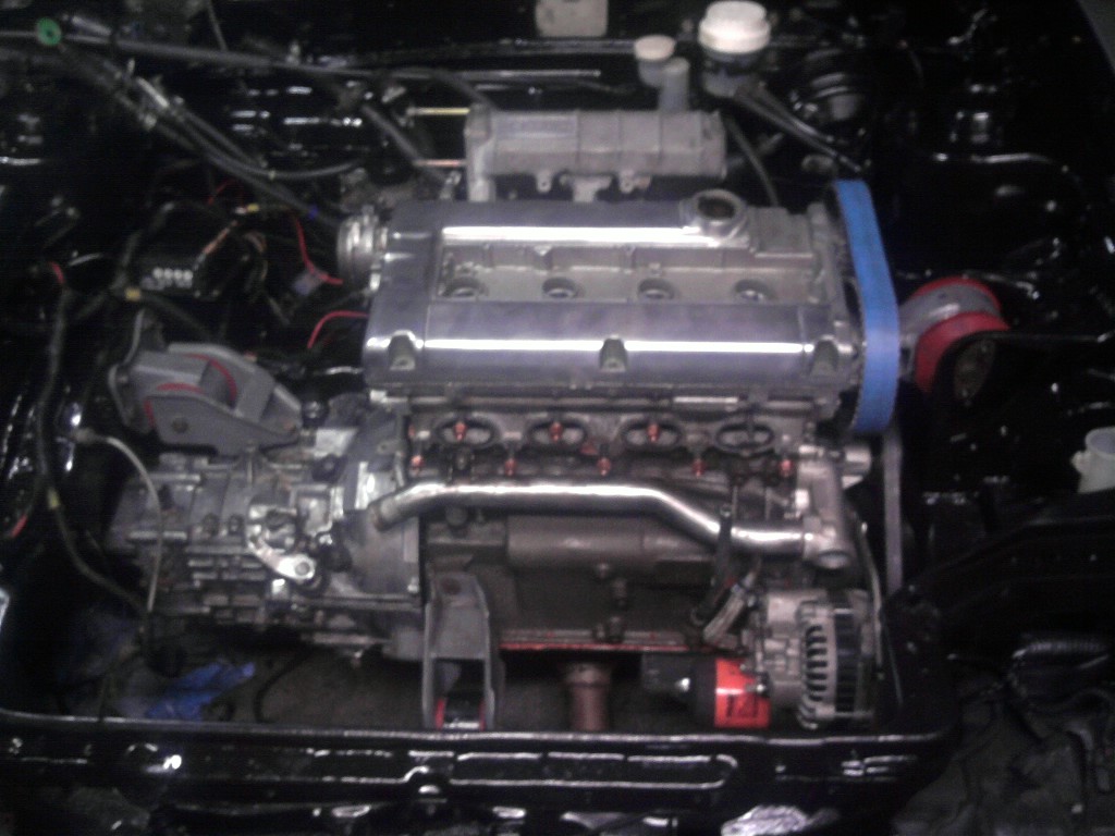

Heres some better quality pictures with the new camera i just got.
Also just purchased dual piston calipers from Oreillys in brooklyn center, thank you Craig.
