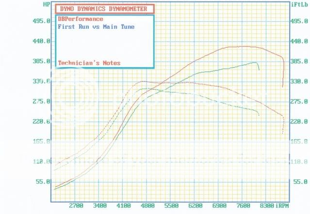

Haz fuel? Ron did a half-dozen pulls on his dyno this afternoon and the new pump looked good to him. He added some fuel up-top and the AFRs responded as they should.
He is suggesting that my motor is burning oil because my catch can arrangement doesn't breath well enough (the motor is tight or needs more airflow). I'm going to try changing that up as he suggested.
I'll go back in a couple weeks and we'll try to turn up the wick. 437/366 on his dyno as it sits.

437whp at ....less than 23psi? Holy eff that is awesome!
Yeah, it spiked to 25.4. I normally wouldn't be happy with how that boost curve looks but the car hasn't really been tuned. Spool is sad but mivec hasn't been touched for the cams.

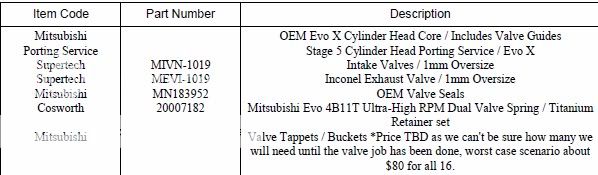

I dropped Grimmspeed a line about their air/oil separator setup for Subarus. I'm going to see if I can test one on my Evo. It seems more elegant than catch cans.

Mike, Take this for what it is worth, avoid that grimspeed setup like the plague, ask "Solid" over on mnautox.com how he feels about this separator setup.(It did not end good for his engine.) If I were you Id be all over a kracka's vent setup with some catch cans..

To be fair he had it plumbed all wrong, there was no way for the crankcase pressure to be relieved, regardless if he was at fault or if that's how Grimmspeed told him to install it. The guy that designed it had one on his Evo 8/9 and showed it to Scheides and myself at the spring dyno day, I'm fairly confident that he had one hose off it plumbed into a catch can with a breather. It is an excellent idea for easily adding a catch can setup when applied correctly.

Shane and Mara have one of those Grimmspeed oil-air seperator/oil caps on thier Evo. Just see how he has his plumbed, they look great in concept.
