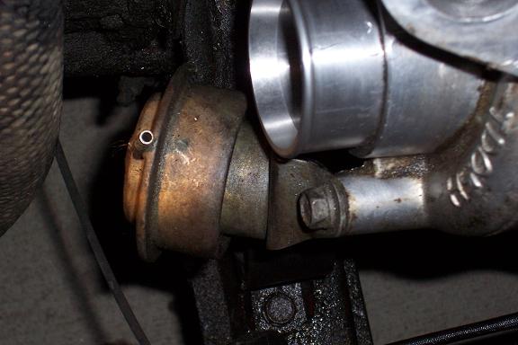

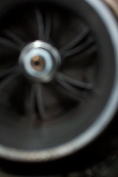

I want to buy an EvoIII 16G but this guy doesnt know what one it is cuz it just came on his car. Can you tell by these pics?

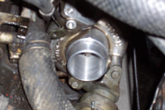

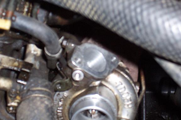

More...

HAHA I didnt even know they were that big. WOW. They are resized now. Also It has a 2 fin piston doesnt that make it a 16G?

Two fins is usually at least a 16G.
If you can get to the turbine outlet the EVO is 2.5 inches where the big 16G is 2 inches. That will make it sure as to which one you have.

There is a 3-digit number stamped on compressor housing, on the opposite side of the TDO5H stamp that designates what it is. After the 49178-0 code is stamp.
420 - Big 16G
520 - Small 16G
1470 - Evo III 16G
google this & you'll find some more info
