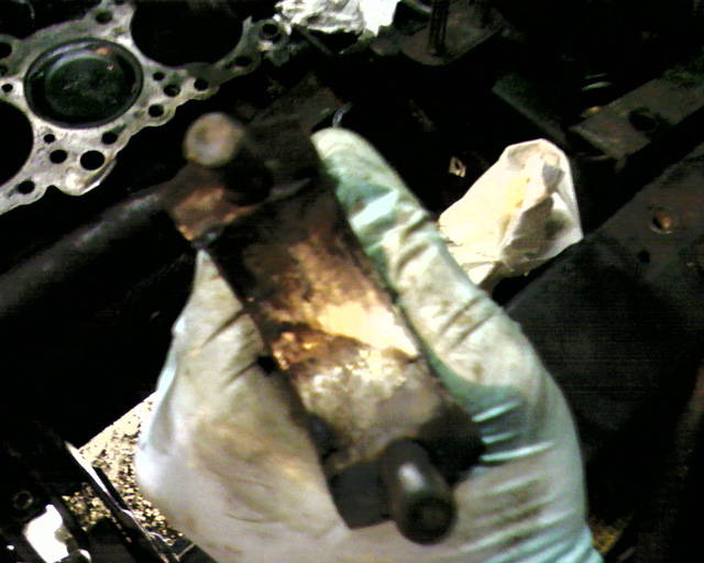

Heres a pic i took with my phone, I'm having a hard time uploading them all together so i have to go one by one.

pic 2, this is the other half of the bearing

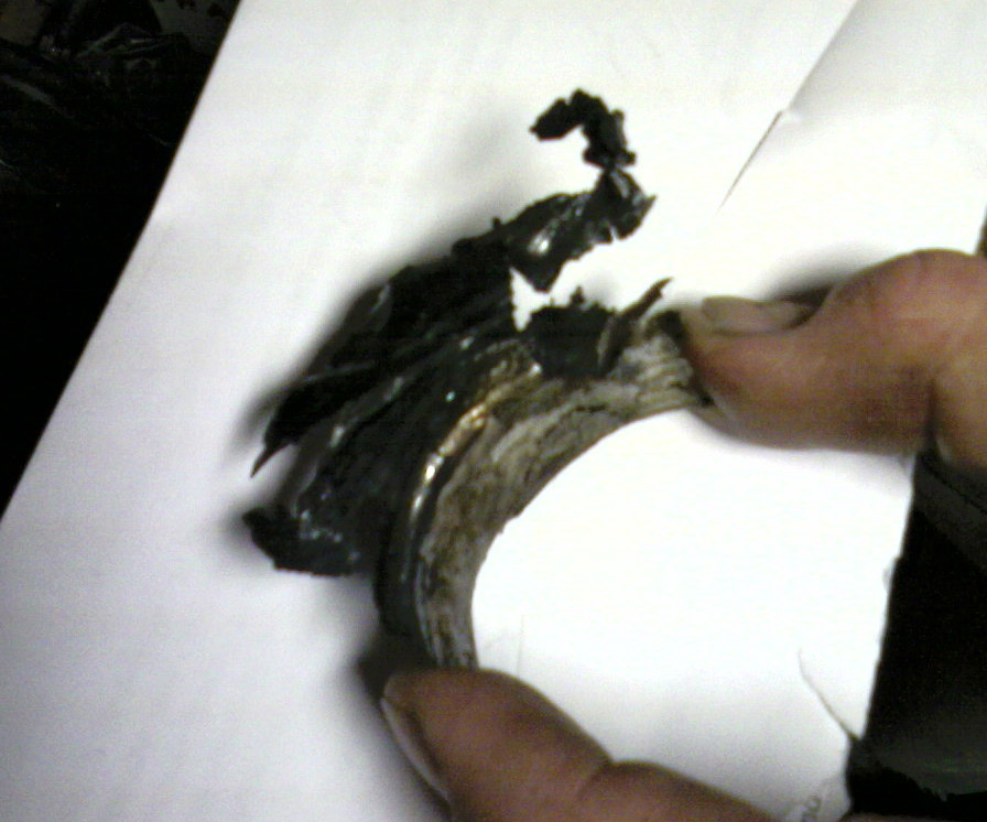

pic three

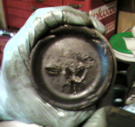

this was a pic of the top of the same piston that had the shredded bearing, the thing is that there was no broken valves, but you can clearly see that its a broken off valve that hit it.
another strange thing, none of the valves were visibly bent from this cylinder, its almost as if this piston was reused on a previous rebuild, could the car even run correctly (for a few thousand miles) if that were the case?
