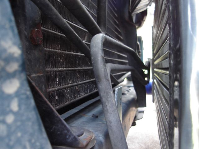

What is this line? I want to take it off so my intercooler will fit better. Can I remove it?
Heres a side view

Are you pointing at the metal lines? If so, thats for cooling the power steering fluid.
2nd pic isn't loading up totally for me.
I had plenty of room to fit my FMIC with those lines still on there. If you need some pics, lmk.

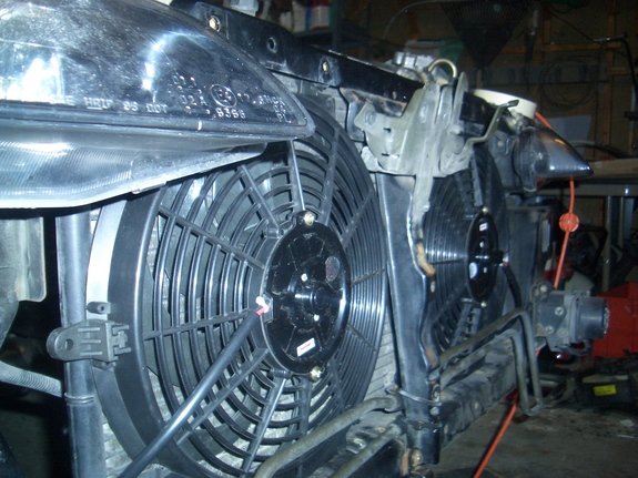

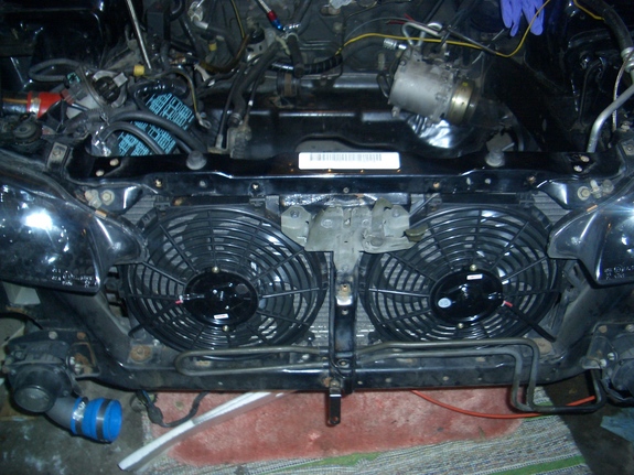

Take the bolt off the bottom of the radiator support support(thing that goes up and down) and put it behind it and bend the lines slightly so they dont rub up against it. Thats what I did with mine. Check out my pics...

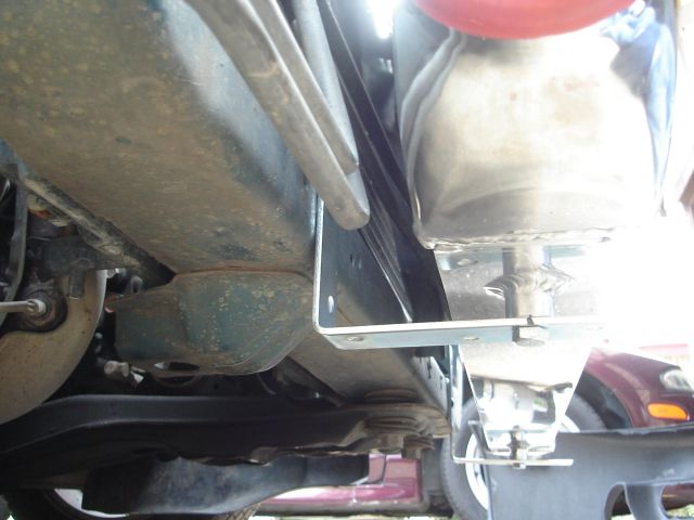

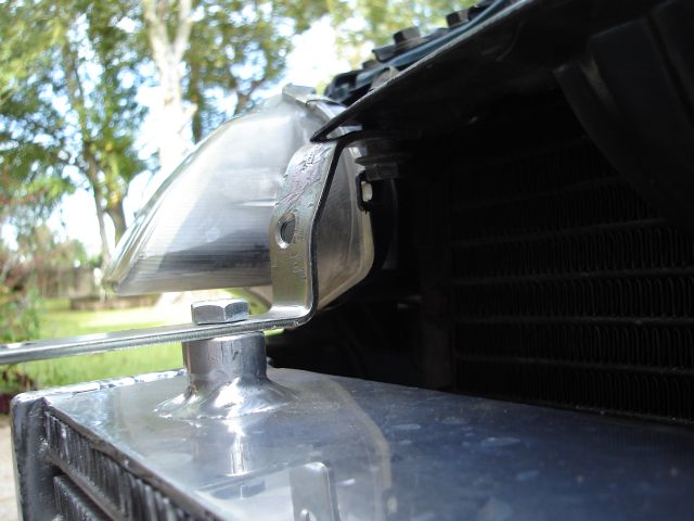

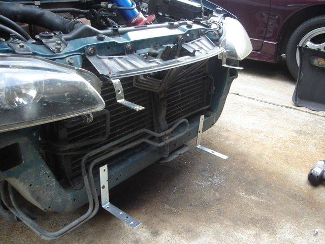

I just fabbed up some brackets with some parts from Lowes. Found them in the door hinge section I believe. Costed under $10.

Actaully I just realized that I didnt have to bend it at all. I bent the line when I put my fans in.

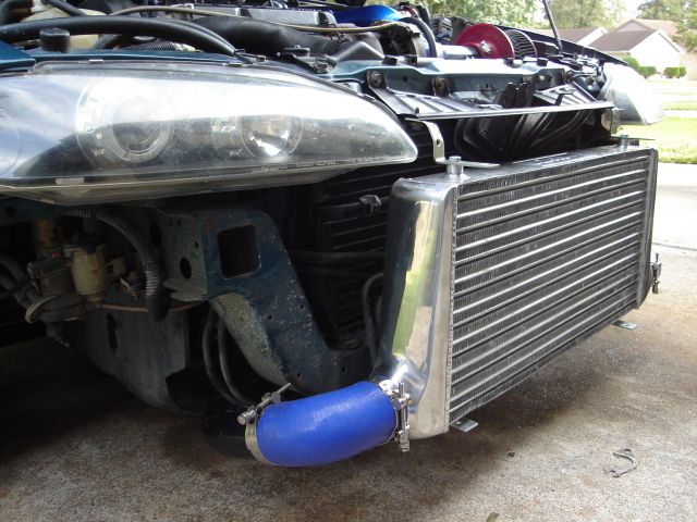

Mine actually lined up perfect fairly easily. The first pic shows what I did for mounting the intercooler. It actually holds very sturdy and doesn't move at all. The second and third pics show how it bolts the brackets onto the intercooler. Your intercooler mounting holes may vary from mine so it may not work the same.
File Type: jpg FMIC - Mounted on Car (Lower Bracket).jpg (55.3 KB, 284 views)
