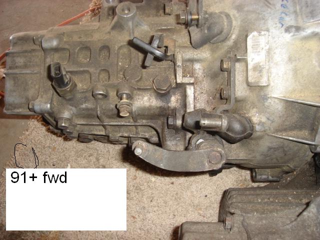

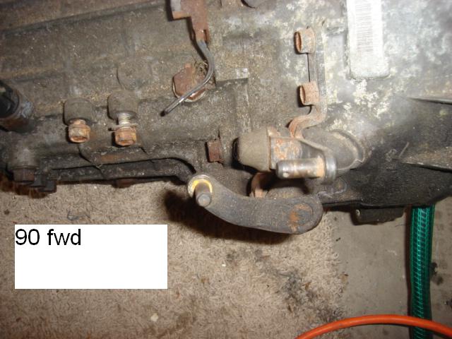

Re: fwd 90-91 tranny differences
The shifters are set up different. you'll need the shifter assemble and cables to go with the tranny. 90 shifter and cables or 91+ shifter and cables. there are a few differences internaly but they dont really matter if you just droping in the tranny. the spline count and axil size changes in 92.5
heres some pics of the difference in the shift leavers
The internals are different in the 1990, and to use a 1990 tranny in a 91+ car you need the shifter cables, shift lever, and shifter lever base. Or you can cut and weld the shifter arms on the tranny if you're ghetto.
