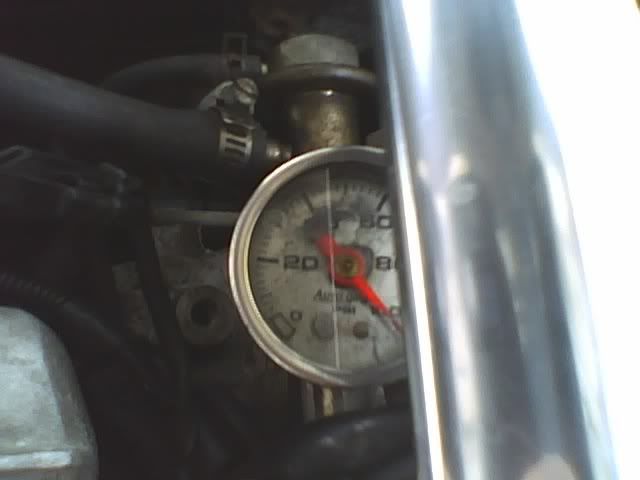

Yep, PLX. Should I put in my AEM or is it just as good? & does anyone local sell the fuel pressure gauge, because the old one is stuck or the regulator is really bad! 100+ psi. I think Ill get the DSM Link soon ..... That should fix it , correct? The stutter is something to do with the CAS &/or the AFC II conflicting possibly or with ECU?

The PLX is better than the AEM, keep it. Those guages are everywhere, probably even Checker or Advance. If not, MAS will have them.
