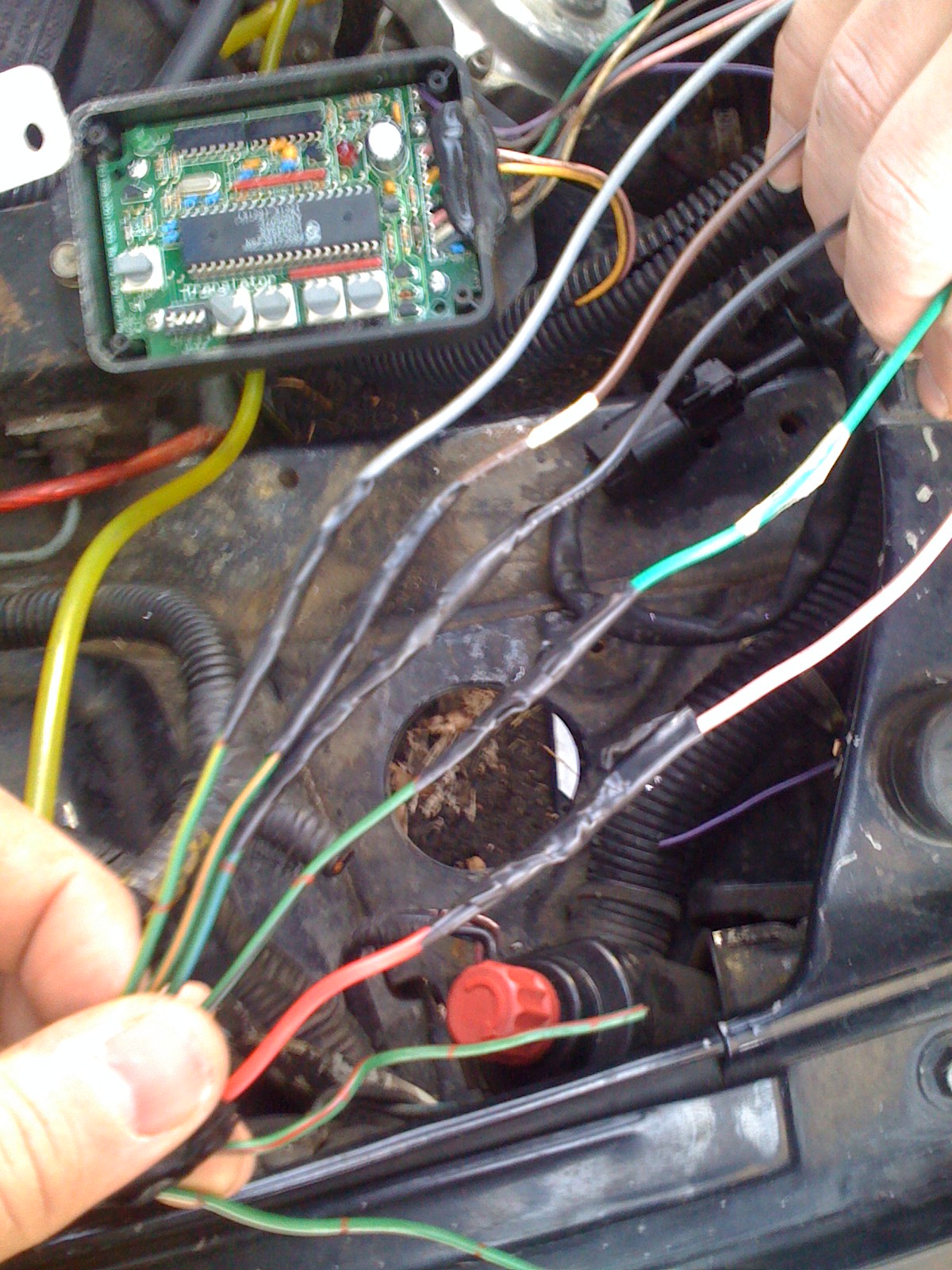

Ok, all of the DSMs I have use MAP sensors or 2G Mas sensors, so I cant really "compare" to find out what is right.
is this wired correctly?
LED's do not turn on.

ecu pin maft wire cut side engine
8 brown ecu side yellow GM wire
10 green pink GM wire
16 grey black GM wire
21 white (90 only) rpm
109 white (91+) rpm
102 pink
101 black
mas wiring dsm mas plug
yellow gm plug green/orange
pink gm plug green/yellow
black gm plug green/blue

Thats great, if I was wiring it up in the cab, but the car is set up to have the box next to the GM MAF....
So, does anyone know how to do this?
Thanks

Is this correct?
ECU wires ----------------MAFT wires
Green with yellow stripe =>Grey
Green with orange stripe =>Brown
Green with blue stripe =>Black
Green with black stripe =>Green
RED =>Pink

can someone with a gm maf ( hardwired or not) just take a close up picture? I actually have looked on maftpro's website, still need help

Are you just wiring it up to the stock maf plug?

No plugs, just cut wires. I need to know if I currently have it wires up priperly
