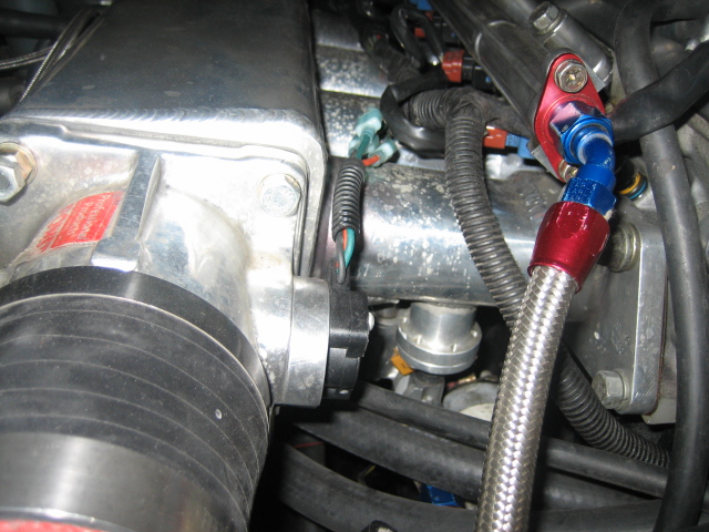

Old 05-01-2008   #4
Re: Adding a second bank of injectors

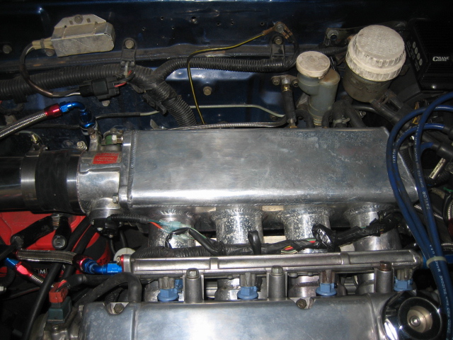

What throttle body is yours flanged for? I forgot mine's set up for a Ford style throttle body and I don't want to change back to a stocker quite yet. Here's some pics.

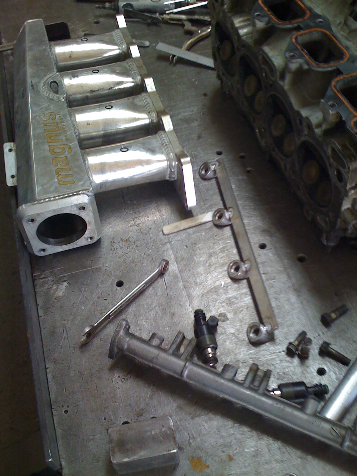

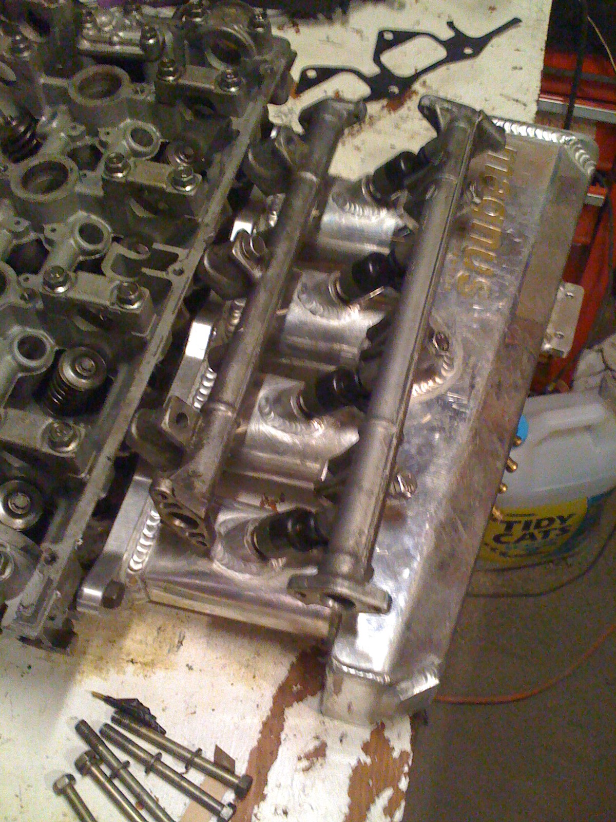

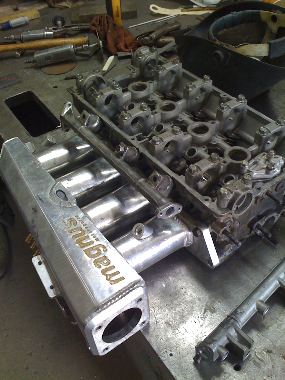

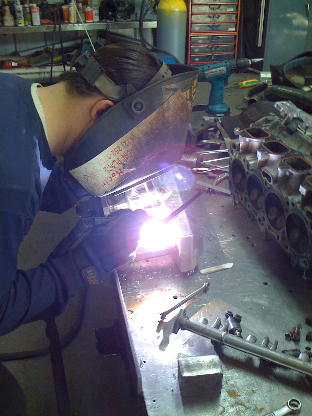

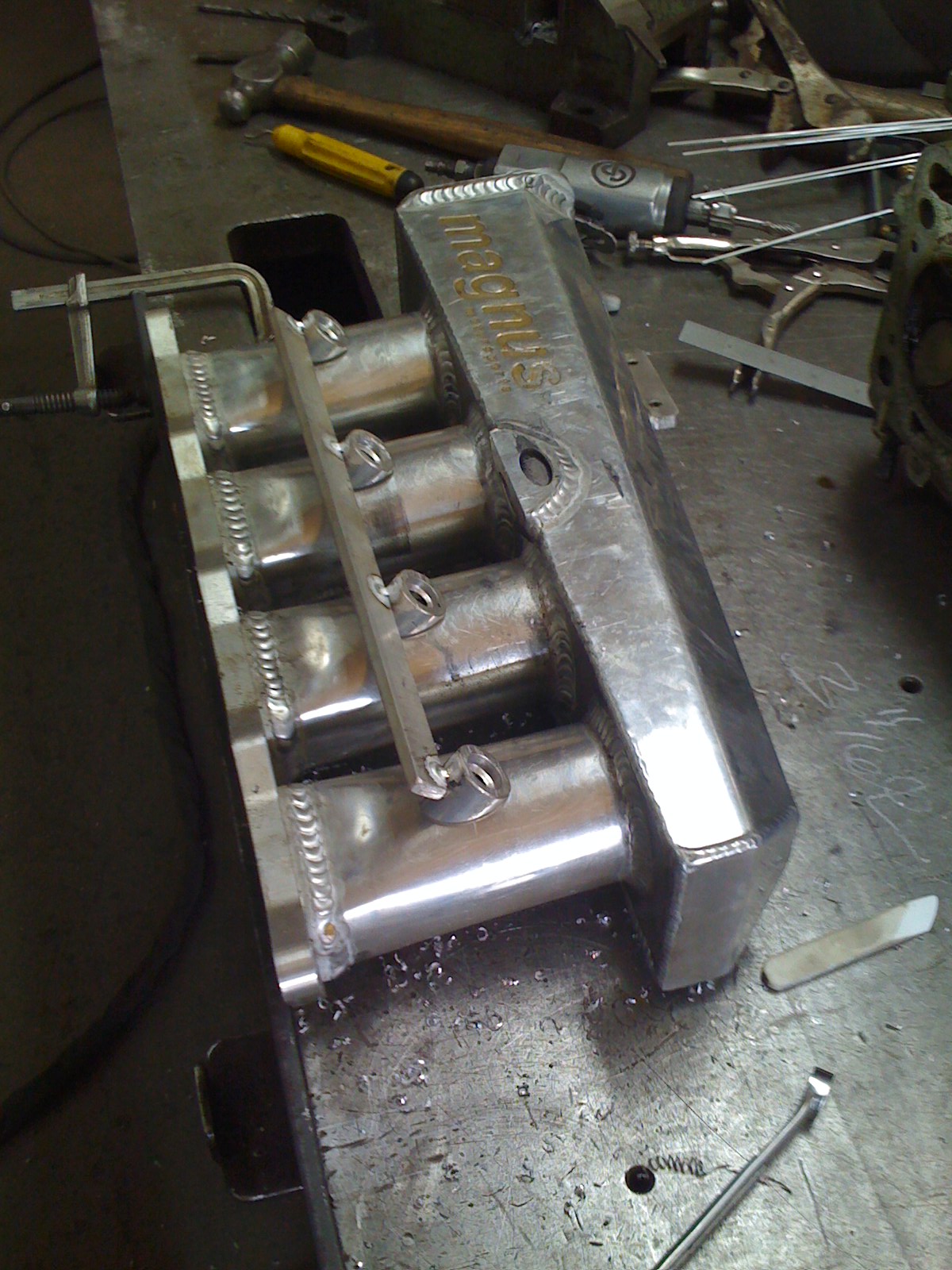

We brought the manifold to M&L welding in saint cloud, (1st exit into saint cloud, down a mile, on the right) and after some sweet talking, we got them to fab up the bungs and rail mount, and weld it all up.
Here are the pictures, they were very professional and charged a hefty (but fair) $190.
Now that the easy part is done, we gotta start figuring out how MegaSquirt is gonna control the 8 injectors!
