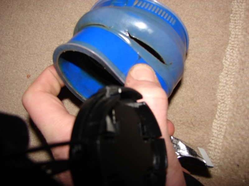

Found my boost leak
Found a leak... new parts on its way

Re: Found my boost leak
lol.. no crappy coupler
How old is that coupler? It looks pretty well used.
It that coupler even reinforced for boost?
Straight Silicone couplers FTL. I learned the hard way a long time back as well. Now you know! Go get some good couplers now!
It's what scheides left on the car... not his fault I didn't inspect them when I got it... & I have learned so much since I first bought it. Got new ones on the way from MAP!
Hell I probably have some assorted 2.5" ones sitting around you coulda used. Oh well.
Damn.. Oh well.. they were 2.5" to 3" already paid for...but thanks for the offer!
Ya, that's what came with that FMIC kit that I got after selling my buschur core/piping kit. Sorry man, if I would have known I wouldn't have left them on there They came attached to the pipes on either side (if I remember correctly?)...I hardly remember touching them.
What do you mean straight silicon? Straight like no reinforcements, or no "flex bubble" or whatever they're called?
I meant straight as just in just straight silicone with no reinforcement in them. I've ran them in the past on my old 2G, and blew them all out.
"Hump" hose works fine as long as it is reinforced. I've use those in the past.
