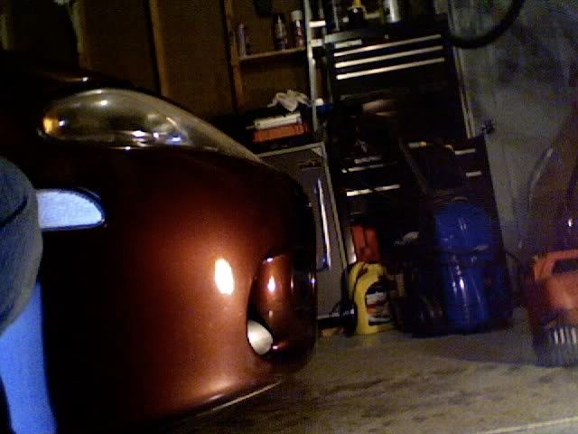

I made a bracket that comes out the fog light hole. I think it looked great!

mr.98gsx that looks good. What did you make the bracket with and attach the bracket too?

I took out my crash support when I put on my fmic. So i just got a small 1/8'' by 2'' piece of metal and bent it kinda in the shape of a "J" but with sharp corners. I got some smaller pieces i used to make a little braket thing for the plate to attach to. I should have made a write-up, but I didn't lol. Basically, just get some metal and play around...That's what I did.
My crash support is out too.. What was it you attached the bracket to? the bumper cover or a solid mount behind it?

I bolted it to the big black bracket thing that the crash support mounted to. It's pretty much right behind where the fog light is. I'd take more pics for you, but I sold my dsm a year ago
