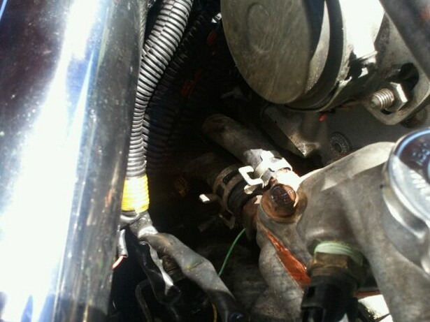

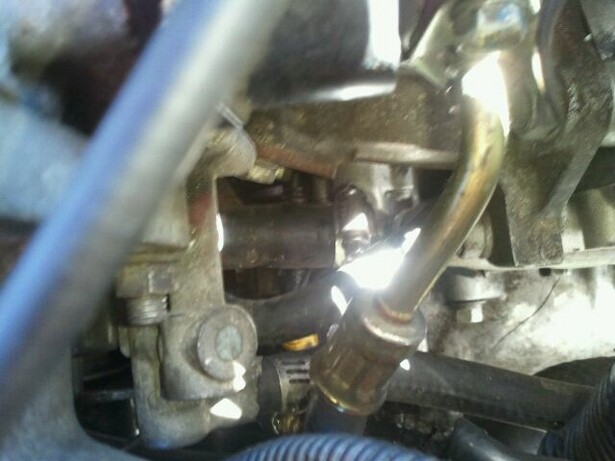

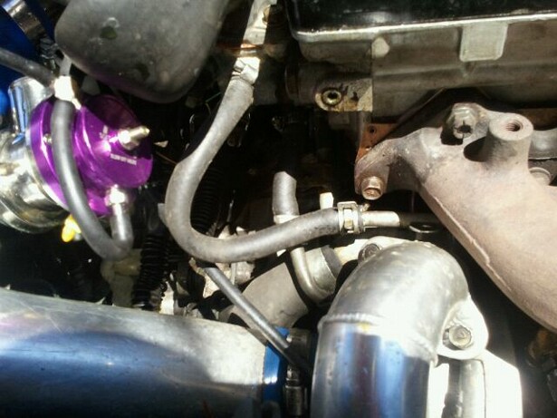

So just finished my 6 bolt swap on my 1999 gst. Got moter from chang's, starts idles perfect! But took for a couple test drives get back and see the top(upper radiator hose) was almost rock hard! Didnt suspect much because i have herd Dsm's have a coolent presure of 13psi. So i removed thermostat to keep cooler anyway. Went for a drive today and on the hiway the Upper radiator hose actually blew off the radiator. I tryed switching radiator cap flushed system refilled with new fluids. So my question is, Am i sappose to have that much preasure? Is my head gasket pushing coolent?(not boosting over 5 psi) Or do i have blockage issue or did i reverse some coolent line? i'll try to get some pics up of my coolent lines etc.. Thanks guys

Your radiator cap is preventing the pressure from being released into the overflow tank. Get a new radiator cap and make sure the line running from the neck to the overflow isn't plugged up.

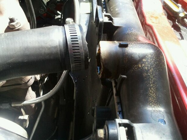

Your hose outlet on the radiator looks broken. That could be one of the reasons it popped off.
Also, get rid of those oem squeeze clamps on all the small lines. Those things are notorious for leaking on old DSMs

okay got a new cap and radioter, i'll let ya know what happens, thanks
